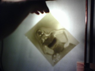

Here's the results of the first try with Rollo. I'm pleased with the stain. Should increase a bit with as it dries. the bad snap shows more contrast than there is(the eyes aren't that dark), i'm mostly looking at the stain, which is very PMKish. Yippee! I'm gonna print one of these tonight.
Looking at the image here, I had to ask...
Is that a photograph of "She Who Must Be Obeyed"?:smile:
