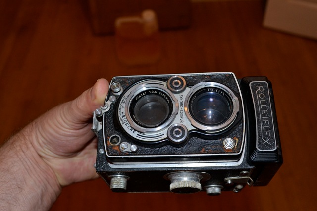

In the coming week I will be getting my first Rollieflex. In researching the serial number (124****) I find that is a K4, but instead of the 3.5 Tessar, it has a 3.5 Planar. I cannot find any information suggesting that this camera was ever supplied with a Planar and am wondering if anyone can clear this up for me. The camera is from an estate and though I have agreed on a price, that price was based upon the fairly rough cosmetics and the researched value for a K4 with the standard Tessar. I don't want to take advantage of this situation to "steal" a camera that may very well be worth far more than I have offered, so I am appealing to the vast knowledge base out there for advice.

Are you sure about the serial #? The one you quoted would be for an Automat MX (K.4A) which came with a Jena or Opton Tessar, or a Xenar lens.
Does this camera have a meter? Starting with the 3.5E (K.4C) serial # 1,740,xxx, Rollei fitted them with either a 3.5 Planar or Xenotar.
I suppose it's possible that the taking lens was replaced, or maybe just the front ring. If this was the case, I'd probably steer clear of it. Also, coming from an estate sale it's likely to need servicing if it hasn't been used in awhile. Unless you're getting a screaming deal on this one, it might be less trouble to pick up a recently-serviced Rollei from Igor 's Camera or Harry Fleenor.

It does not have a light meter, and the viewfinder is screwed into place, not removable like the 3 2.8Fs that compromised the rest of the collection. The price to me, at this point is $250, so I'm going to go ahead and stick with it. I have handled the camera, and the only issue I can see is that the leather is torn in a few spots, and engaging the 1/500 speed takes a little effort. I knew the former owner and am certain that it was well maintained. I do plan on having a CLA, just for good measure.

Welp. that's an MX alright. Body, at least. The small focus knob, the short lever above the flash sync socket, the style of the strap lugs, etc.
And yep, it says Planar.
I don't know exactly what to look for, but there are ways to tell how many elements are in a lens by the ways that reflections happen, the number, etc. Maybe someone can tell you.
The interesting thing for me is that a 3.5 Planar or Xenotar lens does fit a #00 shutter. And the front lens element is very close to the size of a Tessar/Xenar front element. On the 3.5 Es and Fs, the Bay II fitting was some sort of marketing BS move by Rollei, not a neccessary change because of the new lenses. If you look at a 3.5 E or F, you will see an extra black ring outside of the lens element filling in the extra space for the Bay II mount rather than a Bay I mount. There might need to be some widening, but a Planar will fit a Bay I camera. Some day I will mount a Planar onto a Minolta Autocord body with a Hasselblad NC-2 prism and I will have my perfect camera.
Anyway, either someone swapped the front ID plate on the lens, or you have a franken-rollei.
A note and photo to Harry Fleenor might be in order. I seriously doubt that this a collector item worth lots more than $250. More a curiosity piece worth whatever pleasure you get from shooting with it.
By the way, it is not recommended to go to 1/500 second with a cocked shutter on this early Synchro-Compur. These shutters still used a tensioning spring booster for 1/500, and trying to engage that with a cocked shutter is extremely difficult and can damage the shutter.
Thank you for your reply, it has been helpful. I plan on sending the camera to Harry Fleenor, after I put a roll or two through it, of course. I'm just happy to be put at ease about the price.
be patient with me, but it hurts me deep into the stomach and spine to hear or read' Rollie. It's a Rollei for heaven's sake; This s far worse than saying Hassy, which is pretty bad in itself;Sorry but there is a limit to cultural diversity.Enjoy your Rollei with or without a Tessar.I'm such a nitpick,I know;forgive me.
That is correct. BUT the bay II works a lot easier, less prone to twist.

Seems to me there should be a Planar serial number on that ring around the lens, and the serial number should be researchable for date of manufacture. Also Rollei didn't start using the planar until after they learned to coat lenses. The coating on the front of a Planar should be yellowish in color. If the lens isn't coated it must me something else.

So here's the scoop. I picked up the camera this morning and mentioned that the lens was not standard. I was told by the widow, who was selling the cameras, that she has several Rolleis that she took to a technician to have Diana lenses put in them, and that after the first, he insisted that she bring another camera that could benefit from having a Planar put into it. She said that he cringed every time he saw her coming. She made some amazing photos with that Rollei/Diana hybrid though, and a good bit of money too. I will get the original Tessar that the camera came with in a few days. I think I'll leave it like it is though
