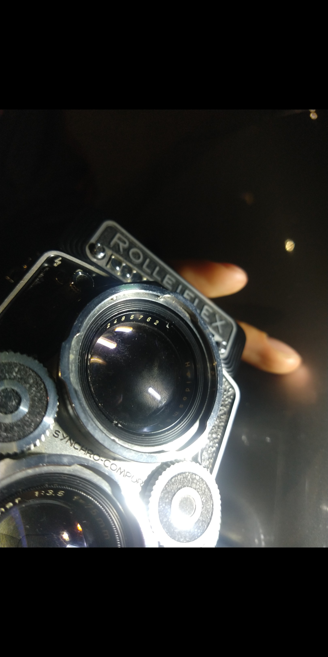

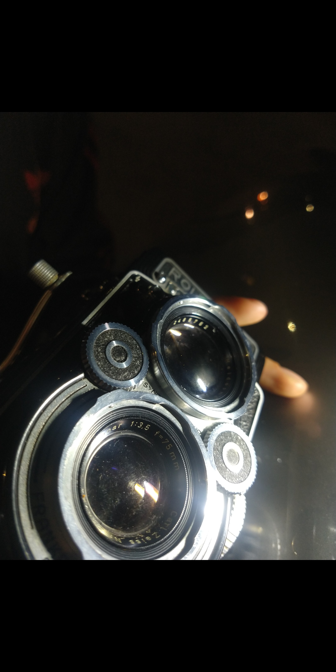

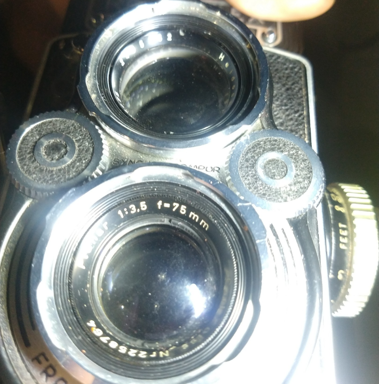

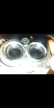

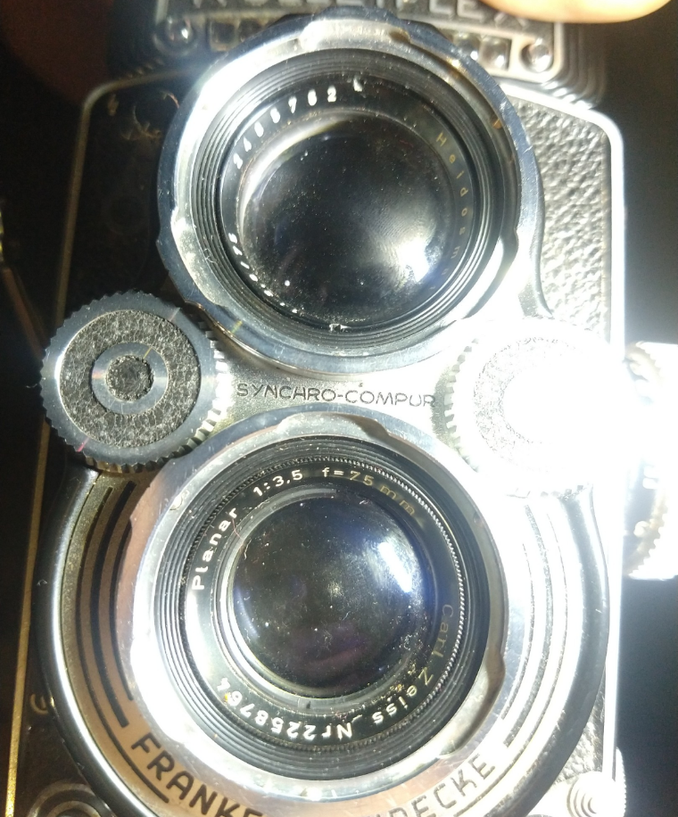

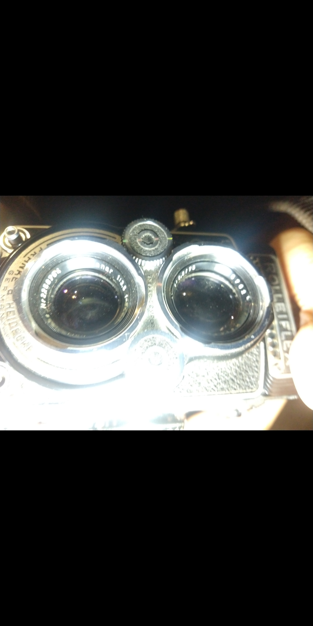

Hello,
I would love your help on this One.
I want to buy a Rolleiflex. Not to profit from it, or sell it again. I want to buy one that can last many many years, to satisfy my photographic needs!
Tonight, i saw and hold a rollieflex for the first time. Beautiful. Amazing. The model, 3.5F. the price, 200€. Looked beautiful!
The problem.. the lens!
Questions:
- What should i look for on a rollieflex when buying one from a random seller. I want to BE prepared next time.
- When is the lens condition good enough, that can be fixable. When does it stop being fixable? When is it dead? I don't mind sending it for repair.

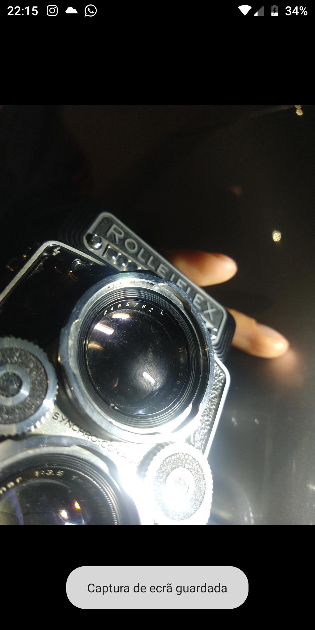

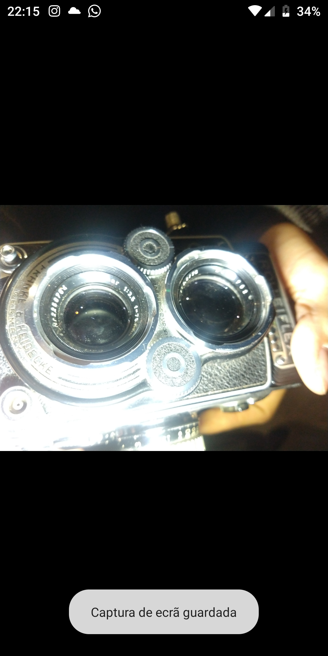

- I will post pics of what made me not buy this câmera. It was the lens. It scared me. It made me think it could be unreparable. Was i right not to buy it? The Shutter was not working either and the 0 count didn't move.
I ended up not buying it. For 200€! I didn't have the guts. It scared me. I wanna be prepared next time i go hunting for a Rolleiflex. That's why i need you. Here are the horror pics.
Maybe it wasn't that bad. But, i have 0 experience. Was i right not to buy it?
Screenshot_20201119-221545.png Screenshot_20201119-221511.png Screenshot_20201119-221519.png Screenshot_20201119-221525.png Screenshot_20201119-221539.png Screenshot_20201119-221559.png Screenshot_20201119-221611.png Screenshot_20201119-222457.png Screenshot_20201119-222551.png Screenshot_20201119-222640.png
Thank you

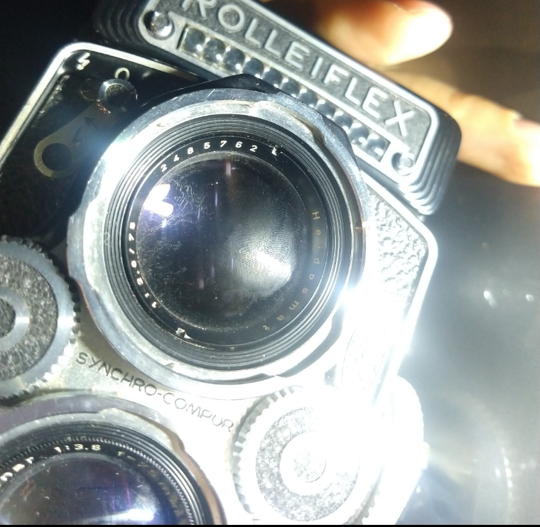

Hard to tell too much from your pictures here. The taking lens looks pretty heavily marked perhaps but still may well take great pictures.
You want to be able to fire it on 'B', keep the shutter open and open the back to see through and evaluate the taking lens clearly.
I can see you couldn't do that because the shutter isn't firing. No working shutter would be an immediate absolute no for me but I never repaired a Rolleiflex, only used them.
This should give you the idea of what's inside one - a lot of moving parts - best left to the experts and best not to take unnecessary risk in buying one perhaps.
https://i.ebayimg.com/images/g/0x0AAOSwkCZceGm5/s-l1600.jpg
They did make enough thank goodness that you have the luxury of choice when buying one. I would wait for one that looks reasonable and has some kind of provenance either directly from a dealer/repairer or from an owner who has some kind of service and usage history for it.
If you are committed, wait for a good one, better to get something with only minor TLC required rather than something with issues with the taking lens. Good luck, an excellent decision on your part already to get one. :smile:

Those webs, looking like Spider webs, were all Over around the lens, up to the center. It looked like tree Roots. Then there was, i Guess a fungus, right in the Middle of the taking lens.

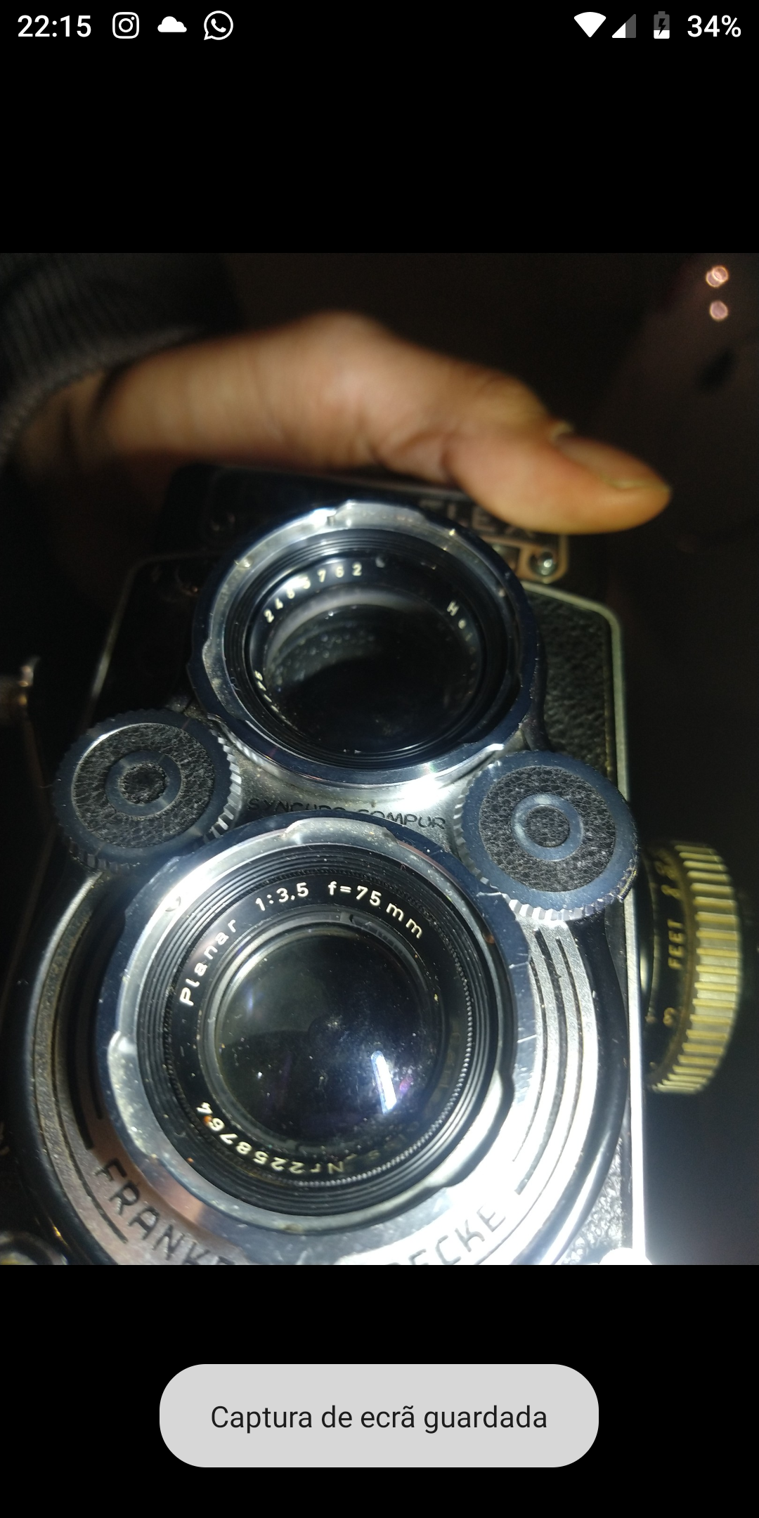

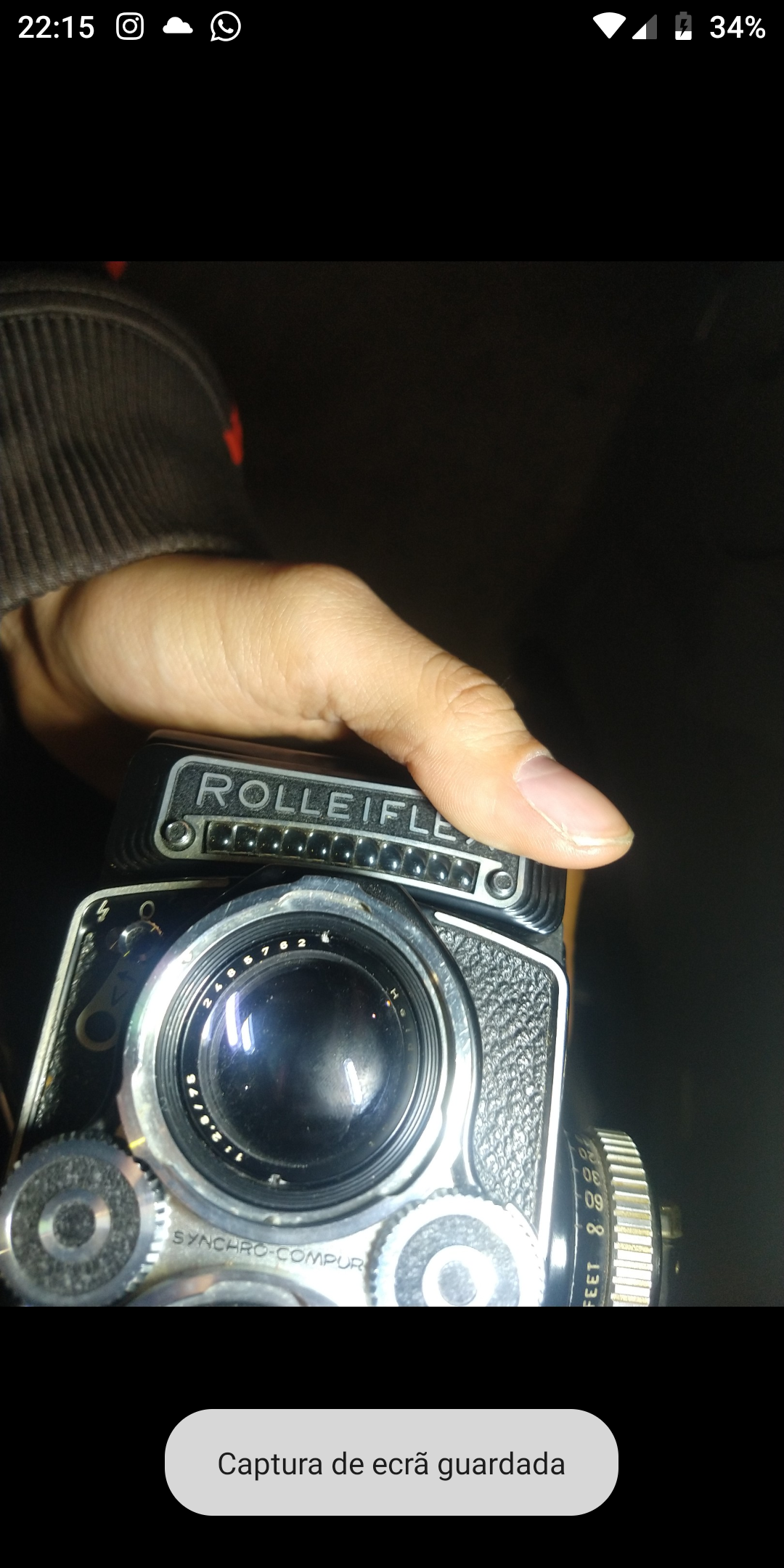

I think the viewing lens definitely has fungus. It is hard to tell about the taking lens. Fungus and a non-working shutter raise too many red flags for me. It is odd that you found a Rolleiflex with the distance scale marked in feet in Portugal. I suggest you keep looking for another example.
Thank you so much.
Could you guys tell me how much fungus is too much? Cause, when i see another One, i wanna know if i can clean it or not.
Yes, on the taking lens, there was One fungus right on the Middle. What you see on the viewing lens, its the same on the taking lens. Lots of webs, like Roots, going from the sides all way to the center. The photos could not capture it well. ONLy with a light pointing at the right angle.
Any. Sometimes the fungus will clean off other times it etches the glass. UV light kills fungus so sitting it in direct sunlight for a few days will kill it.
Scratches and other minor defects on the front of a lens will not affect picture quality but can cause flare/reduced contrast is strong side lighting.
The counter will not advance from 0 without film in the camera.
The Synchro Compur shutter will run about €105 - €125 for a CLA. The Synchro Compur service manual https://learncamerarepair.com/product.php?product=7&category=2&secondary=20 shows a CN-1110-025 shutter in this camera.
Its not a beginners shutter to learn on, about a 10 in difficulty on a scale of 1 to 10 with 10 being the most difficult.
Roleiflex TLR's are complicated but not a monster when one looks at the malfunctioning section and not trying to digest the whole camera at once. https://learncamerarepair.com/product.php?product=21&category=2&secondary=15
The camera will likely clean up to be a good working camera but will likely cost 2 to 3 times the purchase price to get it there. I would not pay more than €150 for a camera in this condition.

The longer the fungus has been there and been able to feed the more damage it has caused. The price seems ok, but it needs a good CLA to remove the fungus and the spores. I would think the whole camera should be taken apart and cleaned. If it has been in damp storage there might be corrosion in the shutter and the transport mechanism. If it's bad then spare parts are needed. It's a risky camera.

ANY fungus is too much fungus, IMO.It is a red flag that suggests the overall condition of the camera is going to be similarly poor. Keep shopping - its not a bargain.

You did well in not buying it. This is worth a symbolic amount at best. It would need expensive service for at least 200.

Any. In most cases fungus etches the glass. Open the shutter on B and look through the lens shining the light from your phone though it. A little haze will normally clean up. Also the taking lens is much more important to be clear than the viewing lens.

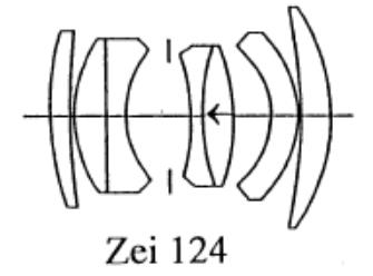

https://www.rolleiclub.com/cameras/tlr/info/all_TLR.shtml
Most cameras have a Tessar taking lens, The F has either a 'Planar or Xenontar.
Zei 041.jpeg Tessar; Zeiss Planar 7 glass.jpeg Planar. Schneider designs will be similar. I have no diagram for the Xenotar.

I believe this diagram for the Planar lens is for a different camera. Rolleiflex 2.8 models used five element lenses. This one shows seven elements and may be the Hasselblad version. The earlier 3.5 models also used a five element Planar lens. Then, sometime in the 1970s, it was switched to six elements. The performance of both was the same, despite the claims of the internet "experts."
You are correct that lens can have a lot of coating issues and other internal problems and still take perfectly good photographs. You may experience a bit more flare when the sun is in the view, but otherwise often the damage is essentially invisible.
