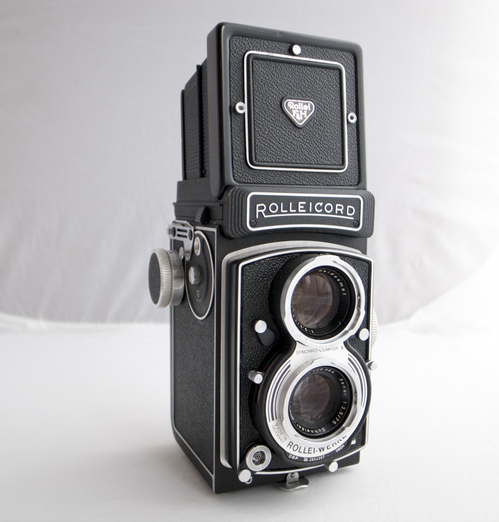

Hi,
this model is yours? :

Hi there, no not my model, dosent have the emblem on top of view finder, I think maybe a IIIc, not sure number in top of camera 919042

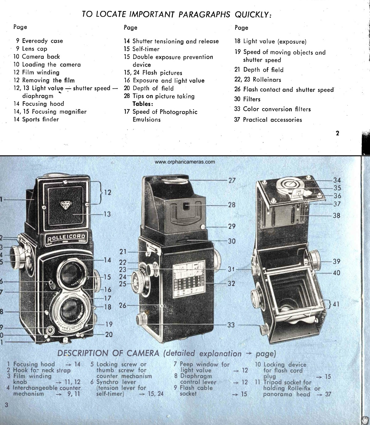

Can you find it ? :

The Rolleicord in the picture is a Rolleicord V, maybe a Va, no earlier. Focusing knob is on the opposite side.of the camera from the film winding knob, otherwise it works like most other Rolleicords. The Rolleicord V had a film counter that could be changed to match different formats that the camera was capable of. Quality camera.......Regards!

In what picture ? I only can see the Rolleicord II Type 4.

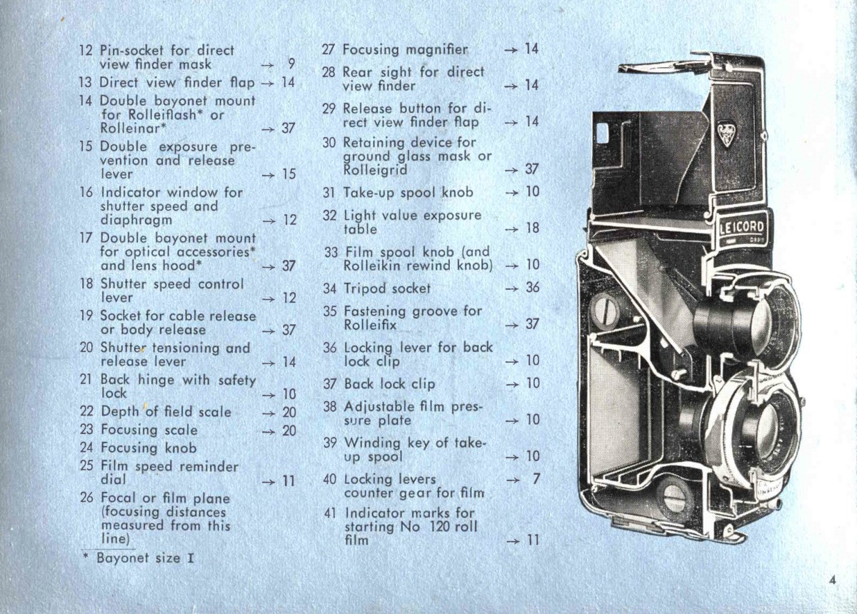

The D E S C R B T I O N (manual) is to a Roleicord Va macfred!
