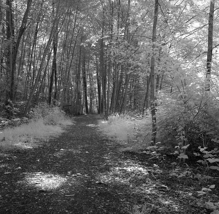

The image in the attachment is a result from my first experience with this film.
Here's the accompanying details:
Location: Ladner, British Columbia, Canada
Equipment Used: Mamiya C220, 65mm lens
Exposure: 2 seconds @ f/16
Film & Developer: Rollie IR 400 @ EI 12!, HC 110 Dil B, 8.75 minutes @ 20C
Paper & Developer: Negative Scan
Filter: Hoya R72
Hope this helps.
Matt
