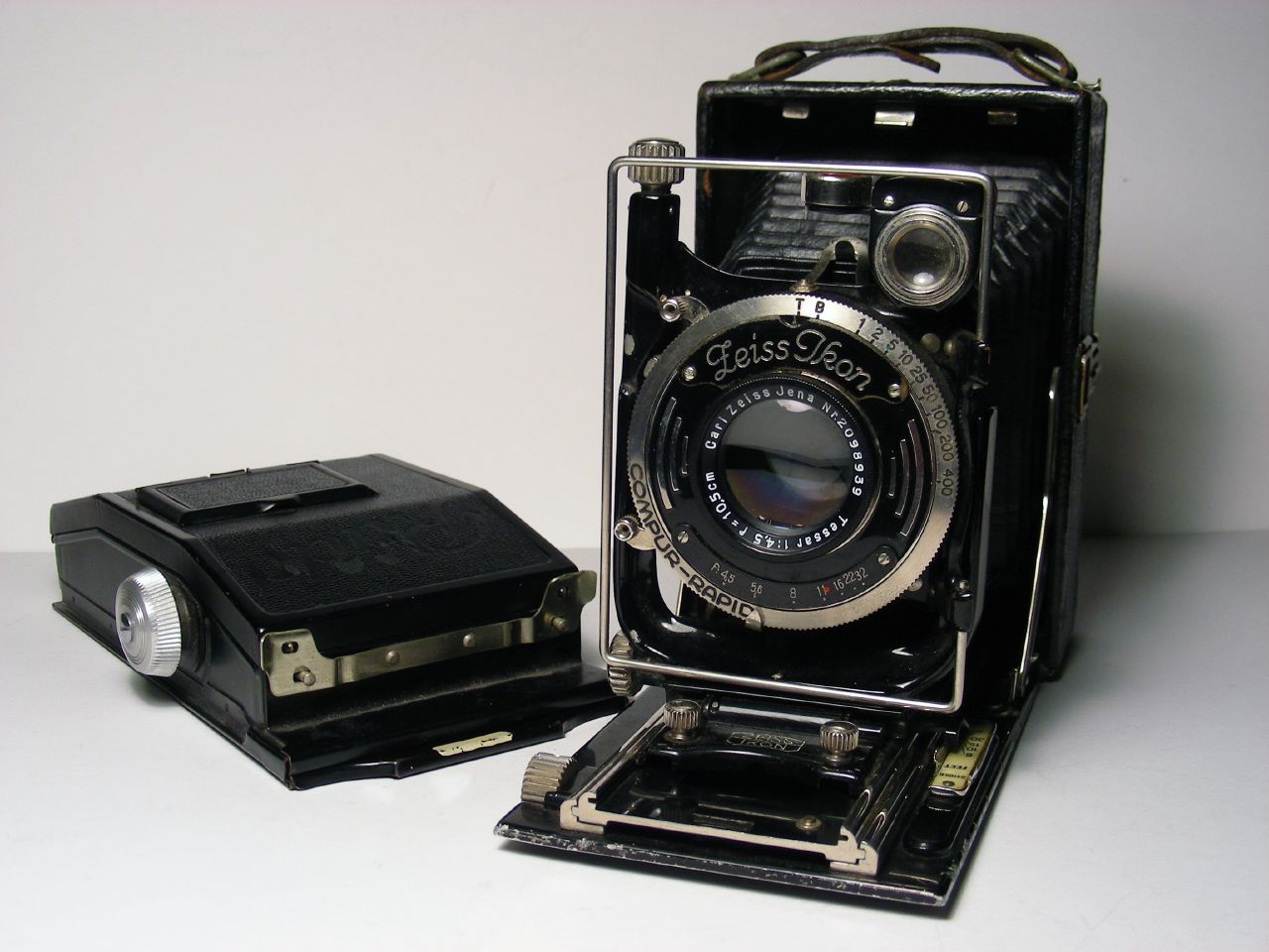

I have a Maximar A 6x9 plate camera and want to get a rollfilm adapter for it like the one on this blog. Does anyone know what it is ?
https://seeker312.wordpress.com/2009/06/02/zeiss-ikon-maximar/
Thanks !

search Rada roll film adapter. there are many right now on the auctions site.

Thanks guys! I think I'll try one of those Radas. I noticed they come with 6x6 and 4.5x6 inserts - I assume I can use the back without if I want to shoot 6x9 ?

Yes, and most come without the inserts. Be aware that there are many variations to fit different cameras.

I found one NIB a few years ago, with the 6x6 insert, the box isn't pristine but the Rada back is. Be aware that Plaubel Rada backs are post WWII Graflok type International fit backs, just like the Linhof Rollex backs.
Rollex roll film backs are much more common so far easier to find, and often quite cheap.
