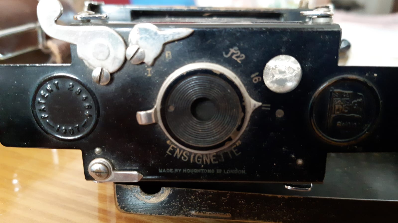

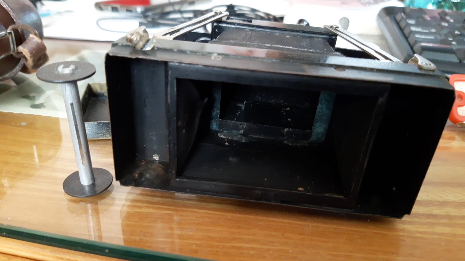

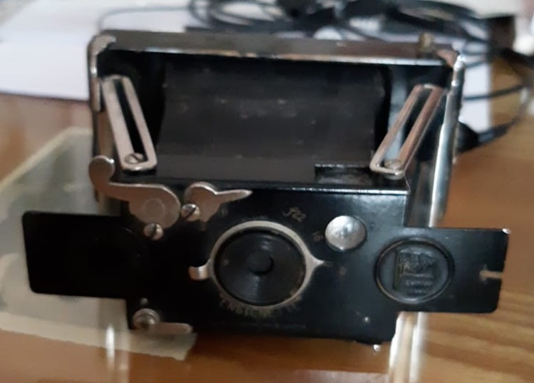

The camera is not really mine, but of a fellow photographer that I'm trying to help. I'm attaching some pictures, please excuse the low quality but he passed them to me by whatsapp. It seems that there is one spool left (better than nothing) which width is approximately 4,2 centimeters (which maybe converts to 1 - 21/32 ''). Does anybody know if this corresponds to the E1 (128) or E2 (129) format perhaps?

This would be E1 / type 128 with the nominal frame height of 1.5 inch.
The length of type 128 frame (2.25 inch) is the same as the width of type 120. You might be able to block the red window and cut 1.5 inch wide pieces from 120 type film and load it into the camera. You will have a single shot sheet-film camera. You can then develop the film in a standard tank on type 120 reel.

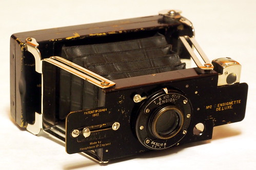

What is that knob/button above "Made by Houghtons Ltd England"? The OP's camera does not have it.
Do you have any photos taken with this Ensignette?
That’s the focus, it moves the lens in and out by sliding it. I know I took at least one photo with it but I‘ll have to do some searching to find it, it was just a test shot.
