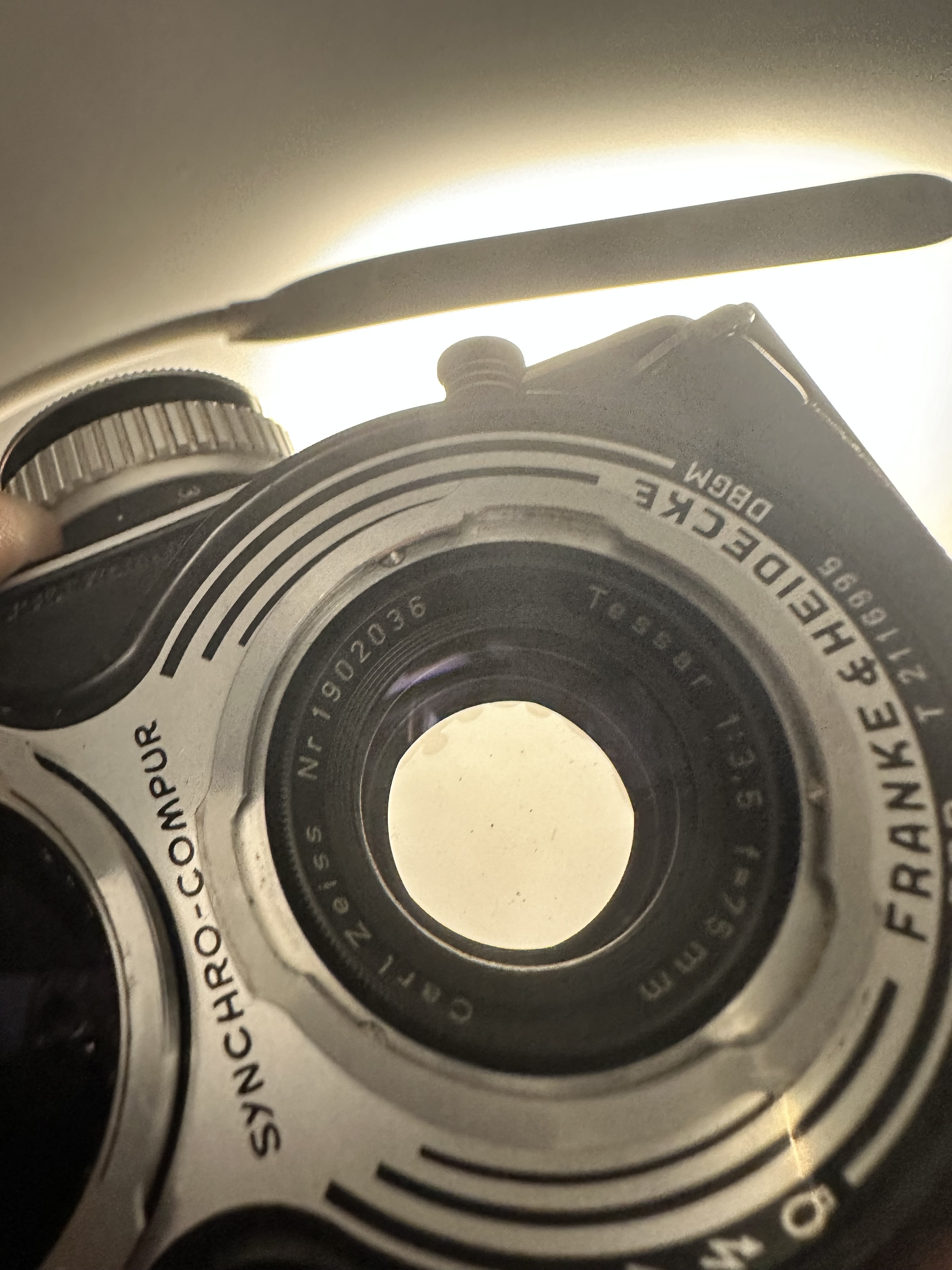

Hello All,
Recently purchased a Rolleiflex T along with a Medalist II from the same seller. As regards the Rolleiflex T, which has very sticky slow shutter speeds at least up to 1/8sec, I also noticed this (see attached photo). Is this lens separation? (No "rainbow" visible, top of lens in photo)
Thanks for your opinions/assesment.

Yes.
I don't know the solution. Maybe there isn't one. Maybe someone else will know.
And I am not certain on its effect. Some lens defects look bad but have no effect on images.

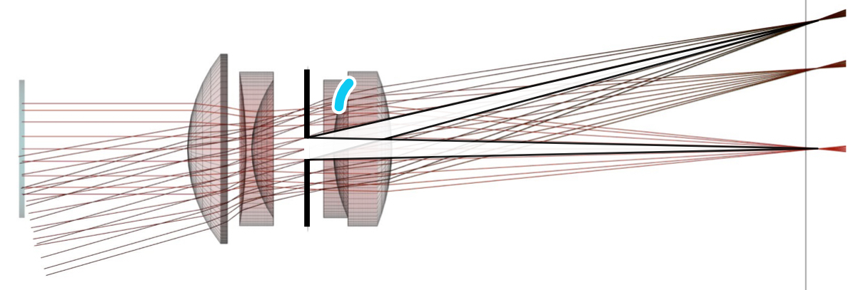

Here is a ray-trace of a tessar with edge separation like yours showing how stopping-down the lens can mitigate image deterioration from the abnormality.
