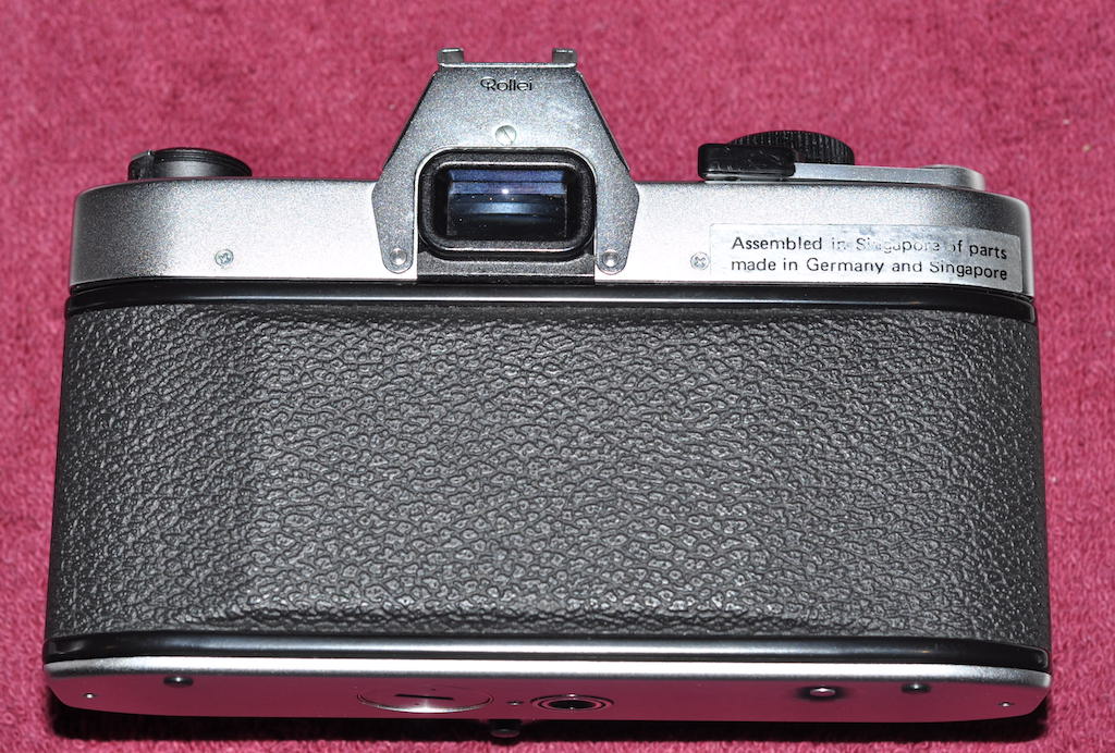

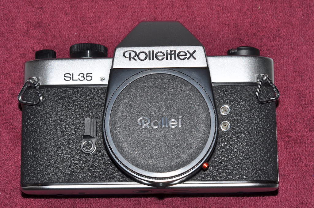

I picked up this nice Rolleiflex Sl35 with a non-functioning wind lever.
I thought it was interesting because, rather than indicating "Made in Germany" or "Made in Singapore," this one has a sticker on it that reads:
Assembled in Singapore of parts made in Germany and Singapore

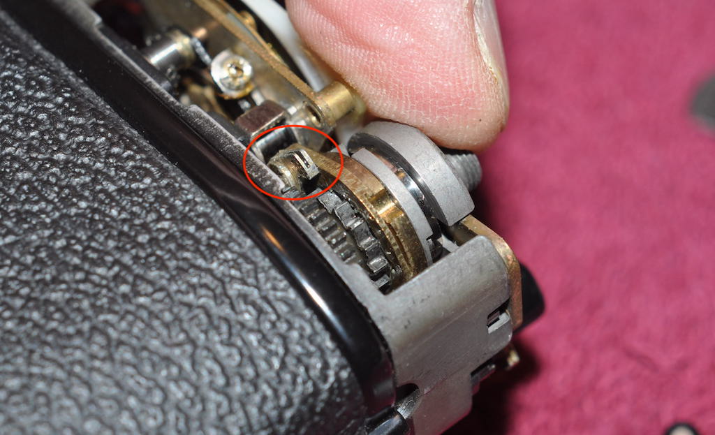

I sometimes wonder what is the smallest part without which the camera cannot function?
In this case, there is a 0.2mm spring that holds the ratchet pawl against the teeth so the wind lever can advance the film and cock the shutter.
Without the spring the pawl does not engage and the advance lever moves freely. As in the case of this camera as you can see the spring is missing in the photograph below.

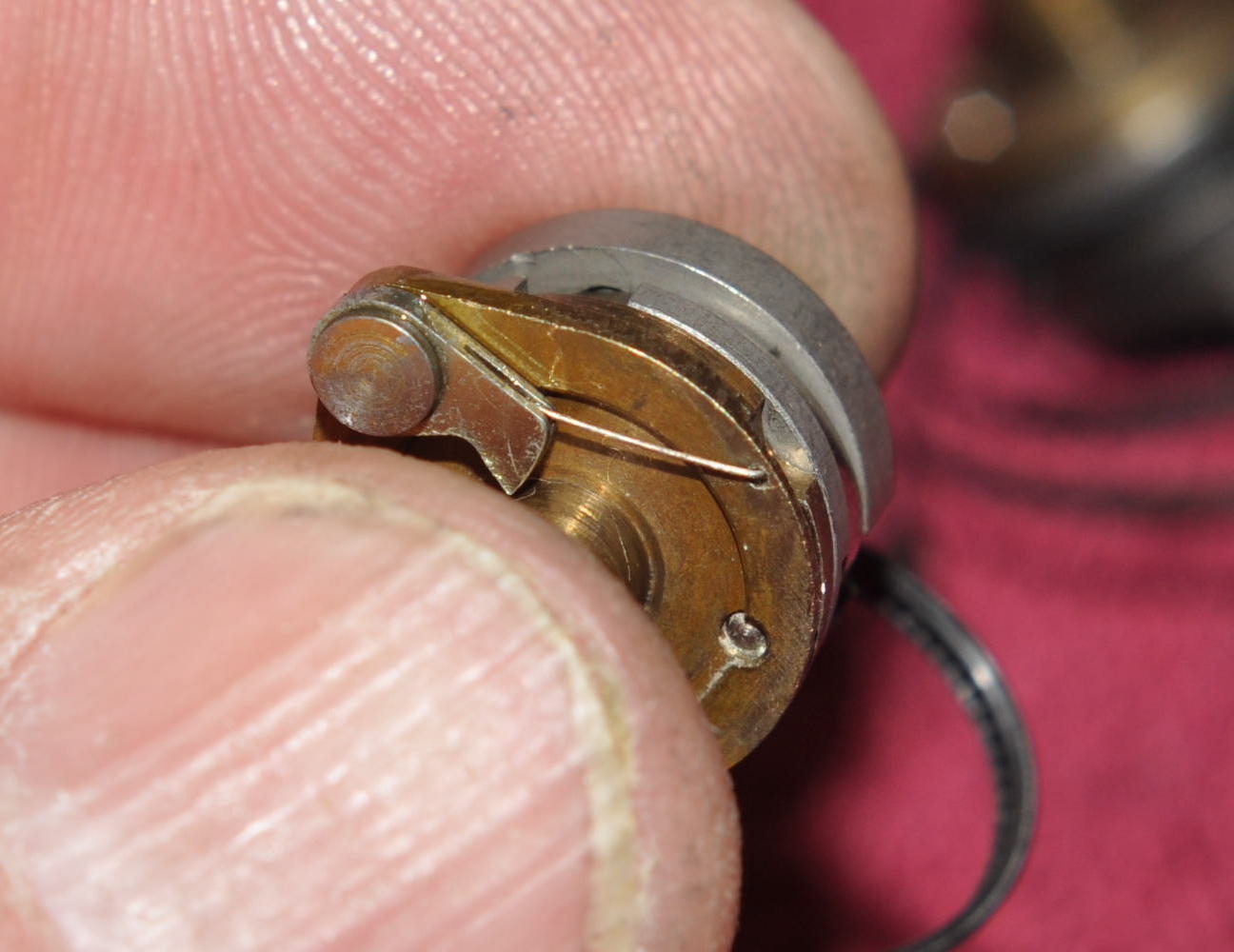

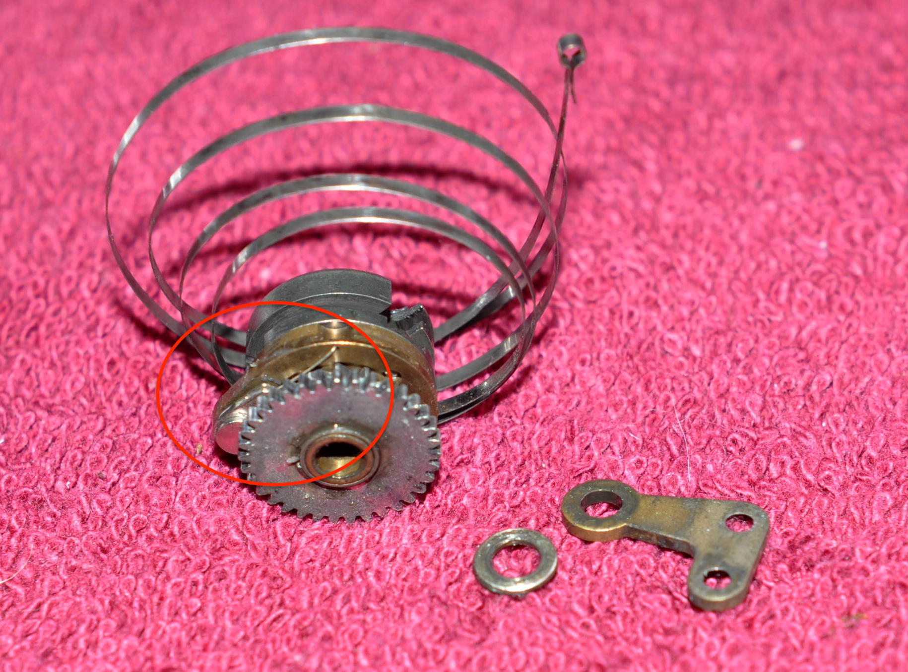

After replacing that spring, I can cock the shutter and start testing the camera.

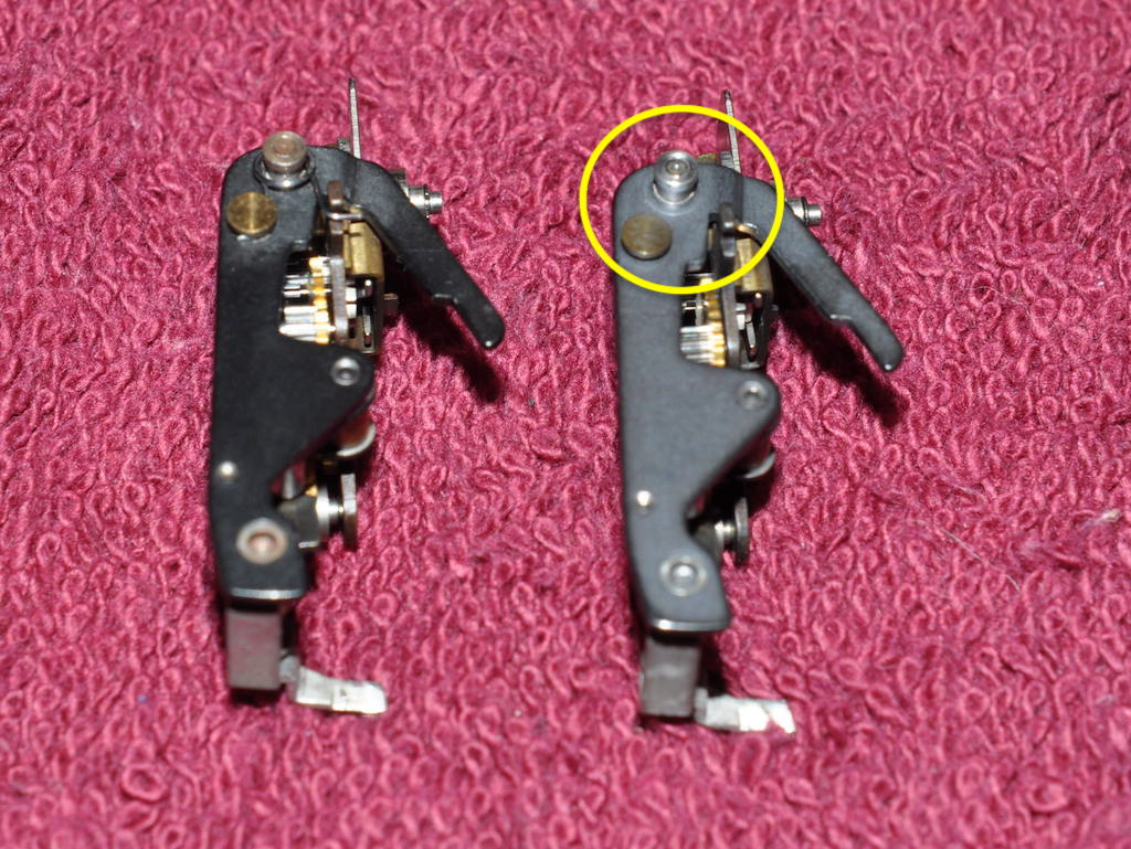

Turns out the slow speeds were way off. So, out came the escapement and...what? Another missing spring.
So the parts camera had to donated another spring.

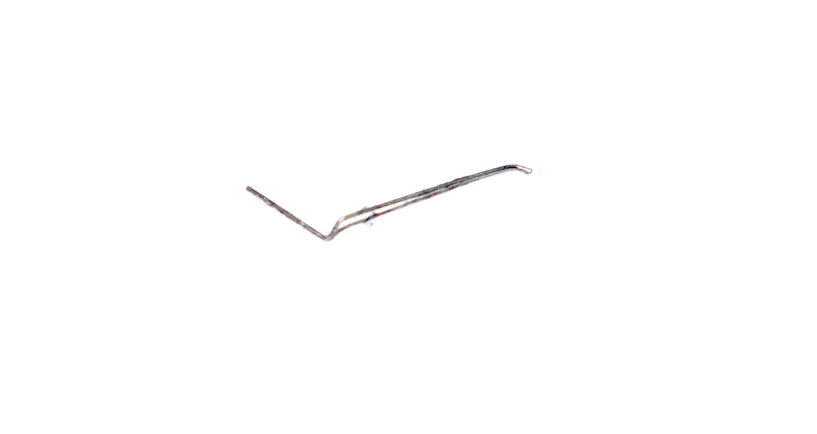

For fun I re-created the pawl spring with a guitar 0.009" E string and put it in the parts camera. It actually works!
