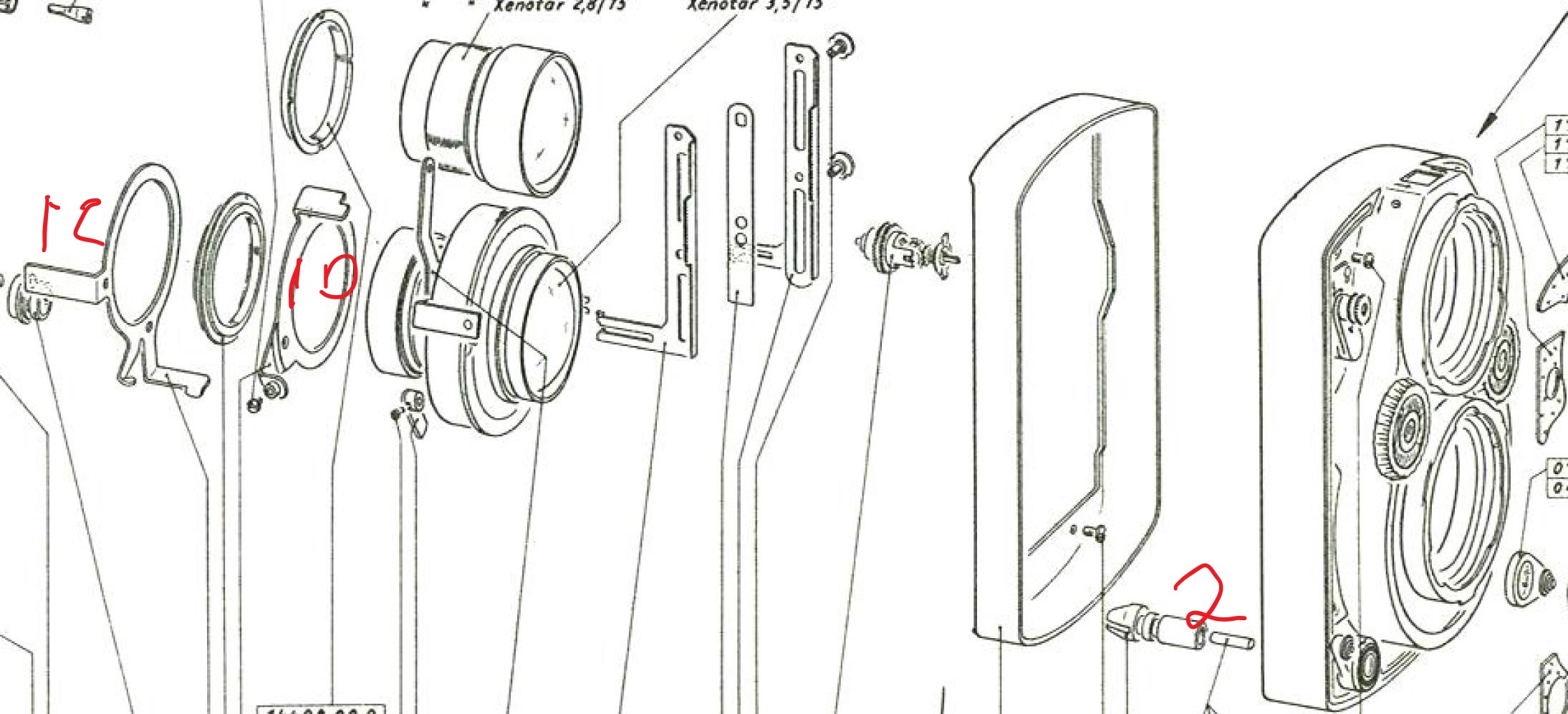

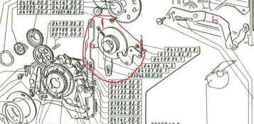

ScreenShot_20220321214436.jpeg ScreenShot_20220321214729.jpeg ScreenShot_20220321214859.jpeg
Numbering is not consistent between photos. Photo 1 the complete camera parts breakdown. A lot to take in so we look at sections. 1 in this photo is the winding/film advance/shutter cocking assembly, a lot of parts in a few modules. 2 is the cam assembly operated by 1, it moves arms that advance the film counter and the shutter cocking arm. 3 is the shutter cocking and release levers. 4 is the shutter release button.
Photo 2. 1 is the cam assembly at 100%; 1a is the film counter arm; 1b is the shutter cocking arm.
Photo 3. 1c is the shutter cocking ring; 1d is the release ring. 2 in the shutter button.
The problem is something in photo1 #1 is loose or broken preventing the cam assembly from fully operating blocking the shutter cocking from fully operating blocking the shutter release button. The cable release socket connects to the release ring latch and operates it.
