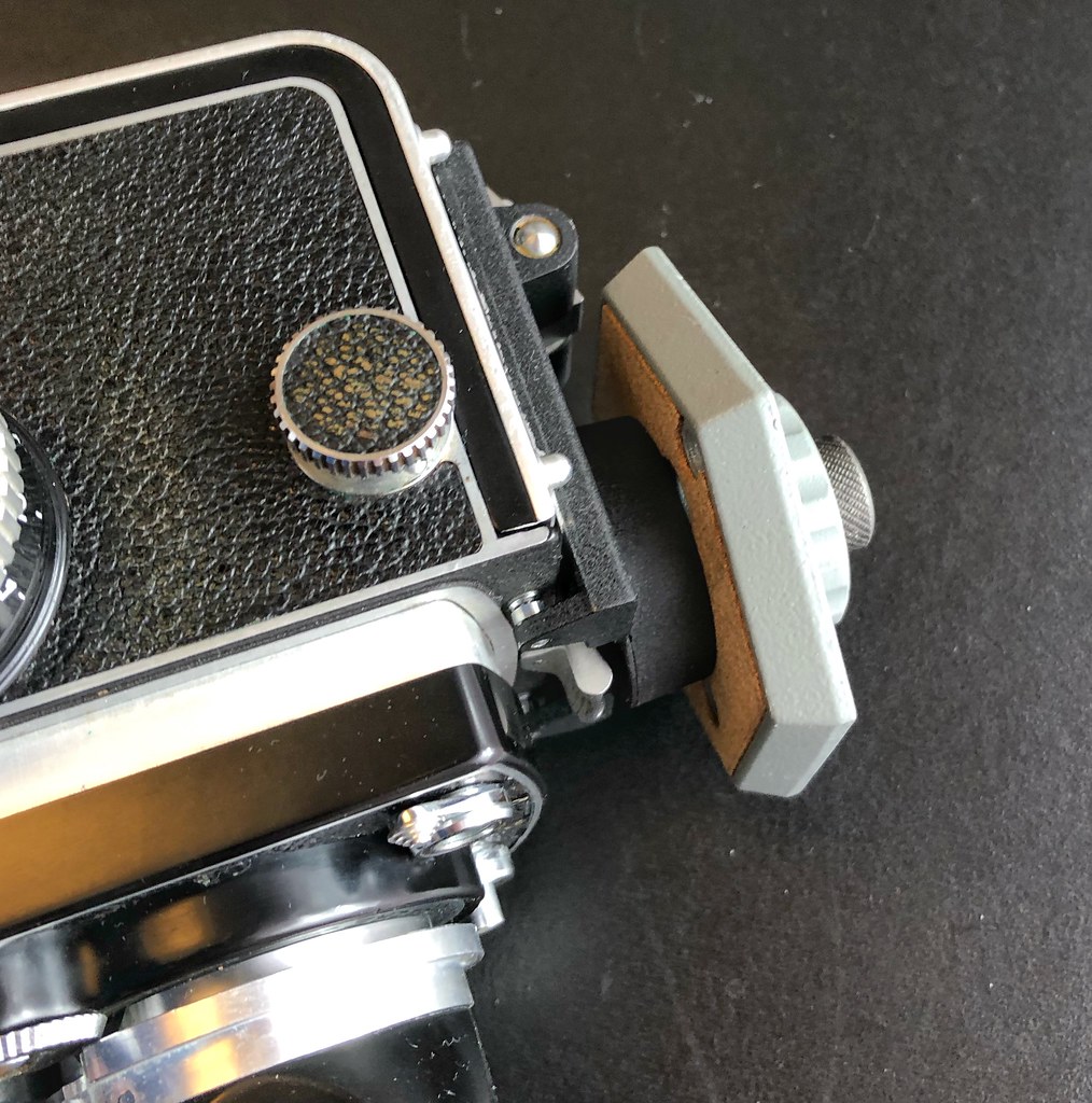

Just for illustration.
I don't recommend this particular type Manfrotto quick release plate in combination with the Rolleifix (it is bigger than ideal), but this should give you an idea:
quick release under the Rolleifix:
And mounted on the camera:
The camera slides onto the Rolleifix from the back and is secured/released by flipping the rear lever on the Rolleifix.
Of course, your camera needs to have the grove as illustrated in an earlier response, in order to be compatible with the Rolleifix.
