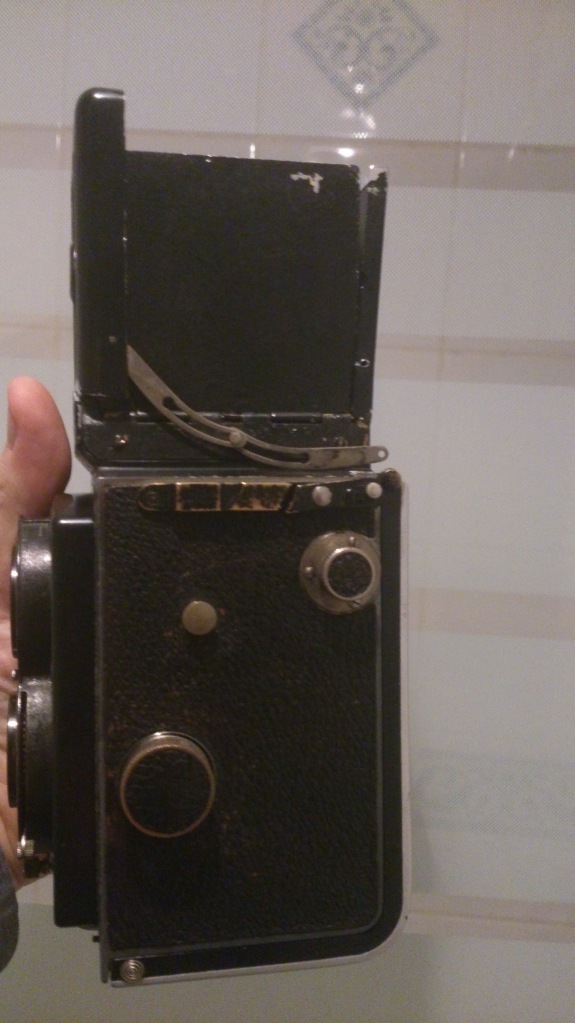

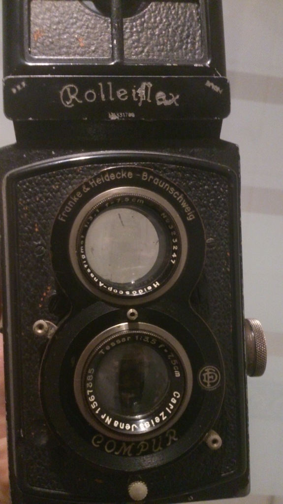

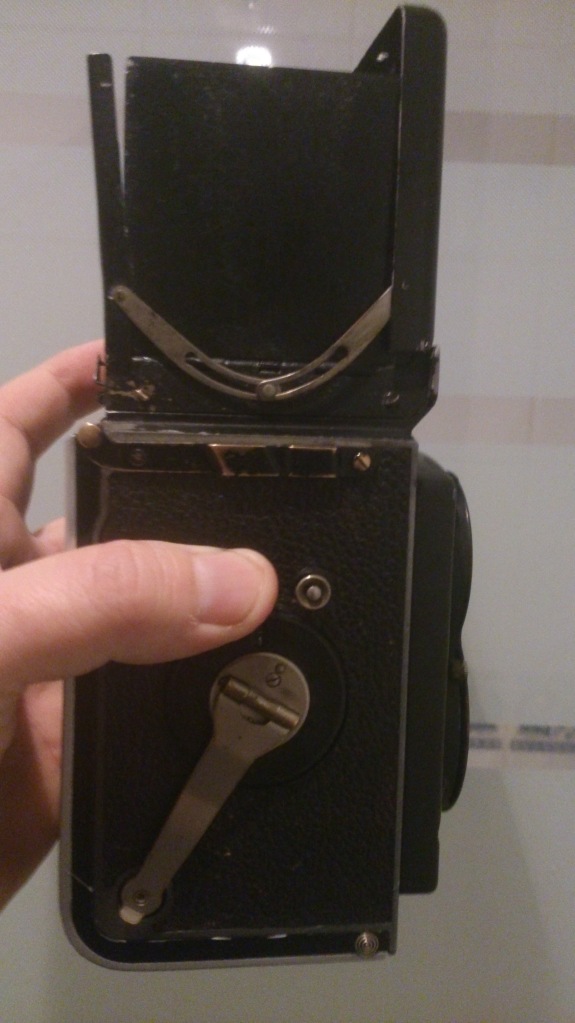

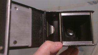

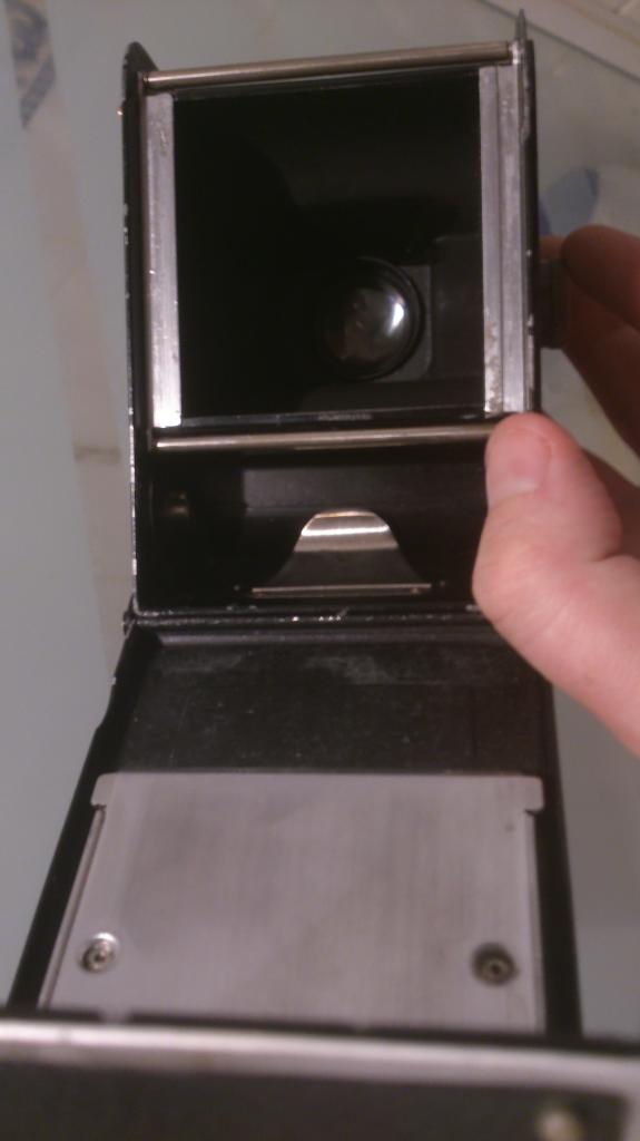

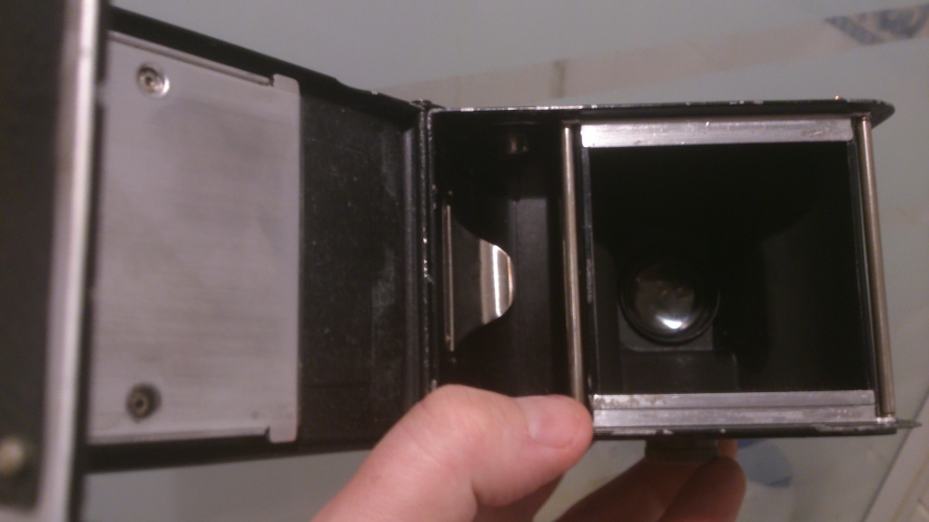

Thanks for your replies so far!
Here are a few pics for you.
So do you reckon it might be worth saving then?
The shutter speeds are definitely sticky and the B doesn’t seem to work properly. Does anyone know how the B shutter on this camera works? Normally(on all my other cameras) it stays open as long as you hold the shutter button down.
Next question – where can I send it for a CLA?
Lastly, is it difficult to remove the lenses? If its not too hard, I could do that and flush the mechanics as has been suggested.
I have to say, it has a lovely feel about it and that magic that some cameras have!
Thanks for the advice (and keep it coming!)
