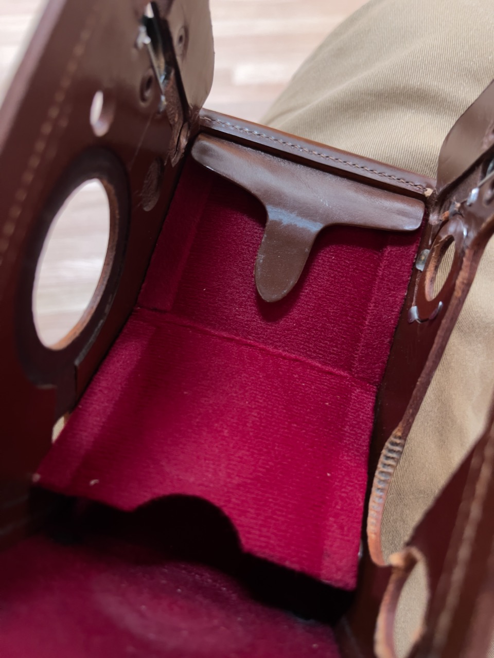

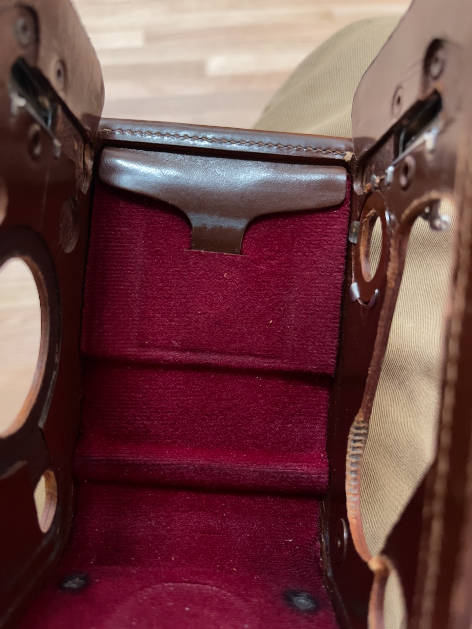

What's the folded felt inside the case (particularly 2.8f model)? Looks like some kind of hidden pocket? What's the purpose of this?

Thanks! I didn't know such a thing exists. Does it require a special back? Anyone here using it? Does it really helps? I didn't noticed I have a problem with the film flatness, but would love to compare two shots with and without a glass.
Yes, it needs a special back. Those who have used the flat glass found that it might make a tiny difference at full aperture, but that it's almost impossible to keep the glass dust free, and the dust specks will show up on the prints. It's pretty much an unnecessary accessory and more for collectors than users these days.
Then there's the plate back that comes with a ground glass cassette that lets you focus on it directly with the taking lens, and use 6,5x9 cm glass plates or sheet film. Sheet film has a thicker film base, perfectly flat in the camera.

Sounds like unnecessary for the type of the work I do, but good to know such a thing exists.
