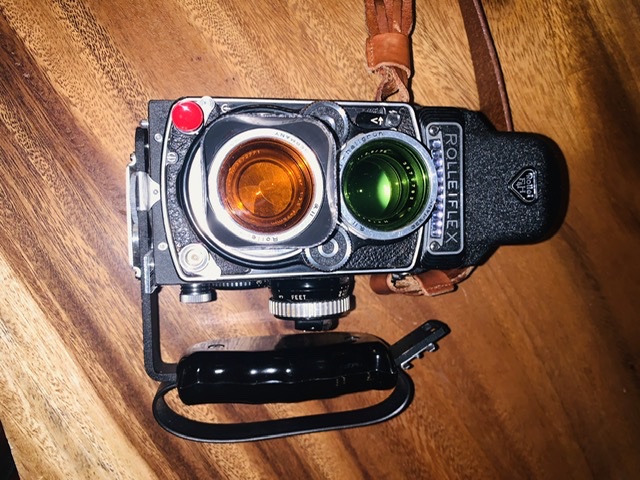

And here I was sitting, perplexed, and an idea came to me. I finally made the Mamiya grip work on the Rolleiflex. A perfect fit. “I’m a Genius”, I screamed. Ok, I’m not a genius, but this was a genius Idea.
Would someone be interested to know how? A PROPER L-grip is a must for many occasions on the rolleiflex:. Fashion, street, and even casual shooting.
let me know and I’ll post a few photos about the process. I’m sure there’s a few guys who would really appreciate this!

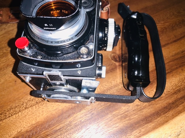

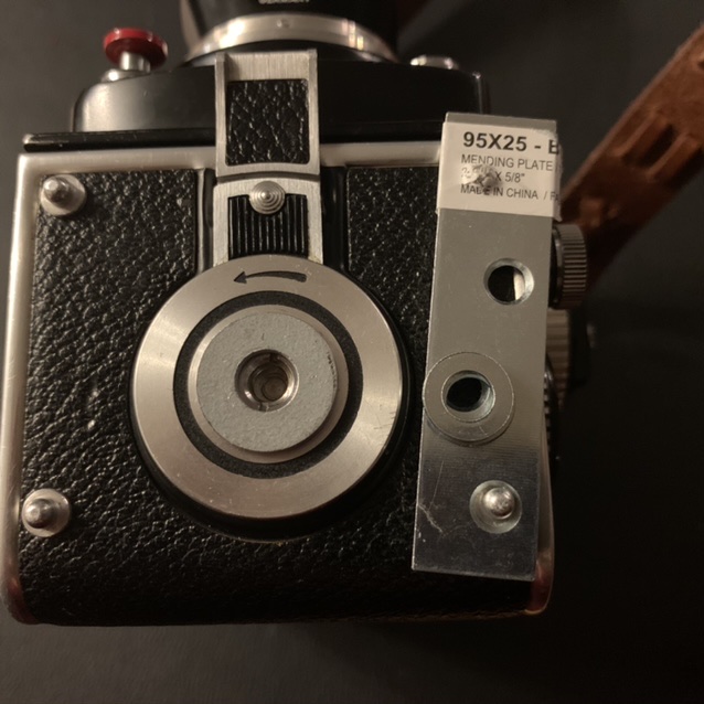

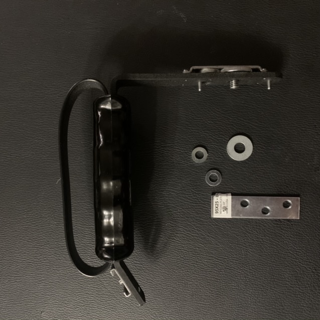

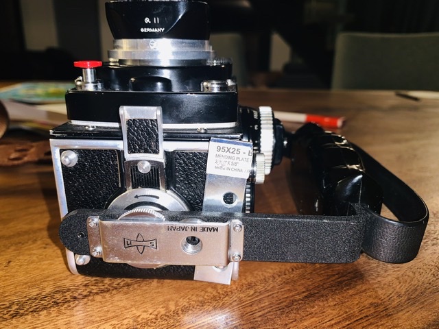

Ok here it is.
Way too simple, and costs about 1.62$.
I’m crying, I tell you.
3 washers and a mending plate.
Mending plate fit as is, but I was ready to drill a new hole if needed.
The mending plate is held in place by 2 of the rolleiflex’ feet (how would you call them?).
The big washer goes on the tripod socket. It allows for both the mamiya grip pins to clear the rolleiflex’ body.
The 2 smaller washers go over the mamiya Grip pin and they push the mending plate onto the rolleiflex’ body.
The washers and the mending plate secure the mamiya Grip in place. Just as if it was a Rolleiflex OEM product.
p.s.: my description really sucks, but the pictures show everything there is to know.
NB23
NB23
Jul 26, 2009
4,307
The last picture is how you would lay the pieces on the rolleiflex. And then you would simply lay the grip over that setup, and screw it on.

Focusing is surprisingly easy, comfortable and natural. Done with the tips of the thumb and fingers.
Just as without the grip where the right hand is holding the camera, ready to press the shutter button.
The pistol grip is so awkward... tilting the whole camera every time will surely end up warping the base of the camera, and winding with the left hand is so unnatural, especially in the horizontal position.
In the case of the L grip, I don’t see the danger of warping the bottom as there is no waving and tilting the camera around in such a crazy way as with the pistol grip.
Also, the L grip can be beneficial even without the quite heavy rolleiflex prism.
And there is also the quite acceptable and very light Porroflex for rolleiflex prism. Yes it gives a smaller viewing image than the Luxurious rolleiflex prism but its weight is definitely more user and camera friendly.
