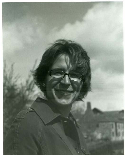

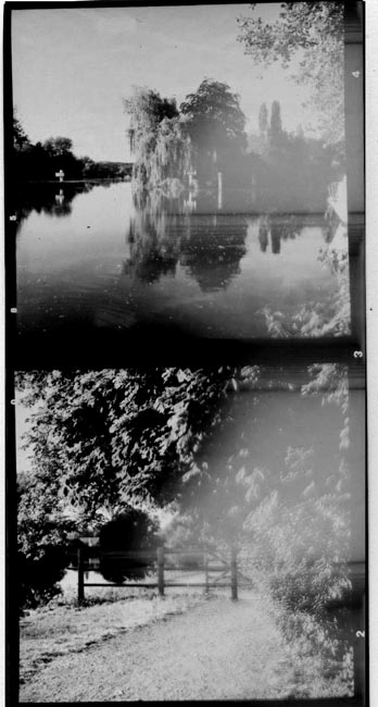

I have attached a couple of photos that I have printed from a set of negatives affected: in both cases the "tiger stripes" kinda go thru the middle. More evident in the portrait. In the other photo you can spot them between the masts of the first 2 boats. Somehow in the same rolls this stripes are sometimes more or less marked and clear....
ANy help in casting some light on this is really welcome.... I was enjoing so much the MF and the Rolleis :confused: :sad:
