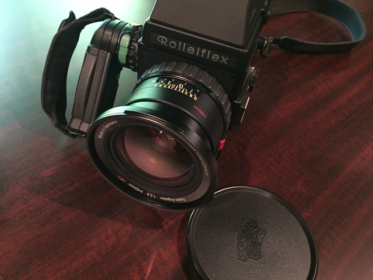

In anticipation of maybe getting a Hy6, I thought I'd try to get a lens first. Since I use 50mm as my 'normal' I thought I'd have to find that lens first before getting the camera.
I found one, but it did not come with an aperture ring. This will be OK on the Hy6, because that camera has a knob on the camera body to set aperture.
On the 6008i, I was not sure if the lens would work.
This is what I found. The lens fits and will focus manually.
The camera works normally and acts as if the lens is always set to "A"
Flash will be difficult, unless one wants to shoot at f2.8. I did find that if the exposure lock is set, the +2 to -4 exposure compensation knob becomes a makeshift aperture ring, as changing that knob alters the aperture but not the shutter speed.
So the lens is not totally useless on the 6008i. I probably won't be using the lens much on the 6008i if I get the Hy6. I have a 50mm Distagon FL ( with aperture ring) as my main lens for the 6008i.

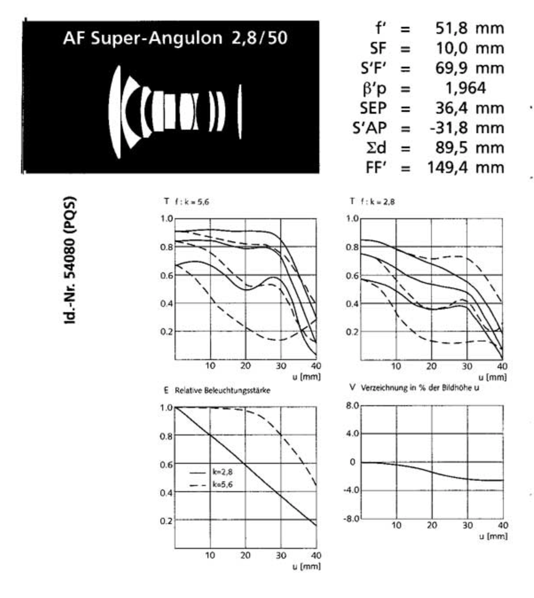

In comparing the 50mm 2.8 Angulon to the 50mm 4.0 FL Distagon, the spec sheets show the Angulon to be heavier. However, the both feel the same weight to me in a blind test. I'll try to weight them and see. So, by eliminating the aperture mechanism and with a different helicoid they got the weight of the f2.8 down to the same weight as the f4 with the floating elements.
