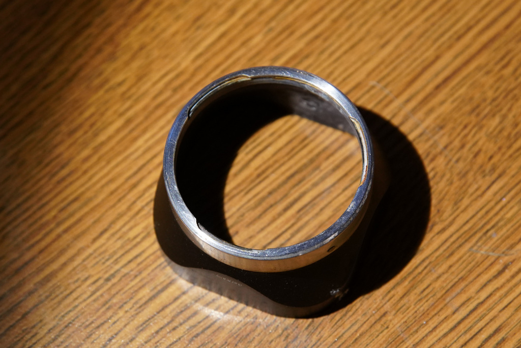

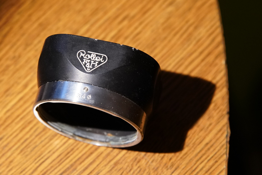

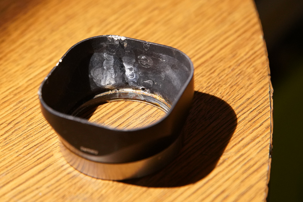

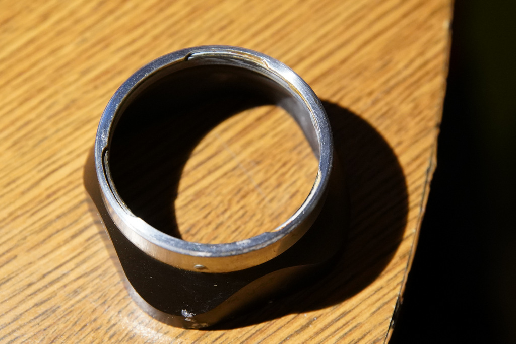

The odd size lens hood has a 34Ø marking on it which I assume is 34mm diameter.Any ideas on which model this would fit?
itsdoable
Aug 26, 2013
823
Canada
Bayonet 1 (I) = B30 (30mm) - all early Tessar models up to f/3.5
Bayonet 2 (II) = was marked B34 or B36 - early f/3.5 Planar models
Bayonet 3 (III) = was marked B38 or B40 - all f/2.8 models
JPD
Mar 24, 2007
2,155
Sweden
Early Rolleiflex Automat cameras with bayonet mounts could also use 28,5 mm push-on accessories. Many Rollei bayonet I filters are marked "28,5 ⌀".
