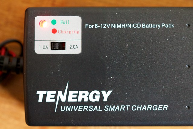

I replaced my SLX's NiCd cells with NiMH cells and within 10 minutes the battery pack was really, really hot. Disconnected it and I now use a Tenergy Smart Charger for charging the pack with the NiMH cells. I really don't trust the Rollei charger with NiMH cells.

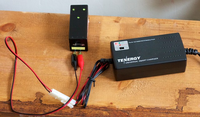

No. It is a Cellpro Multi4 Charger from Revo. I got the bundle with the charger, wall plug, and USB module. You can connect it to your computer, modify, and load different charging regimens. It also outputs data and graphs as it charges so you know exactly how much charge was put into your batteries and at what voltage charging ceased. It's better than the literal black box Rollei gives you. You select different types of chemistry and it implements different charging regimens. It does not utilize the heat sensor though. It cuts off charging using voltage fallback. In my experience it works perfectly. Currently it is $85.
The only thing that sucks about these chargers is connecting the charger to the battery. I had to get some small nails to put in the holes in the battery and then solder alligator clips to the wires from the charger. Luckily I had a soldering iron and solder from another photography DYI project.
