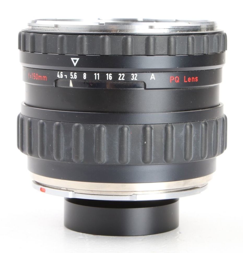

I bought an Apo-Symmar 150mm macro lens and mounted it on my Rolleiflex 6008, along with a 67mm extension ring (the et-67), which is the recommended thing to do for non-macro usage AFAIK.
This setup is only focusing from 1 meter to about 3 meters, not closer, not farther.
Is it normal?

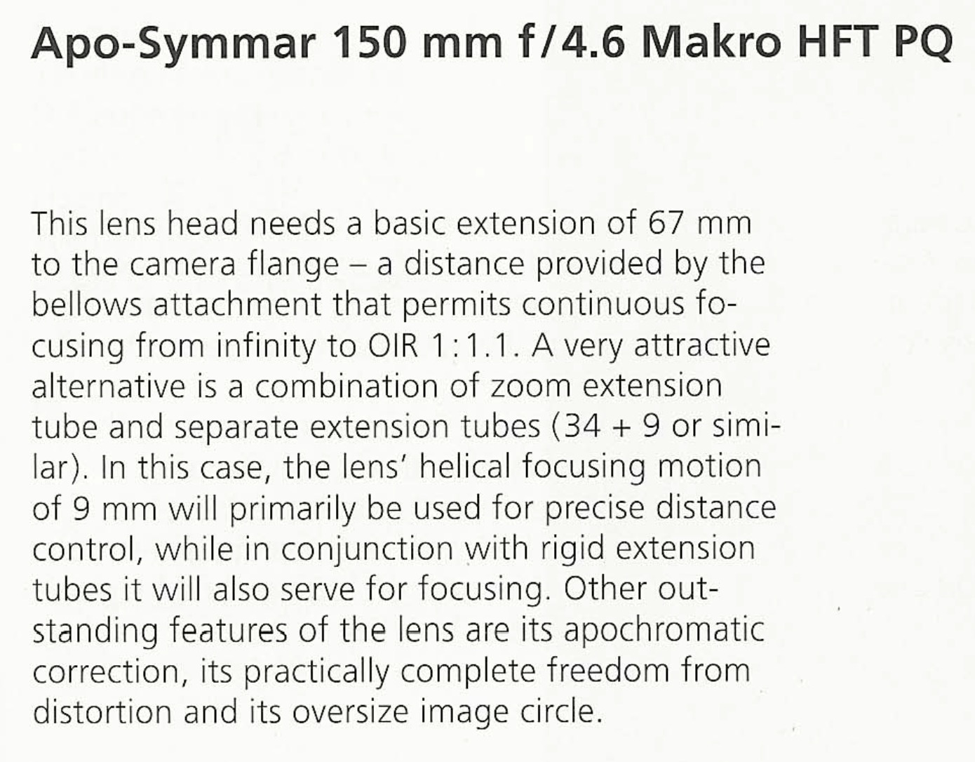

You won't be able to use your lens, on your camera, for non-macro work.

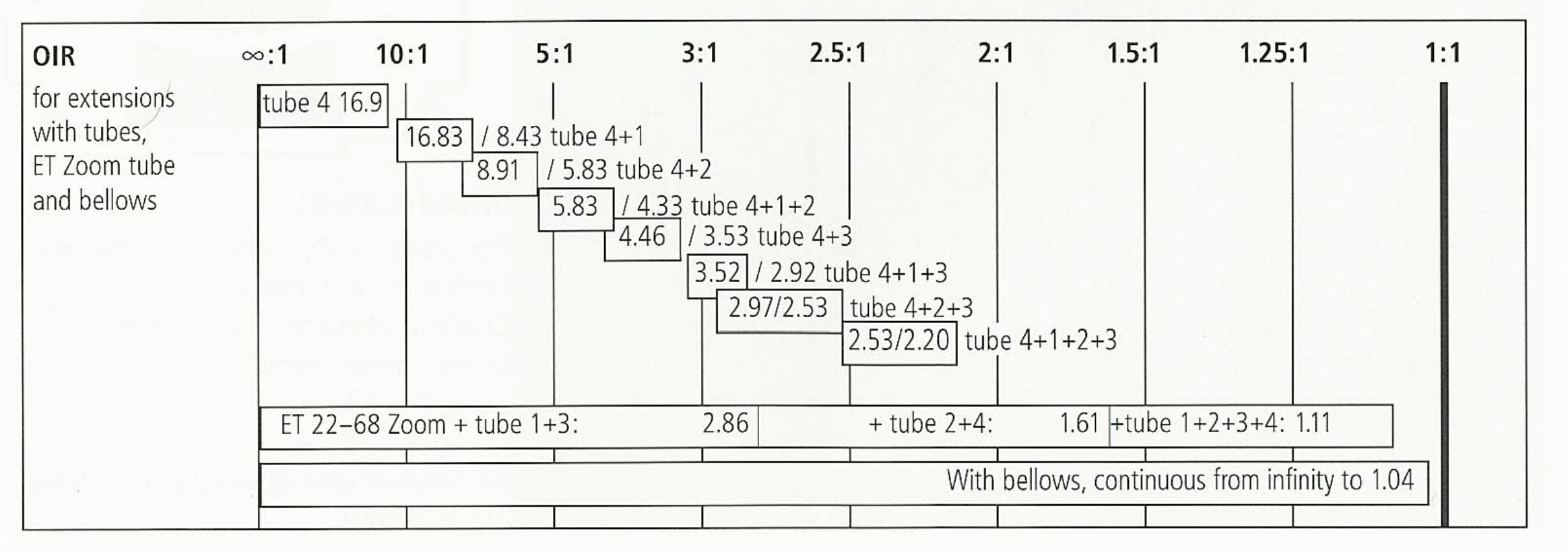

For use at infinity and most non-close-up situations, it looks like the extension tube 4 would work for you.It looks like either the bellows (which would be pretty unwieldy for most non-close-up work) or the zoom extension tube would cover the entire range this lens is capable of. I would be wary of using this lens for everyday purposes, most macro lenses are designed to perform best at close distance. You might want to sell it and buy a regular 150mm lens. They seem to be readily available and not too expensive for a Zeiss/Rollei lens.
Thanks, it sounds like the reasonable thing to do. I’ll run a roll through it just to see what happens.
