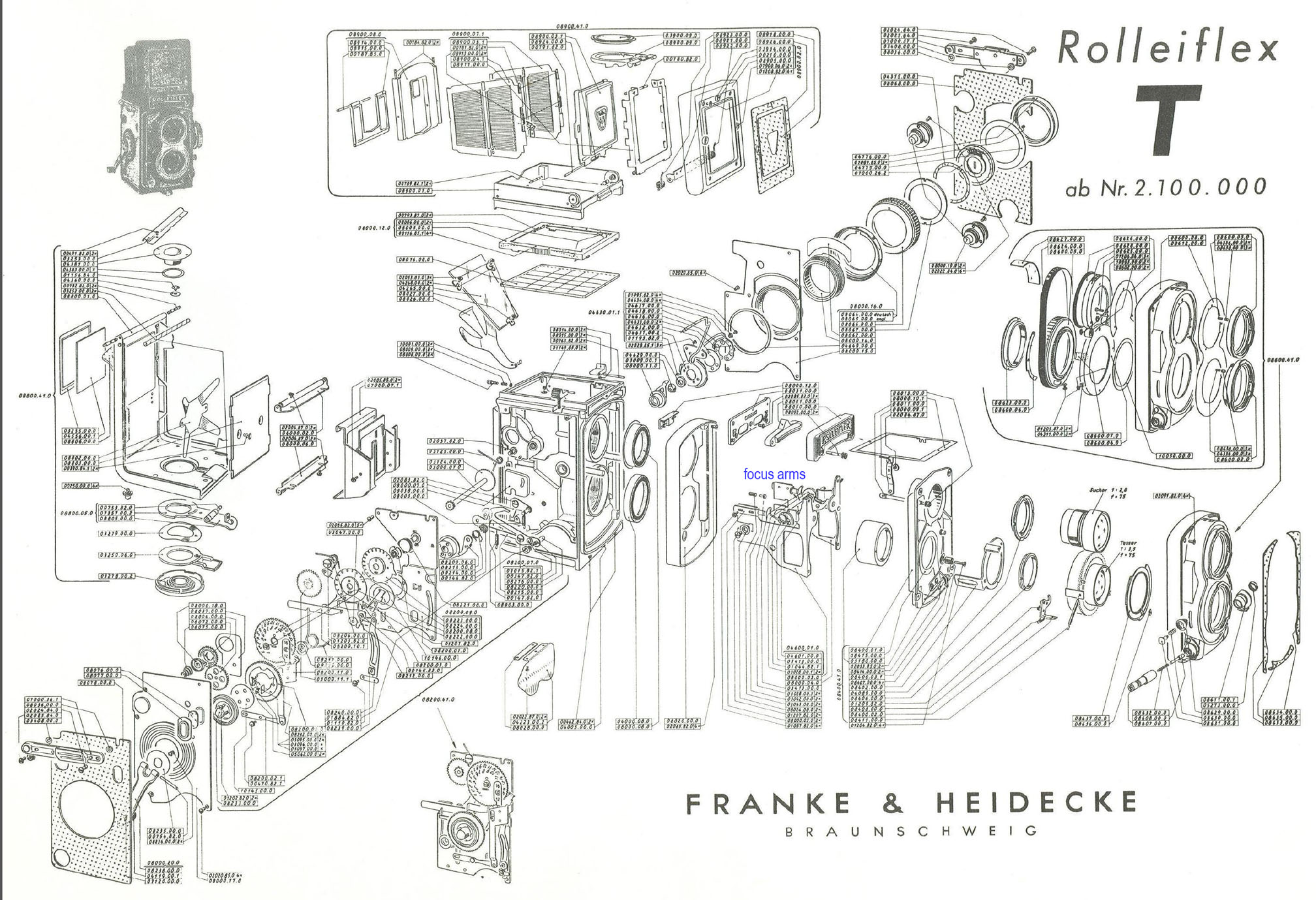

shutterfinger
Feb 25, 2013
5,020
San Jose, Ca.
Download the Rolleiflex TLR Service Manual https://learncamerarepair.com/downloads/pdf/Rolleiflex-TLR-Repair-Manual.pdf
Its a huge file. Look at the T diagrams and instructions. A complete exploded parts diagram from a different manual.
