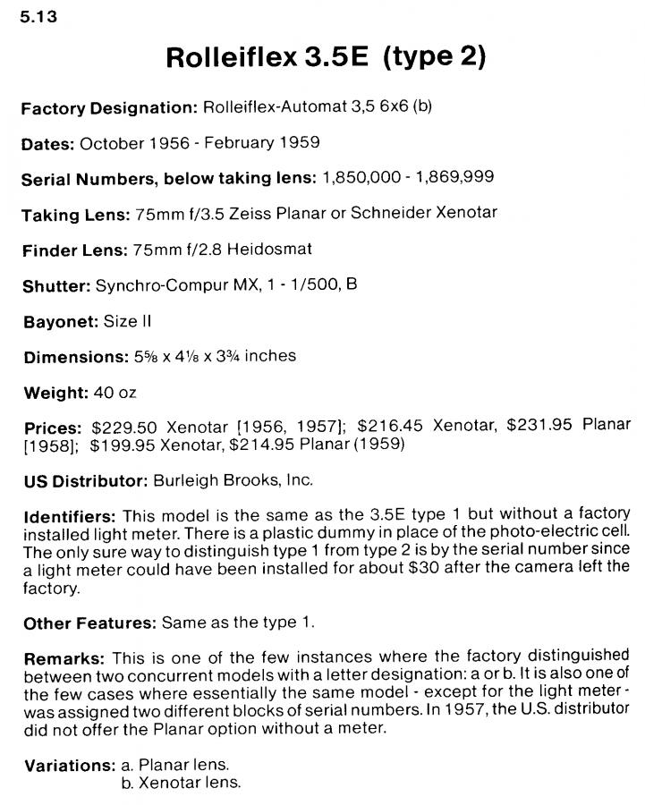

It's a 3.5E (type 2) according to the Collectors Guide to Rollei Cameras, by Arthur Evans.

It's a 3.5E type 2
Not to nitpick but,
According to my reference, Collectors Guide to Rollei Cameras by Arthur Evans, this camera is definitely a 3.5E (type 2). The type 1 had a meter, and the camera in question does not. The serial number given (1861195) is within the range of numbers listed for the type 2. The highest number for a type 1 is 1,787,999.

No, it really is a 3.5E type 2. The type 1 was only sold with a meter and had a serial number below 1.800.000. The type 2 was sold with and without meter and could also be equipped with Xenotar. Serial number above 1.800.000. The E2 is a different model.

craigclu
Sep 8, 2002
1,326
Rice Lake, Wisconsin
Just for reference, here's Arthur Evan's summary on this.
