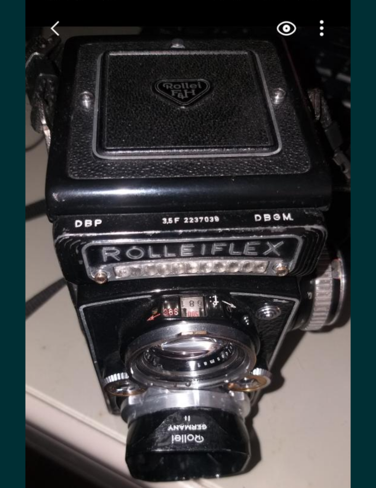

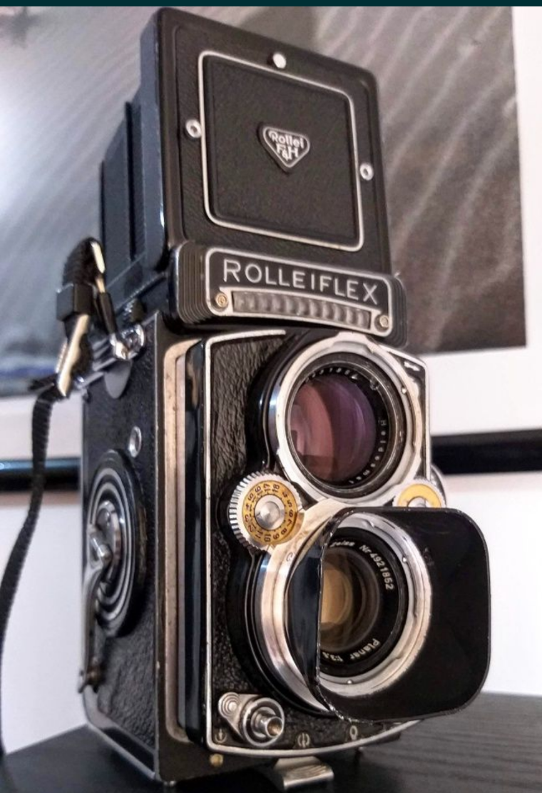

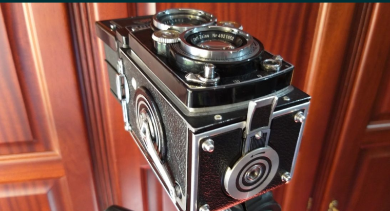

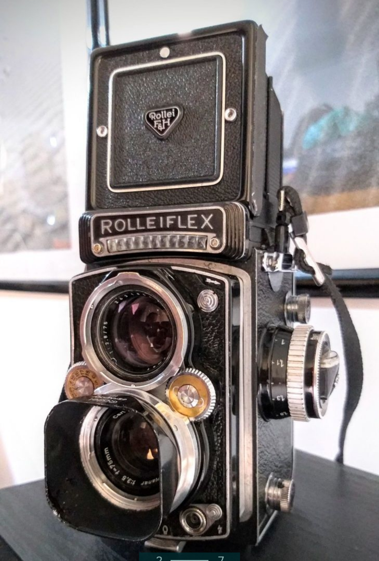

Hi,
Im about to buy this Rolleiflex 3.5F with planar 75mm.
My question is, on this particulary 3.5F model, there is no ASA dial. Every other model 3.5F i see online has the ASA dial!
Also, his asking from 600€. I may ask for less. What do you think?
I Will put various angles of the câmera, but my main concern is that there is no ASA dial. Thats what makes me think its Fake.
Im no expert, and this may be a dumb question/concern!
Thank you
Diogo
Dan Daniel
Jul 4, 2009
2,883
upstate New York

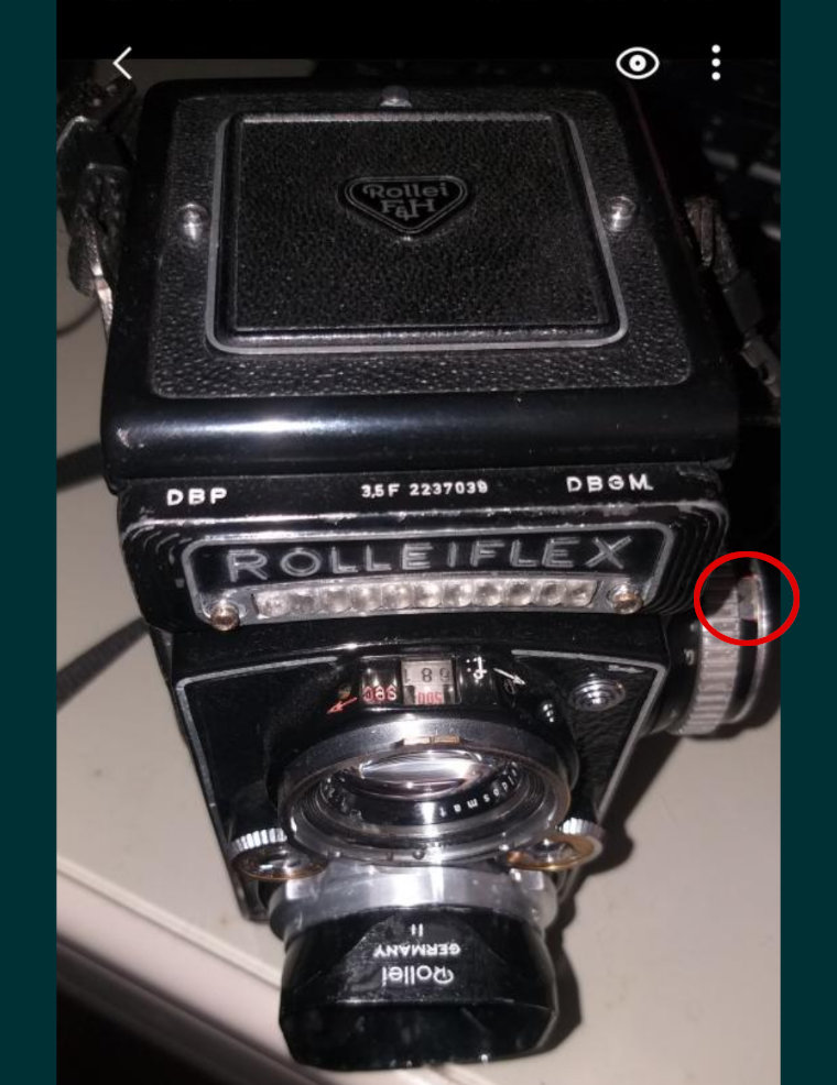

That is not an F. It's an E. Someone swapped in a different meter housing to get the F serial number.
Could be legit reasons, could be a sign of more tampering under the hood. I'd be careful.

Any exposure meter needs a dial to set the film speed. At the sample which the OP got in mind such dial is not located where it should be.
My idea is to look/consider with his sample whether such dial is not incorparated in the barrel of the meter as it seemingly is at other samples/models.
The OP was wondering about such dial lacking as such and not wondering of it being relocated. But maybe I misunderstood what he meant.
itsdoable
Aug 26, 2013
823
Canada

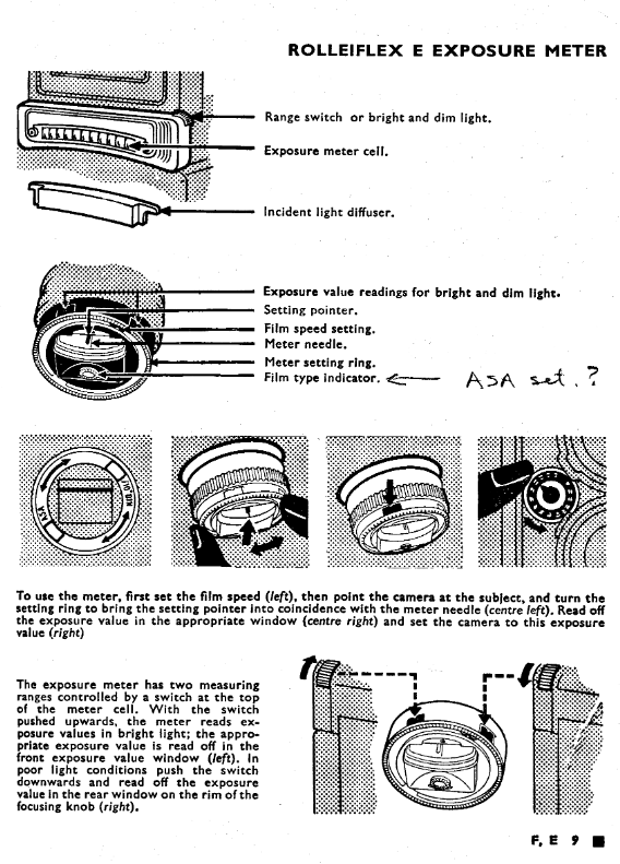

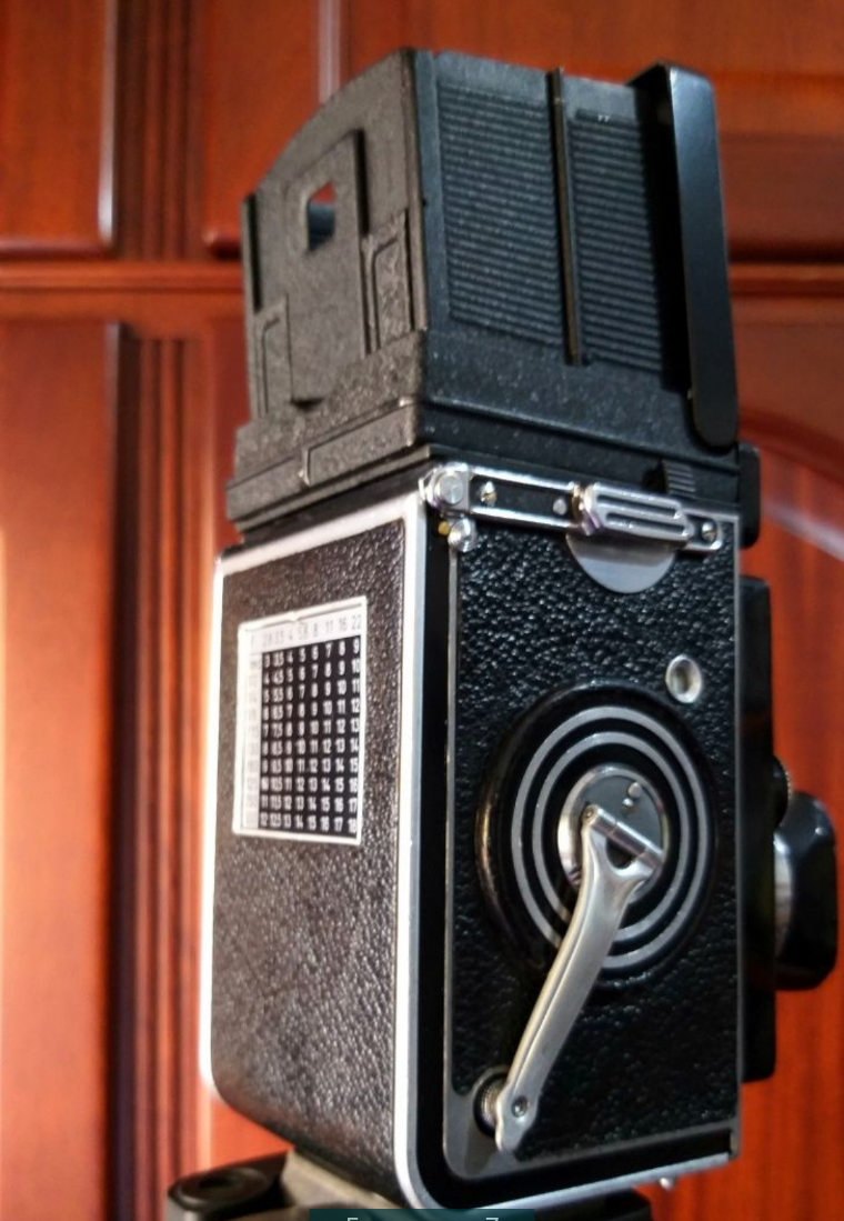

The ASA setting for pre-F meters should be located as shown:
I can see the window, but not the underlying marks.
I have not seen one with brass coloured dials, it's obviously been serviced and repaired, modified with newer parts taken off an F. It looks like the linked EVS is there, but no longer marked.
Edit: Oops - what I showed above is the EV window; Here is the page from the E meter:
(I should know better than replying when I don't have the camera anymore!)
JPD
Mar 24, 2007
2,155
Sweden
Yes, it looks like a 3,5 C (or '3.5 E' in America) that has been modified so it can use the removable viewing hood, so it got a 3,5 F nameplate from a spare parts camera. It's a Frankenrollei.

Guys thank you so much. What i take from here is that it is a model 3.5E (América) and 3.5C in Europe. Not an F. Its a Frankenrollei!

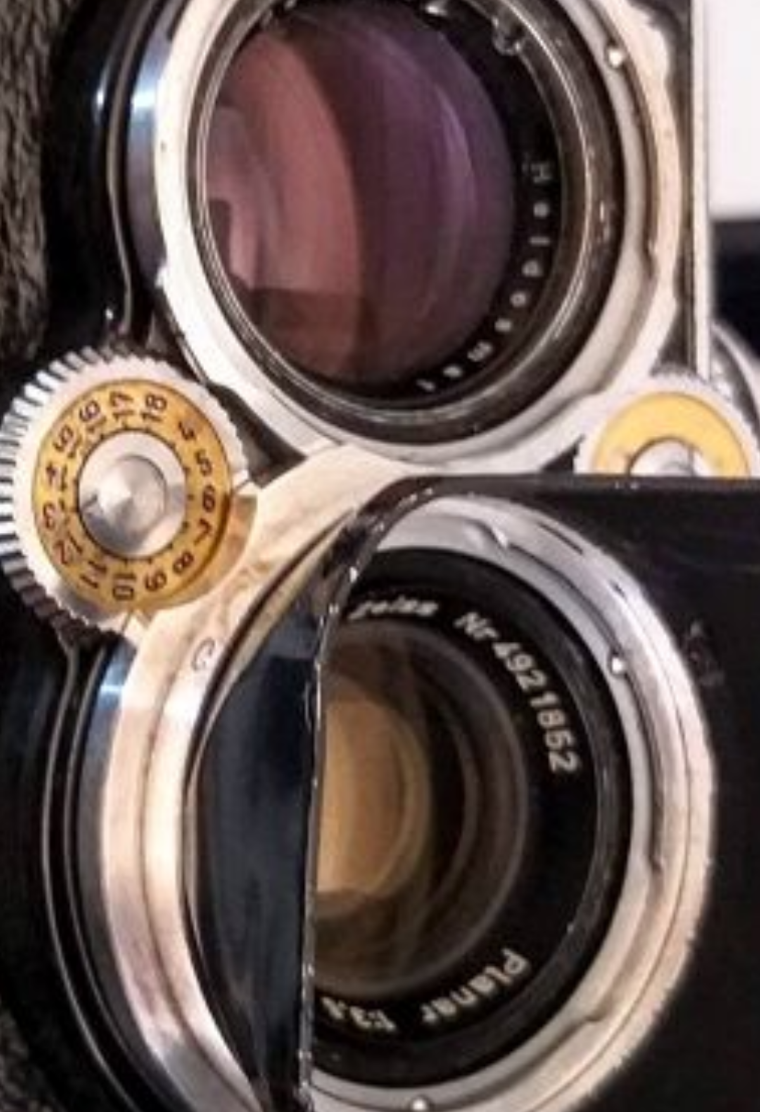

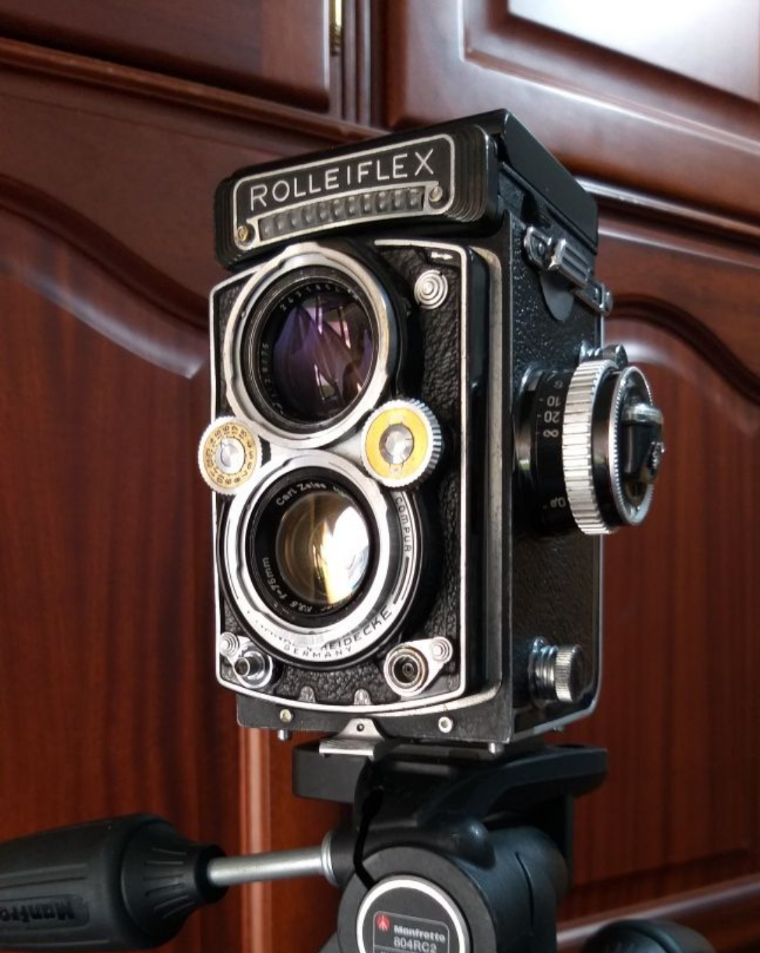

I looked at the pictures of the other cameras on the seller's site, and:
The 2,8 C has coating damage on the lenses and ugly dents on the front standard.
The 2,8 D looks to be in very good shape! The distance scale is in Feet, if that matters to you.
The 3,5 C looks like a good user camera. Not pristine, but fine if it works ok.
If the 2,8 D is in good working condition, I would be tempted to buy it. The distance scale is in Feet, but that doesn't affect the photo quality. The 3,5 C is not as good looking, but could be a more than fine user camera. :smile:

Yes, the E2 and E3. The difference is that the E3 uses the same shutter as the F so the spacing between the lenses is a little larger.
If this camera was an E2 then the model name and serial number would be below the taking lens. Or perhaps it was on the nameplate for the really early ones, but I doubt that. If this camera was made with a removable hood from the beginning, then why the F nameplate? Sure, it could be an unusal E2 with no serial number on the front and with a broken nameplate replaced with a spare F one. I doubt that.
