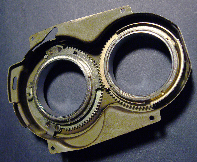

There is a lot going on inside the lens shroud. Here's the inside of a Minolta Autocord-
It uses simple levers to move the gears. A Rolleiflex has a gear at the end of each dial driving the large lower gears you see.
And the the F has the meter coupling. So not only do the dials move the indicator rings, they move other parts going back into the camera body. As one part of this, for example, there is this part shown in an Ebay listing (just one in the camera)-
http://www.ebay.com/itm/Rolleiflex-...213?pt=LH_DefaultDomain_0&hash=item258ac09a75
Well, just to give you hint of what is going on inside that F. I can't see oil doing much good. The odds are that the problem is coming from places the oil will never reach, and the oil will find places it shouldn't be. I'm not sure what the best answer is- either just work with the stiff dials, or that they indicate a serious problem that needs to be fixed or risk losing shots- but dripping oil inside is not a good idea.
