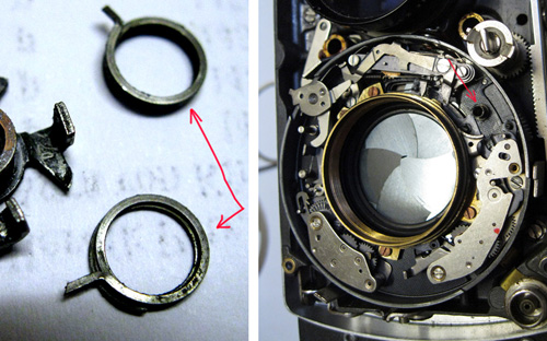

Can anyone please help? I need a shutter charge spring for a Rolleiflex 2.8F shutter. I sure hope this doesn't happen too often..:D
Cheers, Razz.

Contact a shutter repair outfit. Nothing absolutely specific to Rolleiflex with the design of the Synchro-Compur shutter in your camera. A place that handles large format cameras is a possibility. If you were in the US, there are places I could suggest, but I expect someone in your part of the world will recommend specific places.
On your photo, there is a small silver piece to the lower left of where this spring goes. It's a catch for the outer end of the spring itself. While reinstalling the spring on a similar shutter, that part simply cracked in half. A repair woman here in California says that she had never seen that part break in years of work on Synchro-Compurs, but that shutters seem to always find new ways to break. She sold me a replacement part. I bet finding a new main spring won't be difficult.

Or, alternatively, perhaps you can find a cheap non-working camera with synchro-compur shutter and use it to find the required part.

Please state the dimensions of your spring. I may have something that will work for you.

Thanks Brian. Inside diameter is 5.5mm. I have springs from Prontors and Compurs, but they're smaller. Camera belongs to Stephen Dupont, so has probably survived the odd roadside bomb in Iraq...

Check measurement of your shutter to determine size- opening where lens goes and front to back flange distance should pop up on a chart. A Synchro-Compur on a Rolleiflex Automat MX-EVS is a '#00' size. So I assume the 2.8 shutter will be a #0 or #1. With a part number, you might be in a better position to talk to a variety of repair outfits. Still, "main spring, that circular thing Xmm across, on a Synchro-Compur #0" should be pretty obvious to a repair person.
