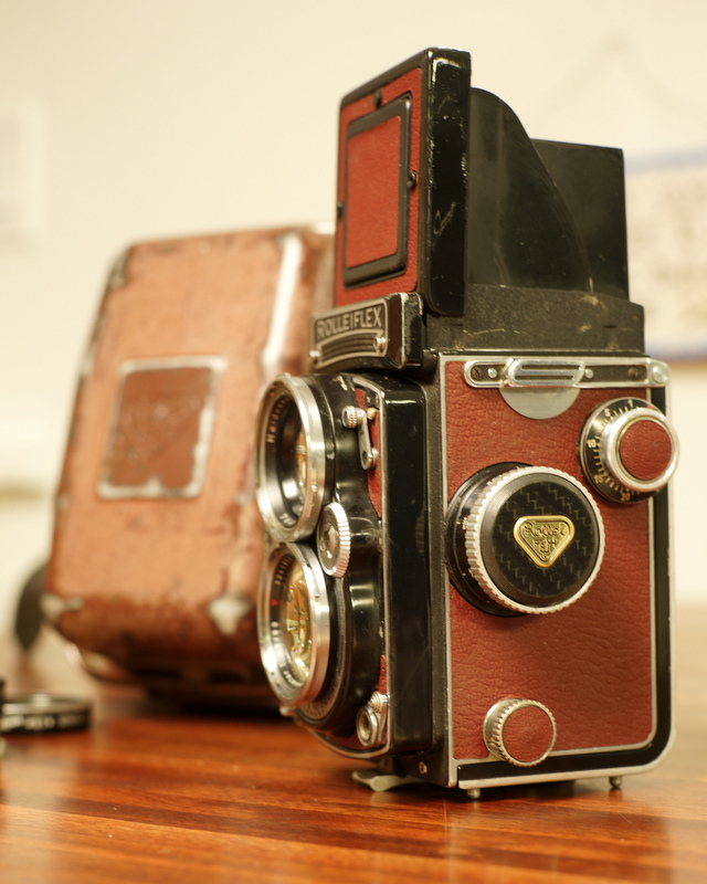

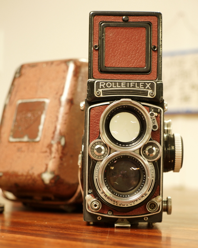

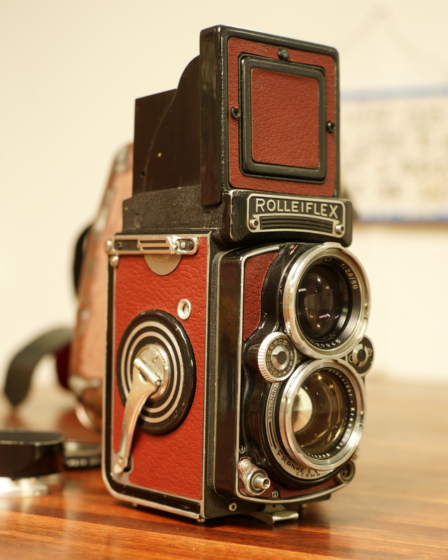

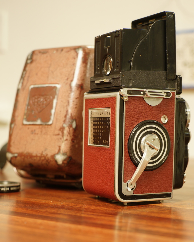

The desktop PC at the cottage, which happens to have my scanner attached to it, now has the "blue screen of death" . I'll have to resolve that problem at a later date. I'm now home now and use my wife's PC, but still no scanner. Here are a few pics of the camera anyway. It's not perfect, but perfect enough for me since I'm more concerned about function over appearance.
