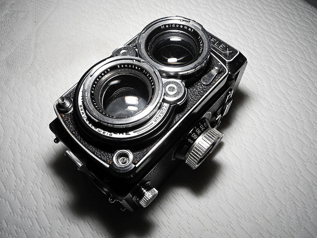

tcartpilot
Aug 23, 2012
8
Philomath,OR
Med. Format RF
I have this camera and have been using it quite often lately. Got it from my father after he passed and after a service have put several rolls through it (just a cleaning, not much ever seems to go wrong with these cameras)
It is a joy to use (although I wish the screen were brighter) and so much different than shooting an slr.
