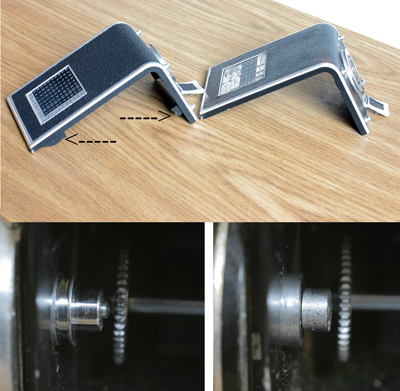

I am not sure they are compatible...
See on the picture , with two backs and , on the bottom , some of respective upper spool chamber .
They have a groove but are not strictly similar .
The earlier is on the left ; there is a groove on the spool knob : so , it's possible to close correctly with the back (and in fact the two backs) .
The older back on the right fits the earlier Automat , K4B or MX-EVS ; Automat spool knob has not groove : because of that , it's difficult to close with the new back without damage...
I don't know if it's easy to find now the right older back , but it's possible to cut the two disturbing pieces of an earlier one .

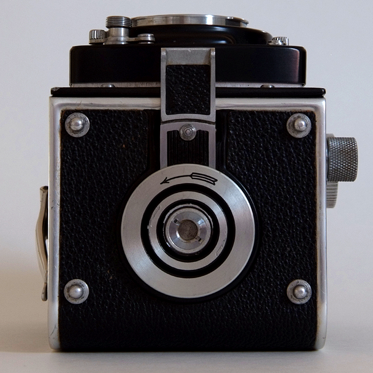

Hm, I'm coming late to the thread, but it was disciussed here as well: http://photo.net/medium-format-photography-forum/00VRQd and the suggestion is that Automat MX models could be compatible with Rolleifix. It seemed that it was introduced either with or early on in the lifespan of this model. So it depend son the Automat version (which is labelled in oh so many ways).

^ You're correct. I had an MX Automat serial nr. 1405072, a late sample made toward the end of the run in 1954. It took a Rolleifix and I used it on a ballhead with an Arca-Swiss type QR system. The attachment shows the bottom of this camera.
