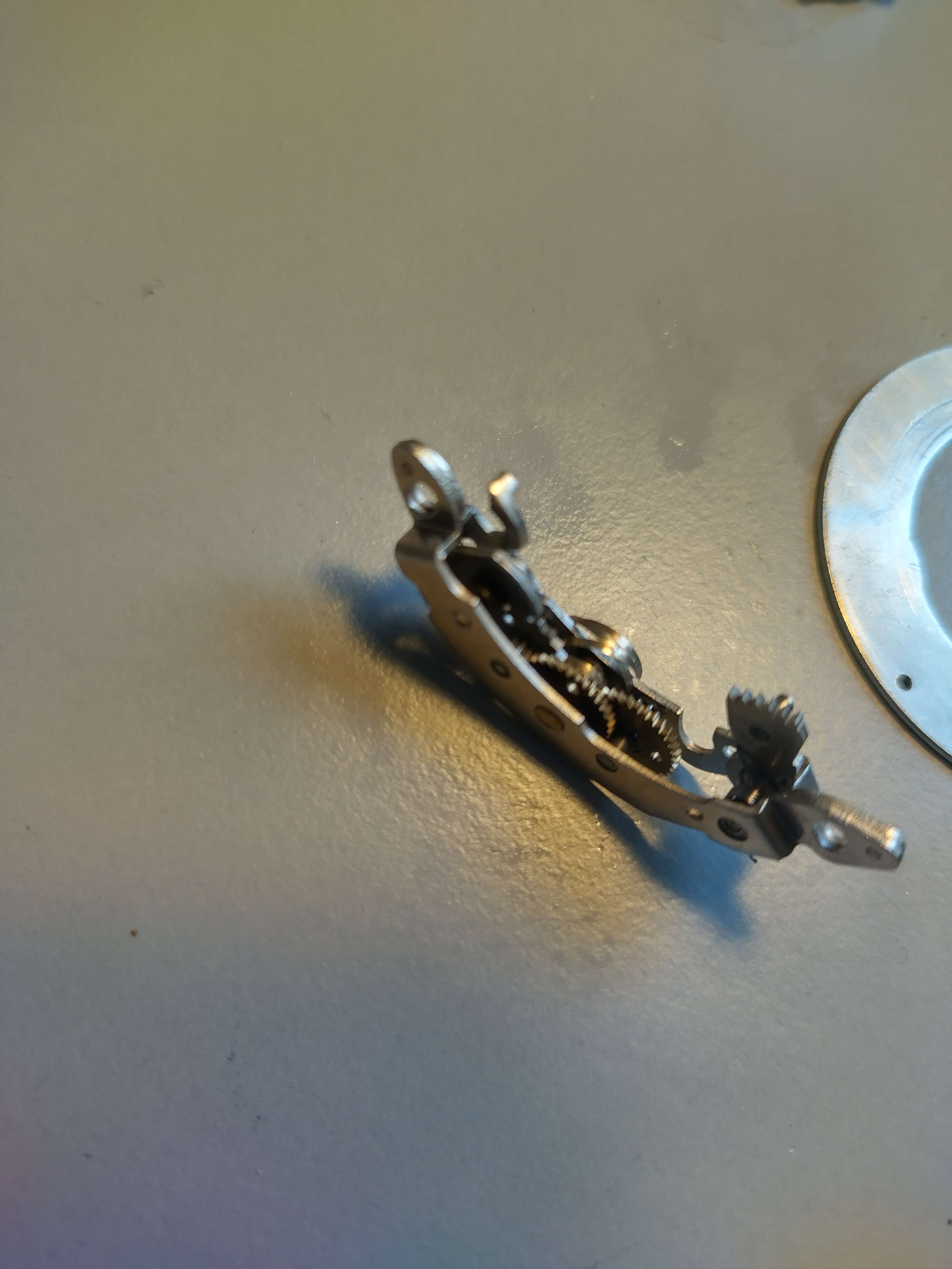

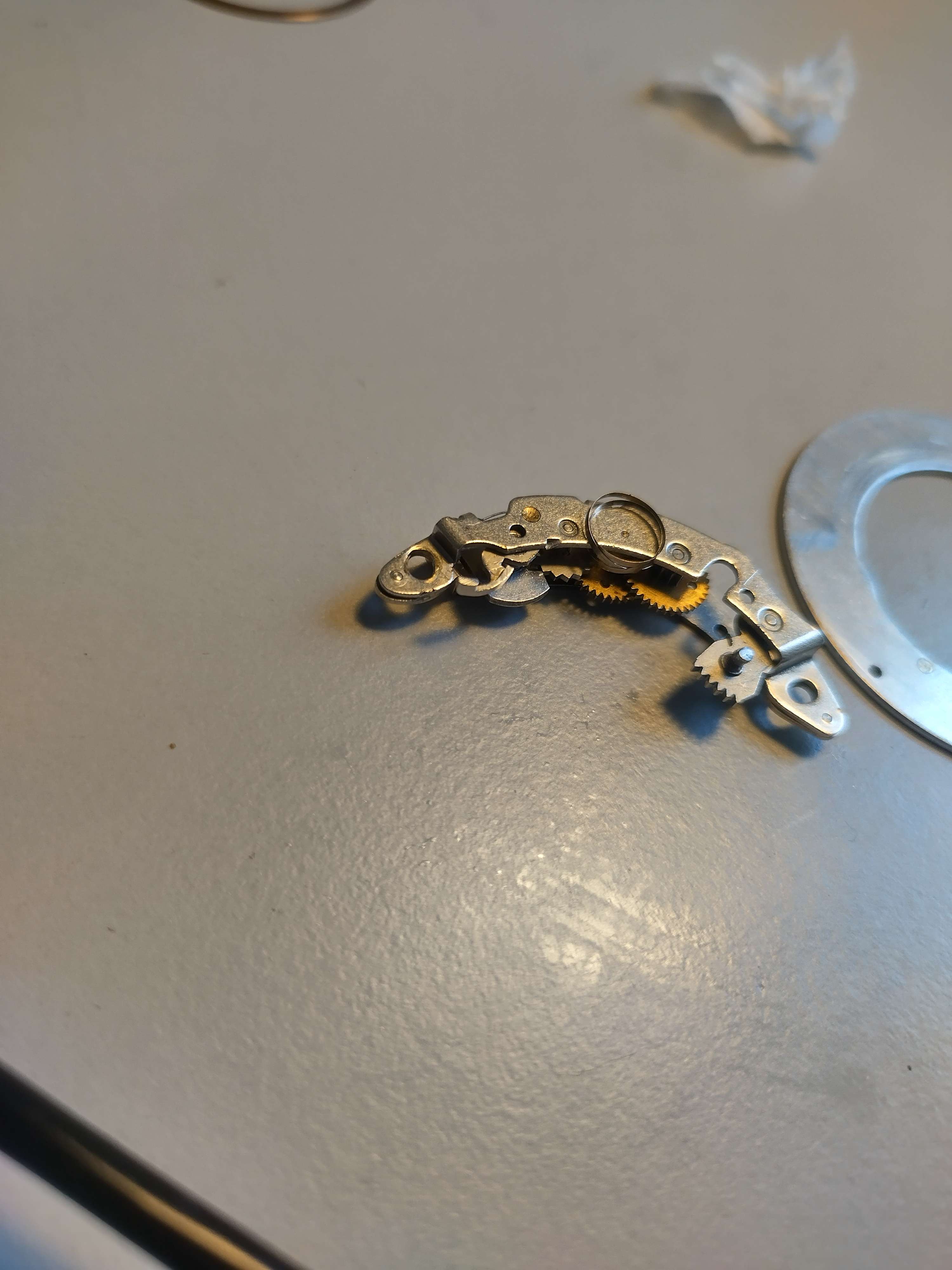

My skimping out on cleaning the shutter blades ended up leaving me with a frozen shutter, so back apart it goes, cleaned the blades, etc, etc, everything operates great, actually bothered to buy latex gloves to avoid getting me fingy oils over everything. Now the issue is this: had taken the timing system out to clean and lubricate it, since it was sticking randomly at only one speed and that seemed weird asf, and whilst releasing it, to get a better look at the gears and see if there was anything stuck in it, the spring totally unwound itself, image attached below. Am I effed here? should I order a for parts rollei online and grab the timer out of that one? is it worth that or should I buy a working one off ebay, there only like 75-100 more than for parts rolleis it seems.

update: what does this spring even do? I've struggled to find any repair documentation for a shutter that matches the one I have, it appears to be a similar shutter to the one @dxqcanada posted, although it's lacking any numerical markings on the speed selector. Regardless, the shutter appears to still fire with the coil spring removed. is this coil spring related to the accuracy of the high speed shutter?

Is that spring actually disconnected at both ends? I wonder if it simply unwound far enough to be comepletely loose, flipped outside of the mechanism, and took on a new home. On the back of the case is a pin with a slot in the middle and one end of the spring sits in there when properly assembled. See what happens if you roll the brass gear on the right end, if the spring uncoils, and if it can be guided back under the top plate?
OK, remember, I am working off of two photos that don't really show what is needed.
Yes, it was tangled in all the gears, I figured it'd be best to fully remove it before I attempt to put it back on.
I think it may have already been disconnected, because my high speed shutter is giving near identical results to what it did before, 100th of a second = ~1/25-1/30th, 250th of a second = ~1/60th-1/80th
I think someone before me tried to work on the shutter and somehow did an even worse job than me.
it was undone on both sides, over the top of the mechanism. I'm not sure how or why, but I'm starting to think, that maybe, for once, it wasn't my fault.
To be honest, I may try and get the 500th second timer working, and continue on using it in the current state. my low speed timings are good enough for everything, and I do a lot of long exposure work anyways.
considered sending it off to the guy in germany who runs the magicflex website, but to be honest, I don't have a thousand euros, I don't even have a few hundred that nippon in NYC would likely charge me, which is why i'm doin this myself.

Did you take the escapement apart or did the spring wind out when the retard lever pulled outward?
I don't even know how to take the escapement apart. It just kinda flew out when I released the lever.

this report isn’t very hopeful about putting Humpty back together again
I think it's referencing the other spring? I'm still pretty confused as to the function of the coil spring that popped out on mine, since all my timings are identical to previous, it's either been unhooked since I came into possession of this camera (I have no clue about its history), or the spring does nothing

You should be able to pull the spring and wind it back ... possibly.
I agree, as my old style Hasselblad 50mm C T* shutter escapement has a small gear with a tiny ribbon spring that when the escapement exploded because I removed one screw too many, became partially unwound.
One afternoon, just going over the bits to reassemble it, I practiced rewinding the, bronze, I think, spring and found that it can be done, but be careful, that ribbon o metal is very thin and allowing it to unroll completely can cause the thing to "knife jack" somewhat, back on irs self, as mine did, near the winding gear connection.
If the cash was plentiful, for both of us, I'd suggest you just buy a working shutter escapement that simply installs as a plain, single unit.
I've not yet fixed my 50mm CT* lens because I bought an older 150mm chrome lens out of Japan and it turns out the seller sent, to my eyes, a really nice lens, almost as nice, in my opinion, as my clean CF T*, in that focal length and I'm still trying to find a disabled lens of the 50mm shutter type that can be practiced on, and cleaned up, swapping out the two shutter escapement.
I really hate the idea of putting that spare 150 under the driver, as it seems perfect in my esteem.
Perhaps you have some kit or other collectable items to sell or trade for a correct escapement ready to be installed, which you've forgotten about?
Good luck, just keep at it and nevermind taking it apart and reassembling several times, thats how I learned to tune a four barrel carb on a old car I had, repeating everything time and time again.
One last thing, others might scoff at this, but practice disassembling and reassembling and installing that and other groups, by moving quite slowly in and out of every step, just so you begin to develop some 'Muscle Memory, and can one day do it quicker but very accurately.
