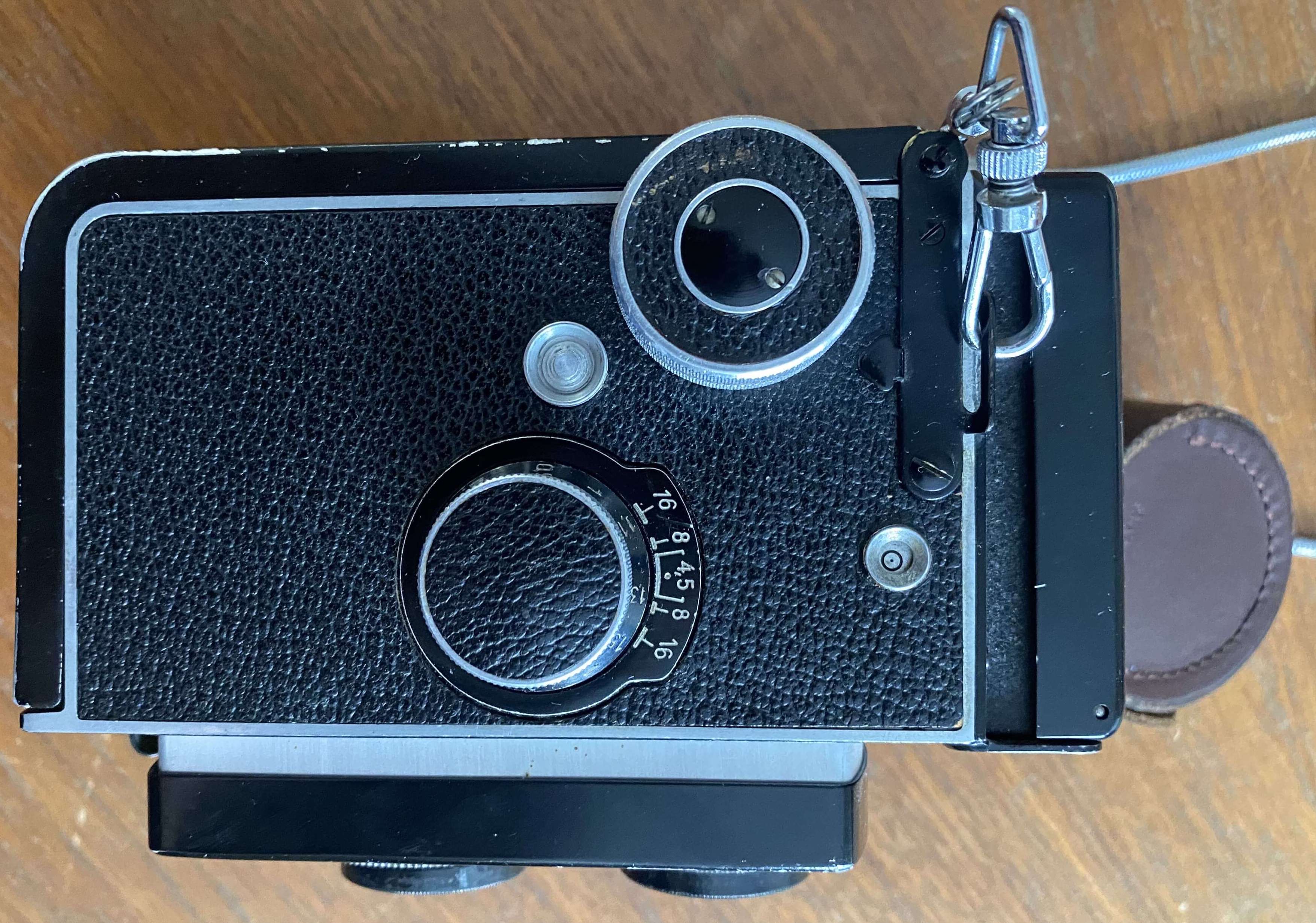

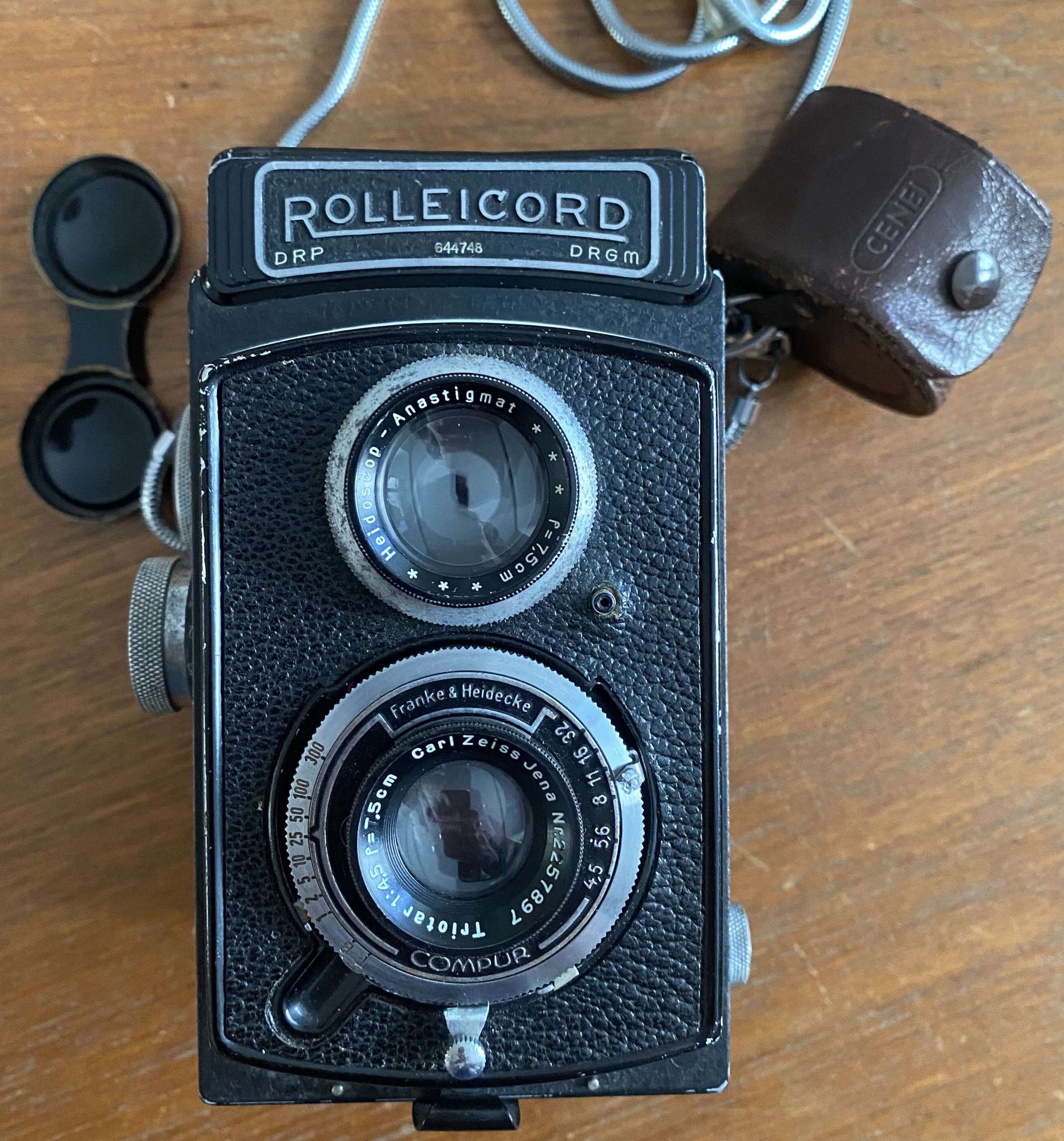

Hello,
I received this beautiful Rolleicord from my father. He himself seems to have used it only once and unfortunately cannot help me with any information. A preliminary question, as I couldn't figure it out... Does anyone know which model this is?
Now, onto my main question 😅 After what felt like hours on YouTube, I figured out how to load the film. It was mentioned that the film transport wheel needs to be turned 6 1/2 rotations. After that, the numbers should be displayed, and you can start taking pictures. However, the numbers on mine didn't seem to change at all. Is there a specific number of rotations for the film transport so that I know I'm in the next frame, similar to the 6 1/2 rotations?
Before I waste another expensive roll of film (I've already "shot" one randomly) or possibly never use the camera again, I thought I'd ask for some advice :smile: I would also appreciate any tips, manuals, etc., as I've never used a medium-format camera, let alone one of this age!
Best regards, Moritz

Moritz! It’s a Rolleicord “Ia Model 3.” Read the Rolleicord II manual linked in Brian’s post — it has the same film loading/advance system. Basically, you advance the film until you see the number one in the red window on the bottom, then pull down on the little silver button next to the focusing knob, while also pushing in the big black button in the middle of the film winding knob — that resets and engages the film counter. It’s not obvious but once you read the instructions, it is easy.

And after you have set the counter to (1), thereafter when you have taken a photo you press the button on the winding knob to free it and wind until it stops at the next frame, and so on.
The silvery aluminium button if only used when you reset the counter for the first frame.
I see that a previous owner has had a flash contact added, which could be useful.
I have this model and I really like the Triotar lens.
