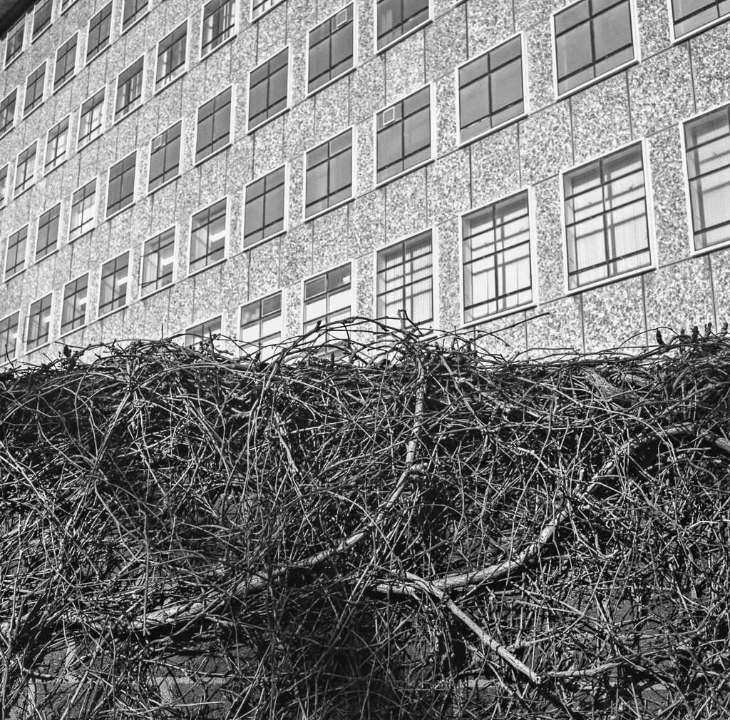

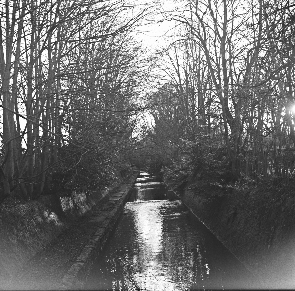

Couple of test rolls through a Rolleicord III and it appears I have an intermittent light leak. Can't see anything obvious on the back cover, and most of the time it's living in the leather ever ready case
And an image without the leak
Thoughts ? Any idea where I should be looking ?

The leak is toward the top of the camera, because it shows toward the bottom of the image.
