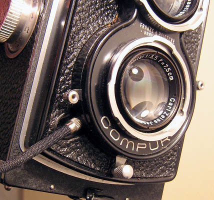

There are no II a, b, c and d models. The letters are something an author to a collector's book came up with. On Rolleiclub's page they call the Rolleicord II, type 4 "IIc" so it's my guess that you mean that model. The only Rolleicords with letters are the Ia, Va and Vb.
Yes, you can use a cable release with all Rolleicords and Rolleiflexes, but find an early one with a small "head" for this early model. The cable release socket is a bit sunk on the front so modern cable releases with their big "heads" are impossible to use. If you have this old style of cable release it doesn't matter which Rollei TLR you use, but if you want a Rolleicord that can use modern cable releases, get a Rolleicord III, IV, V, Va or Vb.
https://www.flickr.com/photos/19332145@N00/2761237970/
This is my Rolleicord II, type 4.

Thanks for replying and taking the time to post a picture where the cable attached .
It's true a pictures worth a thousand words .
Looking at your picture I can clearly see the dished out recess for the cable release .
It's clear to see that on the listing of the one I'm looking at .
It's a dark picture , being all black , but with a bit of eye of faith I think I can see the socket too .

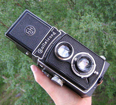

Report back when you get it. I hope the cable releases will work. It's also a fun camera to use hand held, of course. This was my first Rolleicord, and I bought it in almost mint condition in 1990. I've bought more since then, but this one I will keep for the rest of my life. :smile:
And maybe this:
https://www.flickr.com/photos/19332145@N00/4971557849/
That's the first Rolleicord II from 1936. The owner had bought it new and took great care of it. I also got his accessories and books "Das Rolleiflex Buch"(1936) and "Die Rolleicord Fibel" (1940). :happy:
