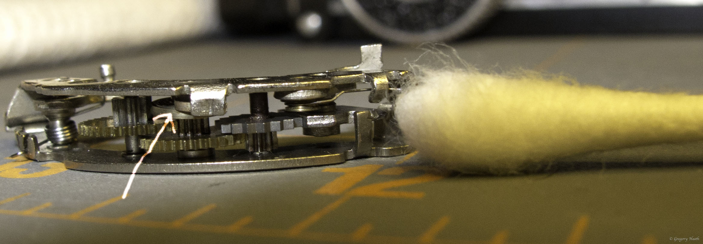

Here is the Shutter timing Escapement. The spring is definately broken. I might try to rewind it and super glue it to the Outside Holder. The original was secured on the inside of the escapement. The little indentation on the outside of the clip is where the worker pinched the metal. I will secure it to that point. That white bunch of cotton on the right, its the head of a Q-Tip. I love working over a magnifying glass :D

Regarding glue, check out this site that someone posted in another group that I hang out in:
The guys that run it are hilarious (but know their stuff, too!)
Ed
Greg Heath
Greg Heath
Jul 13, 2008
591
Racine, Wisc
Thanks for the link. I will try to JB Weld. I have used it before. I will have to file the part before connection. I have also been looking for an extra escapment. Seems like prices for parts cameras have jumped over the past few years. Seems that "parts" cameras are collectible now too ! The shutter might be slightly off in speed but pretty close. I think thats all i can hope for. Even a new old escapement could also be off slightly. Even with the spring broken, the shutter still fires at the higher speeds.

I take those escapements apart to clean them in my Bessamatics and that spring is retained by inserting the free end into a slot on the capstan.Your shutter is larger than mine I think but that is what I expect to see when I reassemble them.The capstan is split from the top down on my cameras.Ron G

I appreciate the info. I might give it a go tonight. Gluing it would definitely be a kludge to say the least. I need a better magnification to see the part. I work through a magnified fluorescent circular magnifier but need something better. What do you use. Greg
