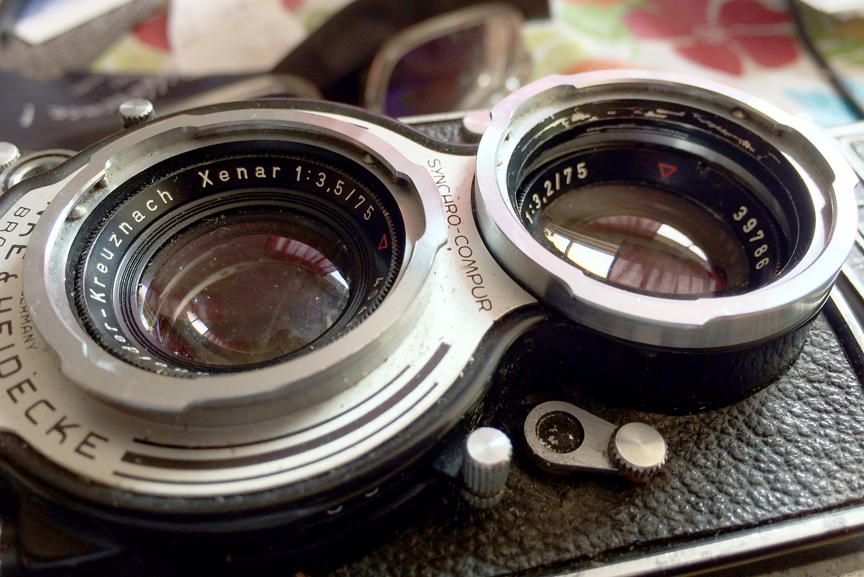

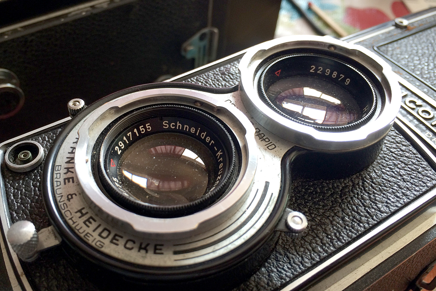

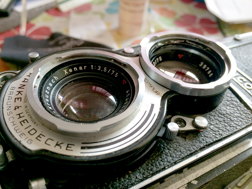

A normal looking set of lenses on a 'cord, and the 'cord in question. The 'cord with problems has the 'recessed' lens set.

Ian Grant
Aug 2, 2004
23,271
West Midland
Looks tampered with, hard to tell in the photo but it looks like the covering has been lifted, also some marks on the internal housing above the red coated symbol on the viewing lens. I think the lens is set too far back hence Infinity focus when the focus knob is set to 5.5 ft.

Ian Grant
Aug 2, 2004
23,271
West Midland
There were only two images in the post when I last replied, the third image clearly shows the covering has been removed, as above it should be a simple fix. The previous owner didn't know how to reset the focus.
