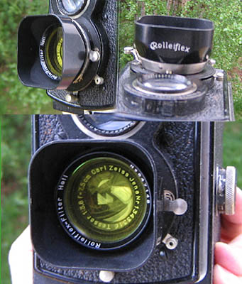

Sweden
The Rolleicord Ia takes 28,5 mm push-on filters and shade. The Rolleiflex branded push-on filters from the period are perhaps not the best, since they are uncoated and meant to fit inside a special clamp-on sun shade like this:
