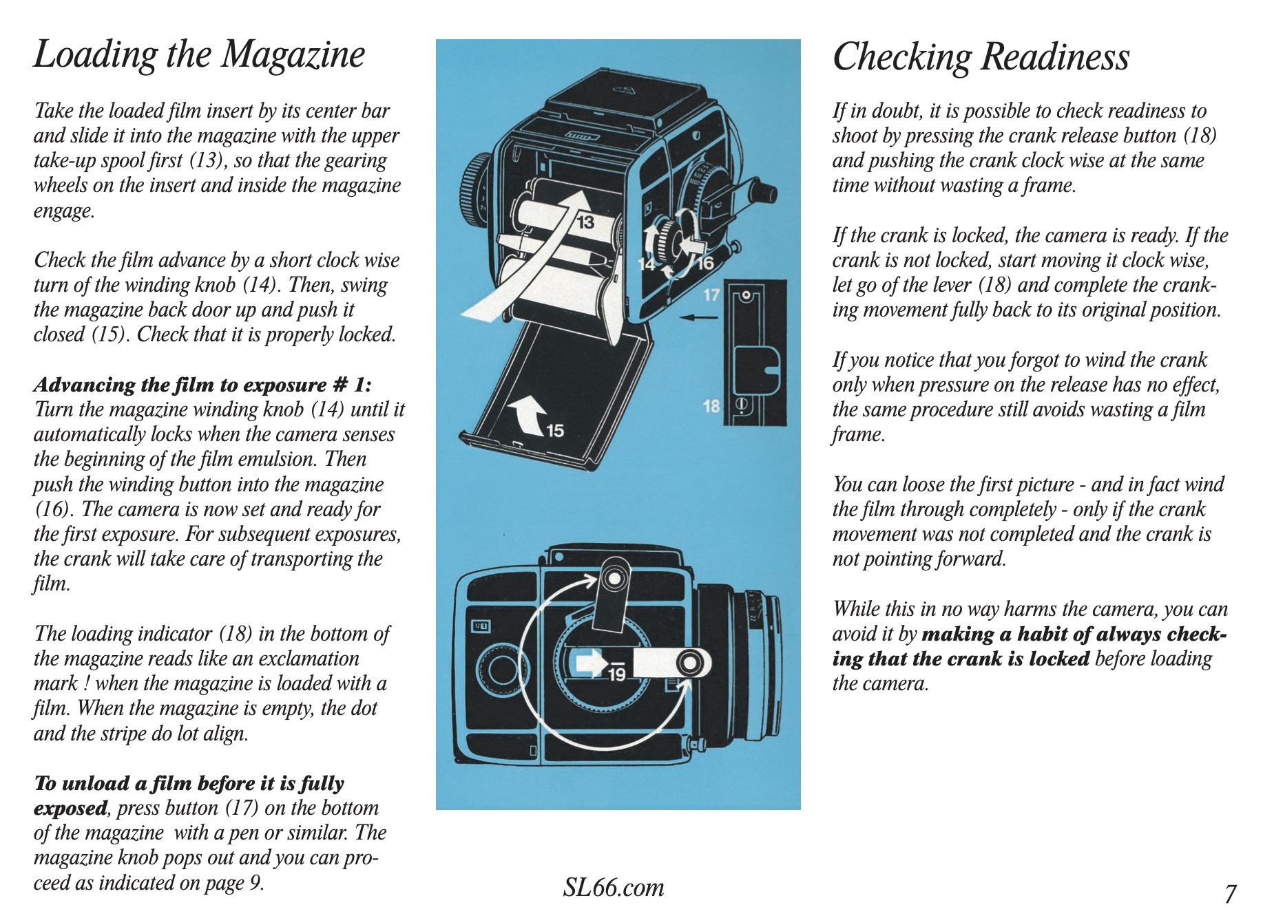

I don't know about the E, but I have read the manual for the SL66 and it seems to have a rather complicated process involving the winding crank position when loading film. Not doing it correctly can lead to wasting a frame.
