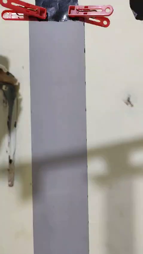

So I just finished a Fomapan 100 and send it to a lab. The lab technician told me the negative is mostly blank.
Except 5 images, but they were kinda overlapped each other.
Wonder what's the cause... faulty film back?

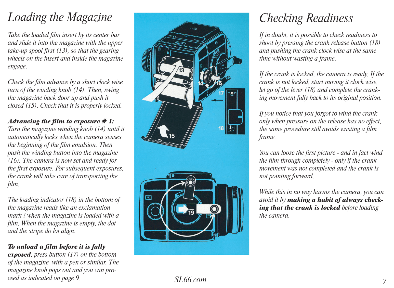

Hi. Sorry for the late reply. Now my film back is having issue: cannot advance the film if it's attached to the camera, so cannot repeat the film loading process.
From memory, something like this:
After frame 12 is finished, then keep keep cranking the film advance lever till you feel it's loose. Then magazine film knob (14) will pop out. Frame counter shows 1.
Replace the film, push the winding button (16) into the magazine. Since we are on frame counter, this means we are ready to shoot, right?
OK I think I miss this part: before pushing the winding button into magazine, turn the magazine winding knob (14) until it locks
This video illustrates that part (around 3:10)

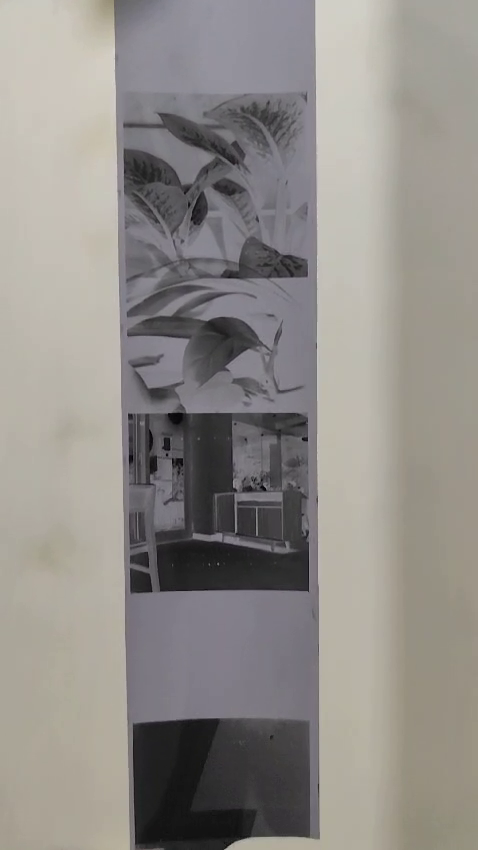

A few last frames.
This kind of explains the roll.
The Rollei magazine has a sensor that detects the start of the film by the extra thickness when it appears. You are suppose to wind the film forward until this is detected and the wind will stop with the 1st frame positioned at the start of the film. Since you did not do this, you started your 1st exposure on the leader, and it looks like sometime around the 8th exposure, the film made it to the film gate.
The film spacing is based on the rotation of the wind up spool, and as the film builds up on the spool, less of a rotation is needed. This is built in to the magazine, it rotates the spool a certain amount at the 1st frame, and less on each frame as the spool builds up. Because you started on the leader, the spool is smaller, so the amount of rotation does not move the film enough for a full frame. This carries on to the last frame, as you are always behind, hence the over-lapped frames through out the roll. I'm speculating that the 9th frame was blank, and hence you have a gap that is smaller than a frame?
