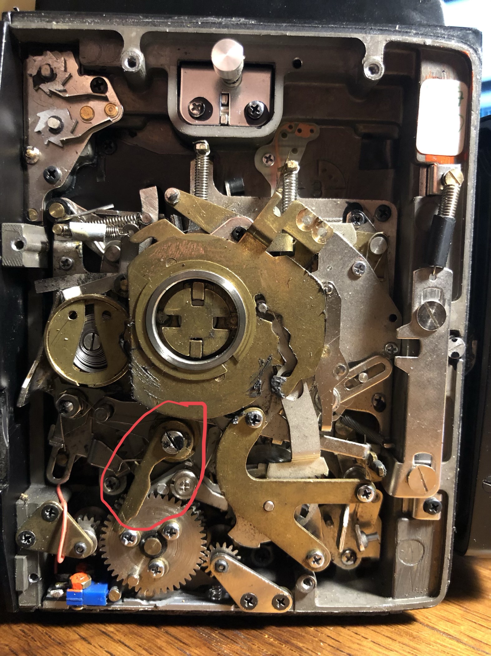

Hi Guys
I've been encounter the same problem with the mirror up & jam shutter. Once the mirror is lifted , you cannot rewind. So i decided to open up my SL66 so see how it works. Eventually, with my SL66's problem, it is very easy to fix .
One of the screw which in-place the mirror up trigger is loosen. All i have to do is tighten that screw, then the problem is solved.
I hope this is helpful for SL66 user. Enjoy
