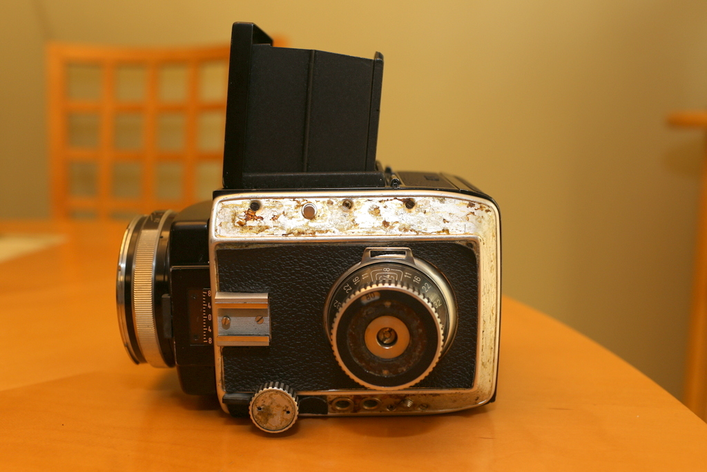

This came with a couple of boxes non working cameras and lenses which could from a camera repair person. All the functions appear to be working so I decided to put a roll through it. The film is drying but some of the negatives look pretty good with the exception of about 6 shots I screwed up. I will scan them after drying and see what you think. I have it up on ebay right now as for parts or non working but I may pull the ad and maybe have the leatherette replaced and use it myself. IMG_5745.JPG IMG_5747.JPG IMG_5749.JPG IMG_5752.JPG IMG_5753.jpg

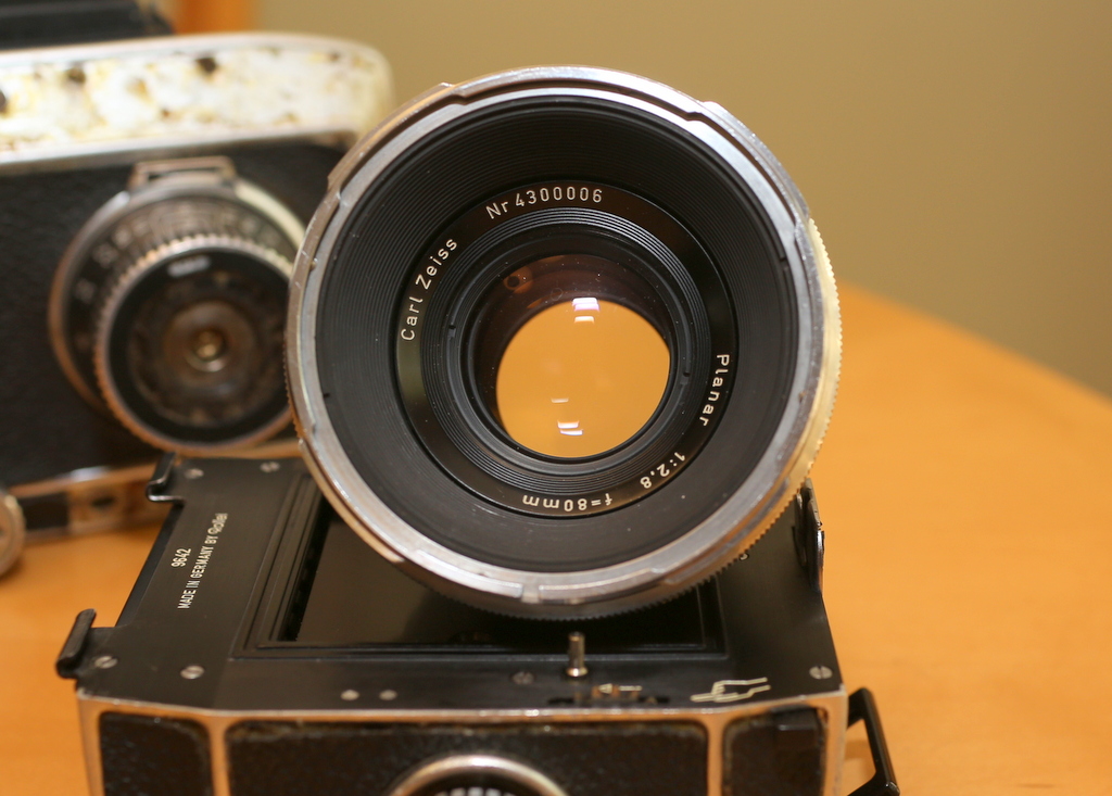

I wasn't expecting this to work at all so I am pleased it does. Anyone know how the front elements comes out? The ring around the rear element is dented so there is no way of taking the rear element out and I wanted to clean it from the front.

The Zeiss Planar f2.8 was made in several versions, 3 6glass versions and a 7 glass version.
Looking at your pictures there are spanner slots in the innermost ring of the front but taking out the front elements may not get you the access you want. On the rear is a ring with 4 screws. I would remove the screws and lift the ring off as it may release the rear lens group from the assembly. Those bends in the rear outer rim should be easy to straighten also.

Once you have put a new set of leatherette on the camera, this will be a fine machine. I can see no damage to the camera´s "structural" parts on any of these pictures. Is the focus going continuously smooth? (Mind however, it´s never as smooth as with the TLRs).
The focusing hesitates a little when focusing but doesn't seem to be mechanically binding. I think it's the grease being old and dirty.
