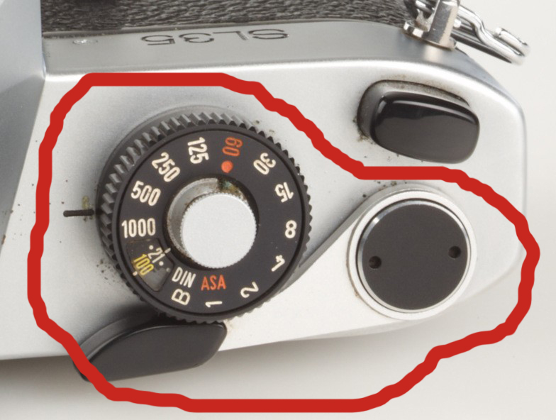

Someone could help me?
I'm a few days trying to disassemble my Rolleiflex SL35, but I can not remove the top plate, because you need to first remove the handle from the movie and do not know how to do this, I've tried a few forums about this case, the majority says to unscrew one piece of metal but it is very tight and I can not take it and I'm afraid of scratching the metal foil. If someone could tell me in detail how to remove this piece without creating damage, very grateful, as I am for days trying to remove the piece. Thank you.

Hello elekm
My SL35 says: "Made by Rollei Singapore", bought it in Switzerland, there is a difference between the SL35 made ​​in Singapore and made ​​in Germany? Well anyway I still desperate because I still do not know how to remove the handle film. This handle has a metal cap with two holes, I tried turning it counter-clockwise (as some forums suggest) but I could not ...
Or is too tight, or not as I am doing. Sometimes it makes me want to run even harder, but I'm afraid that the tool I'm using, eventually damaging the machine, do not even know what to do.

hello,
I apologize for not having explained myself properly. What I wanted to know is how to remove these two pieces surrounded the red in the following image: 19471_18_c.jpg

To remove that film advance/cocking lever you need a special tool with two tiny, fitting pins. You can either get such from supply companies as "Microtools" or make such yourself. Some people juse a divider caliper. I would not do so.
If you are really lucky a piece of rubber pressed on that screw would work too.
Keep in mind what has been said above on the possibility of a left-hand thread.

Hello, I apologize if I did not understand well what I want to know is how to remove these two pieces that are circled in red in the following image: 19471_18_c.jpg because without taking them I can not open the top plate of the machine. Thank you so much.
John Koehrer
Apr 3, 2004
8,277
Aurora, Il
A spanner if you're going to need it more than once.
Lever: A rubber jar opener or rubber stopper also works. You need to put the camera on a flat surface and use A LOT of pressure as you turn the rubber.
Shutter speed dial: 1, is there a soft touch, shutter release extender installed? If there is, it looks like a silver nut with two notches is beneath it. It's a standard thread.
It looks like it will definitely need a spanner.

There is a small slotted retaining ring around the shutter release. The soft release was original to the camera and unscrews normally.
There also is a similar slotted retaining ring around the rewind knob.
Not to be mean, but if you don't know what you're doing, be careful. And take plenty of photos along the way.
Otherwise, you can end up with a table full of parts.
