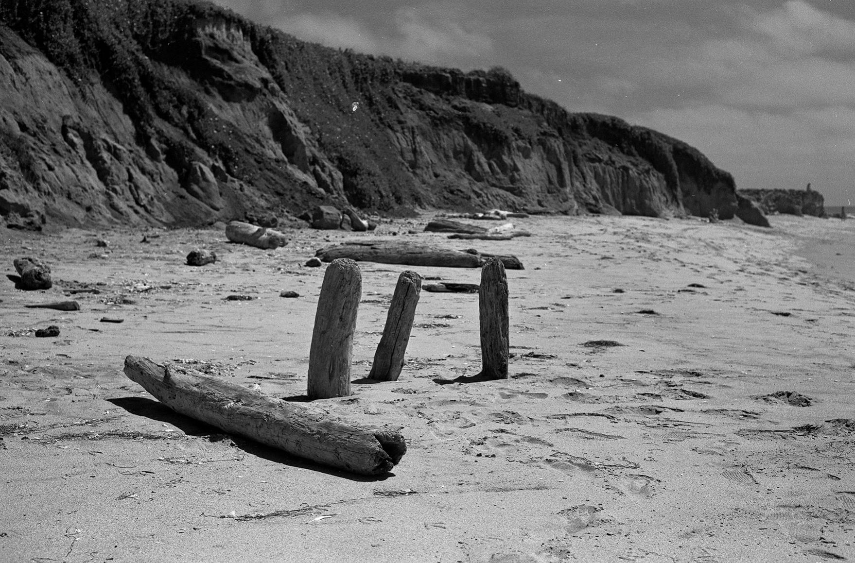

not sure if the neofin is the same formula, but I use:
Part A:
1000 ml water
10 g metol
50 g sodium sulphite
Part B:
1000 ml water
50 g sodium carbonate
mixture depends on the film, but for RR80's (and 400s) I use 1+1+8 at 68 degrees (20c) for 10 min. I also did a roll shot at 50, developed for 5 min at 72 degrees. I try to keep my dev times above 8 min but wanted to see the results using beutler shot at 50. I guessed on the time and it seems pretty close. I agitate initially for 1 minute then 2 slow inversions every minute. I have gone to agitation every two minute in high contrast scenes as well but have yet to see any major differences in results.
Here is the shot at 100, developed 1+1+8 for 10 min RR80s shot at 100
attachment.php
here is an example of RR80s shot at 50 developed beutler 1+1+8 for 5 min at 72 degrees
attachment.php
I have yet to enlarge the negs though as I have to wait till october. I'm doing my best to save water in this terrible drought, so I only wet print every 4 months for three weeks at a go. love dark room marathons!

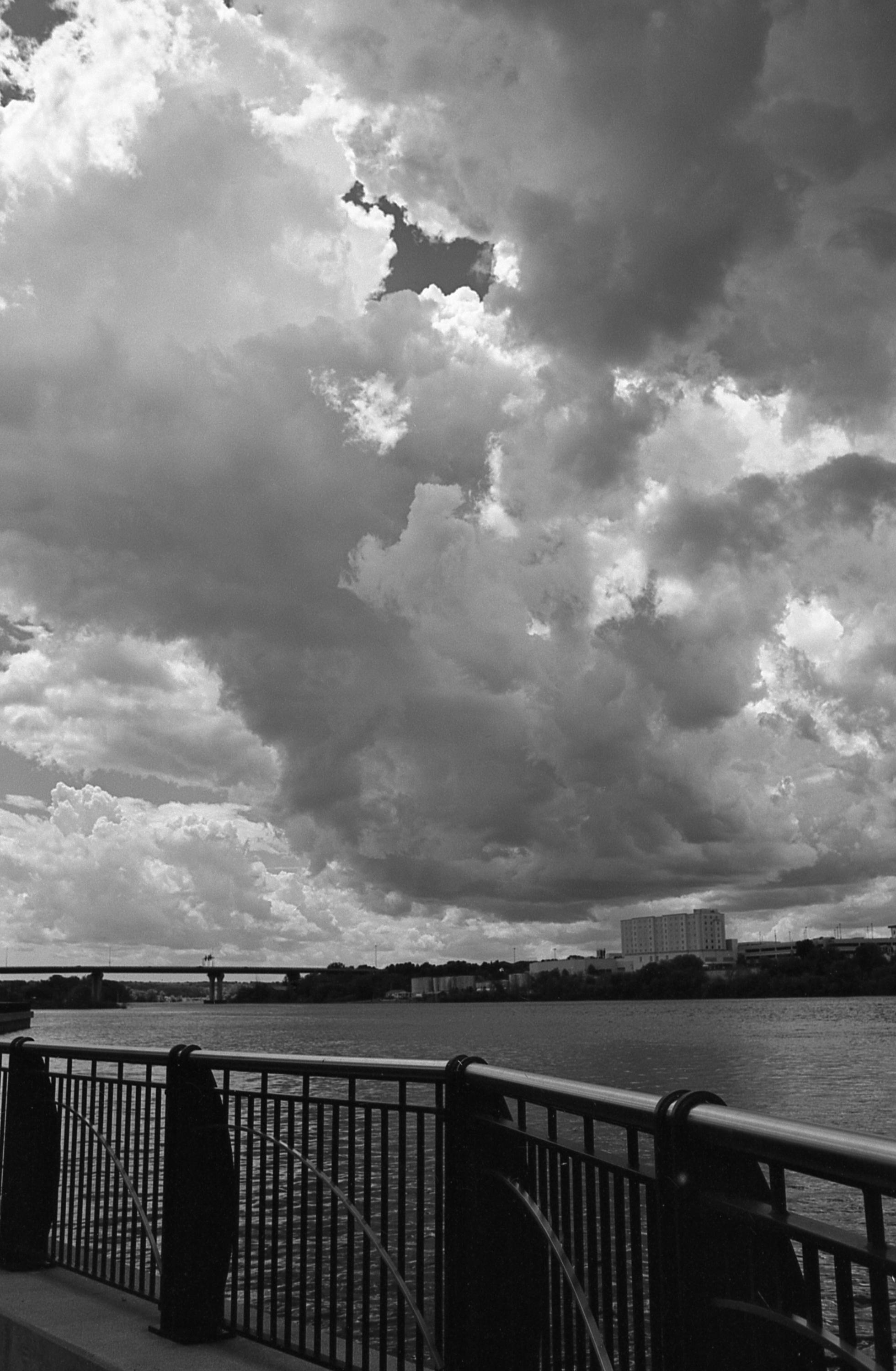

Rollei Retro 80s is a very finicky film, the previous post stating that it should be treated like slide film is correct. I use it mostly in 120 when it's overcast, but I took this shot with an orange filter on 35mm wide angle lens with my Pentax MX, processed with Rodinal 1:50. With more contrasty conditions, stand development with Rodinal 1:100 does seem to tame the contrast a bit, but I generally use Rodinal 1:50 when it's overcast.
