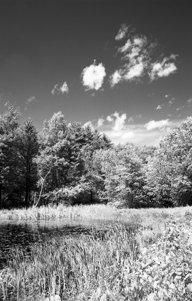

I shot this on Retro 80S with a 25A filter, I think rated around ISO 12. You do get some wood of the "Wood effect," but next time I'm gonna try using my new Hoya R72 which should definitely make it more pronounced.
Shooting this film unfiltered seems similar to shooting a normal film with a 25A filter. Skin tones are very light and smooth. Anyone planning on using this film for portraits should be aware of this; for male portraits especially it might be good to use a light blue filter. I need to experiment more.
Also, it's very easy to blow the highlights with this film. I rated the unfiltered film at 50 in D76 1+1, but I would have been better off rating it at box speed.

The Wood effect looks fairly pronounced to me even with a #25A filter. I didn't know that Rollei Retro 80s has very narrow exposure latitude but I researched it and sure enough, it does.
