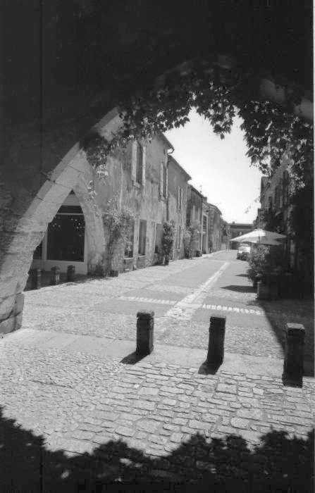

I found the contrast a bit more than I like so now use a mix of HC-110 1ml + Rodinal 1ml in 250 ml water as a stand developer at box speed.

I found the contrast a bit more than I like so now use a mix of HC-110 1ml + Rodinal 1ml in 250 ml water as a stand developer at box speed. View attachment 168475
Looks good, but I'm not sure how much detail the shadows have. There are some compression artifacts at the shadow at the top of the arch, but there's probably some reasonable shadow detail at the negative.

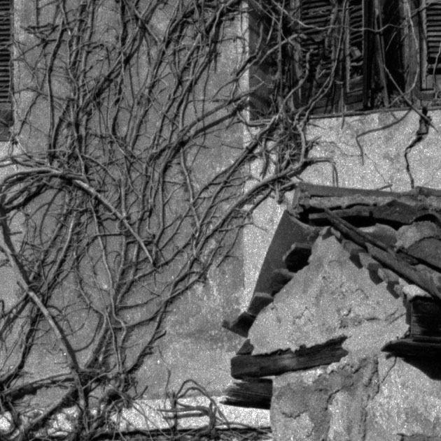

Well, in case anyone's interested, here's a sample (scans) of the processed film, Rollei Retro 80S in homebrew Perceptol 1+3, 16', 20°C, shot at EI25:
And a 100% crop from this photo:
