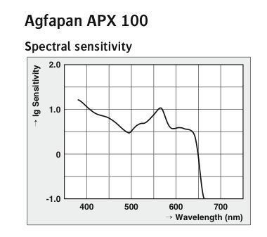

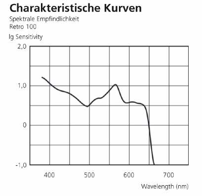

I still have to develop my first roll of Retro 100 to compare it with APX 100, but I must point out the following detail: these two films have seriously identical spectral sensitivity curves. Looks almost like a cut-and-paste.
I will leave it to the engineers among us to tell us whether it is probable that two different films have such matched spectral curves. Given that spectral curve is very important in a film's "signature", I suppose it would make sense if this were an APX100 emulsion that was coated by someone else than AGFA, hence the noted lack of AH dyes and curling.

Yes, that is my conjecture. Anyone has data to infirm/confirm it? I'm simply basing this idea on the spectral sensitivity curve.
