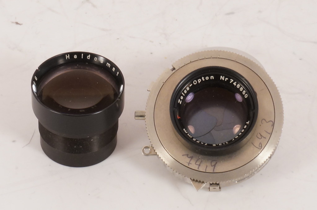

OK, first up. I have two sets like this. Lens and shutters and what looks like a matching viewing lens. Tessar, Zeiss-Opton, 75mm f3.5. these are very clean, I'd say unused and all speeds seem to work.

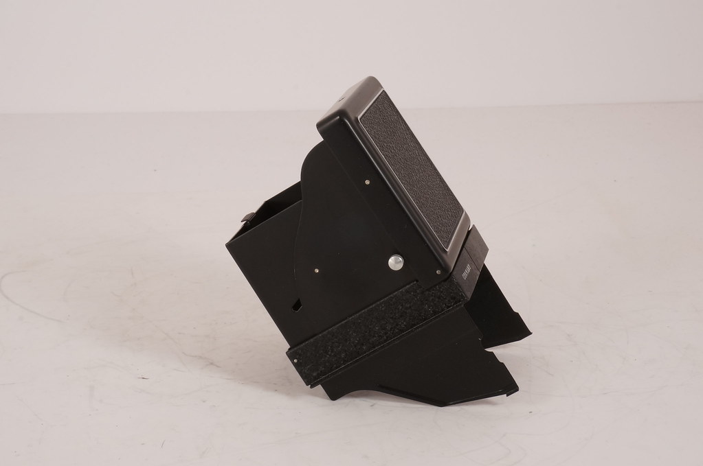

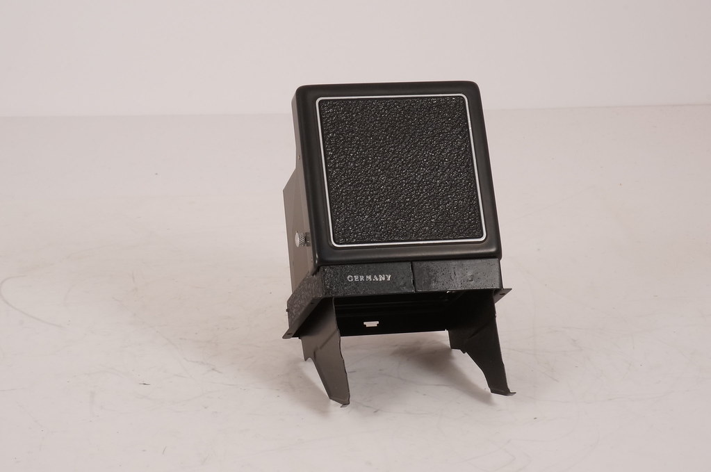

And these hoods too. Couple of these, looking like new. These have a side lever to flip up the internal mirror for eye level viewing. No logos but made in Germny. Are these Rollei parts?
AgX
Apr 5, 2007
29,973
Germany

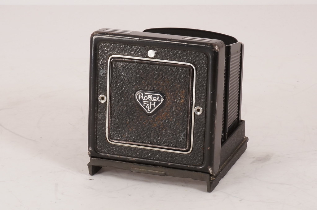

"No logos but "Germany". Are these Rollei parts?"
This viewing hood seems to have the same stamp print as your back.
Jul 20, 2010
884
Iowa
Replacement hoods for the K4 Automats. K4B, K4B2, or K4/50
Again, K4B, K4B2, or K4/50. I'm not sure if the Opton lenses were on any of the MX or MX-EVS cameras

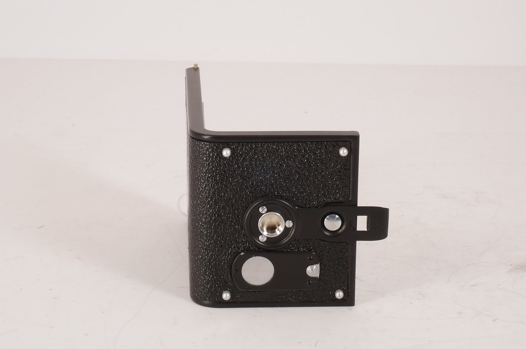

These are Rolleicord backs from the early I series.
Really? I'll have to admit that I haven't looked at mine for a while now but just pulled it out of its case to look. Yep, seems the same. I have a 1b/3. I really didn't remember that my camera had the exposure guide on the back, but its pretty much always in its leather case. Thanks, I guess I now have a spare back! :smile:

They're not for the Rolleicord V. None of the Rolleicords had a rear focus eyepiece, only a sports finder, and the side plates were rigid not hinged. Looks more like a finder for a later Flex, maybe E, F or T perhaps?
Harry Stevens
Dec 18, 2014
424
East Midland
It may be interchangeable between the flex and the cord as in the Youtube video 0.29sec to 1.29 in.
Jul 20, 2010
884
Iowa
You are right about the rear focus, but the removable viewfinder on the V does have hinged side plates. But yes, most likely for a type 2 or 3 E, or for an F or T.
It should fit and work well, but it's actually for the Rolleicord II since the exposure table goes from 3,5. :wink: The first series had 4,5 or 3,8 lenses. But all the Rolleicord I, Ia and II models need the red window on the bottom. Not sure what you mean by 1b/3? Maybe a collectors book used names like that to differentiate between the models.

The first viewing hood fits all the pre-war Rolleiflex Automats, and the second one fits the 3,5 and 2,8 F, E2, E3 and T, plus the Rolleicord Vb. (I don't like to use the internal factory names like "K4" or whatever, since it's confusing).

...Not sure what you mean by 1b/3? Maybe a collectors book used names like that to differentiate between the models.
Typo on my part too. I looked again and according to the Rolleiclub.com site, its a Ia Model 3, or a K3. Like this, (but this one isn't mine)
JPD
Mar 24, 2007
2,156
Sweden
Ah, I have that one too. Nice sharp Triotar. I also have the special ordered version for the german police, but it's in bad shape.
