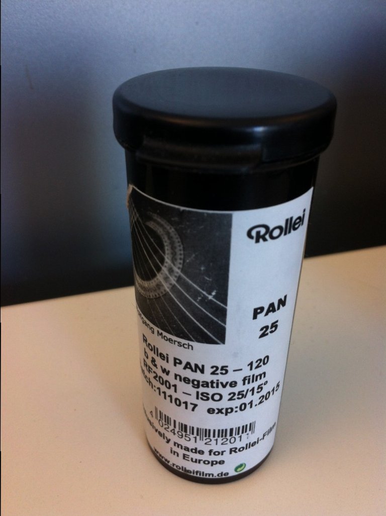

I have a few rolls of Rollei Pan 25/120 but don't know what developer to use. I've used D-76/Delta 100 for years but not sure if D-76 would be a good fit with the Rollei. I also have some Blazinol I've never tried (Rodinal replacement), and the Maco website suggests Rollei RLS which I don't have...

So Rodinal 1:50 it is ! I believe I have V2 - bought it recently from B&H :
