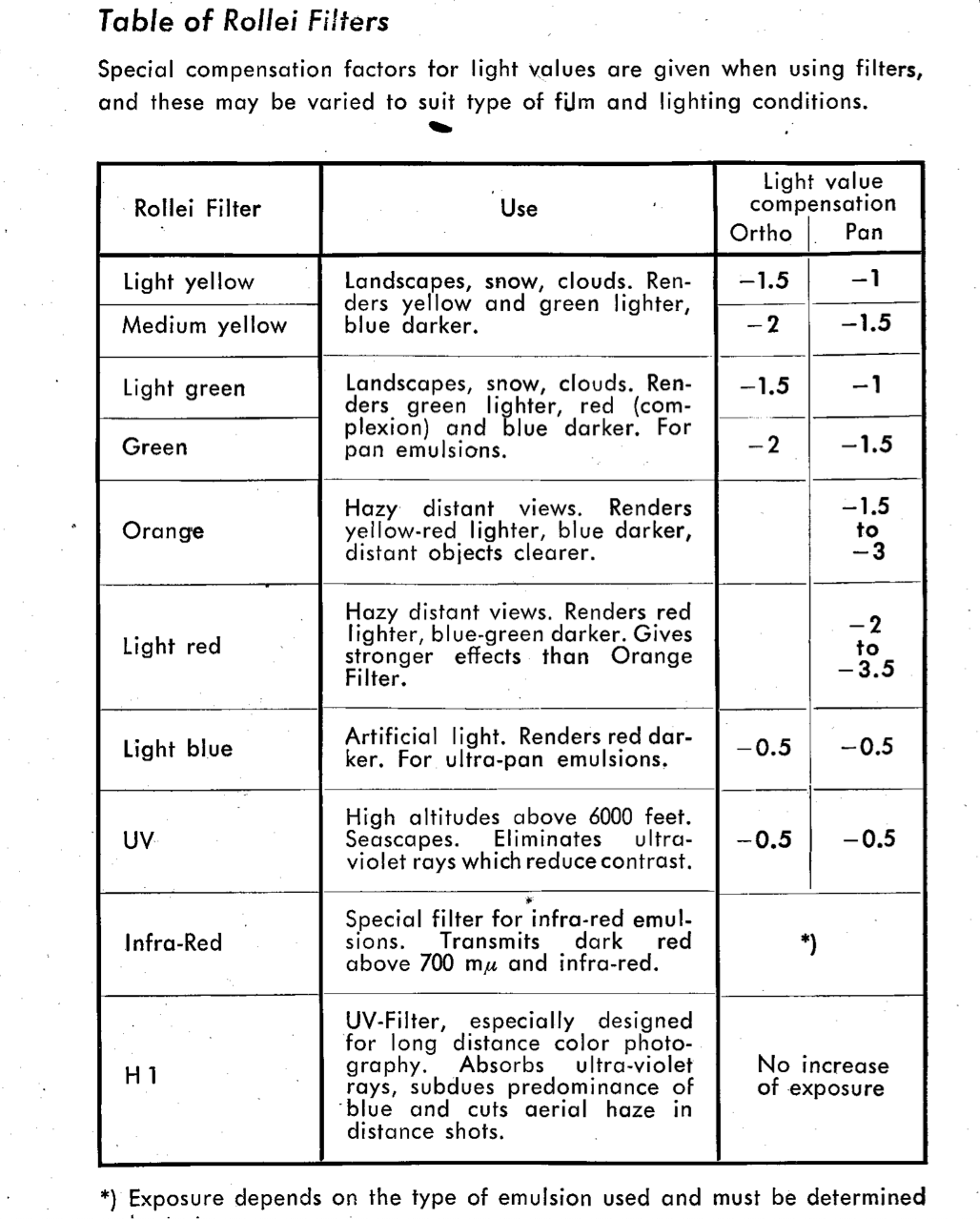

I'm confused with this. My Yellow and Green filters says 1.5 and Orange 1.5-3.
Looking at the ND filters chart, 1.5 density is 5 stops and 3.0 density is 10 stops.
I know it's not the same as ND because ND with density of 3.0 has almost completely black glass, but what's this measure then on color filters? It's confusing because it has the same numbers but the conversion is stops is totally different.

Color filter numbers are stops of compensation. So 1-1/2 stop more exposure for the Yellow and Green.
Always best to do tests on your actual filters and film stock combos.

Thanks Dan, it's clear now. I never used color filters, so I'll certainly have to test them asap.
At the same time, I found 1.8 and 3.0 ND filters in a dusty box, that I never used and wanted to give i a try, and I was a bit confused, why it has the same numbers and the compensation in stops is different. But now I get it.

No. On Rollei filters, the numbers are "Light value compensation." The easiest way to think of it is as a multiplying factor for the shutter speed. The first number is for Ortho film, the second for panchromatic. For example, medium yellow is 1.5× for Pan film. So that means about 1.5 times the exposure or about a half stop.
But do test your favorite film, developing technique, and your light meter.
-1.5 = A half stop for Orange?
-1 = No compensation for light yellow and light green?

It's confusing. I spent a lot of time trying to understand these numbers decades ago. I usually use the f-stops that mnemosyne recommended:
yellow +1 stop
orange + 2 stops
red + 3 stops
