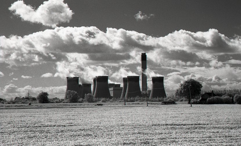

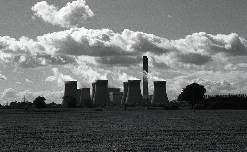

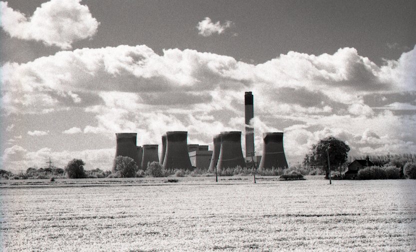

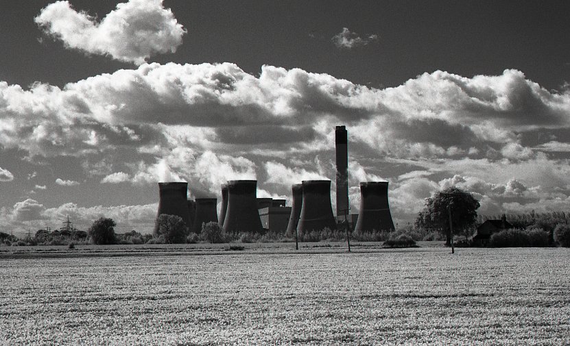

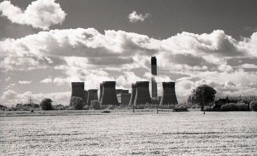

Here's the quick and dirty results, in order they are: ISO 400 unfiltered, then with an 89b rated at 12.5, 6, 3 and finally 1.5. They were all taken with Nikon FM, with 55mm micro Nikkor at a smidge under f16, exposures were sunny f16 for the unfiltered (the meter agreed with sunny f16), so at 1/500 for unfiltered then 1/15, 1/8, 1/4 and 1/2 with the filter on. My conclusions are that I underexposed for the unfiltered shot, but that the white foliage doesn't kick in till ISO 3 ish. The ISO 12 shot is pleasing but is not the wild infra-red effect that I used to get with Efke. The important thing is of course how they print up in the darkroom. The base is pretty thin, but they are nice clean negatives. In another set, the stone of the church which is in full sunlight was way overexposed at ISO 6.

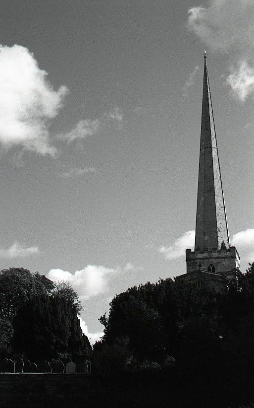

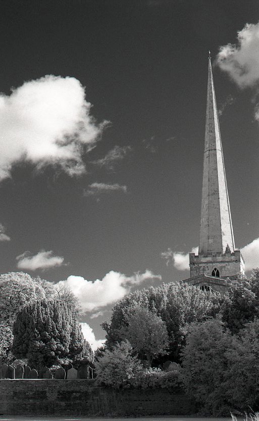

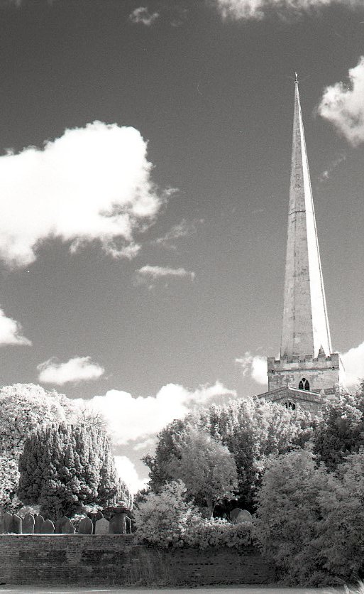

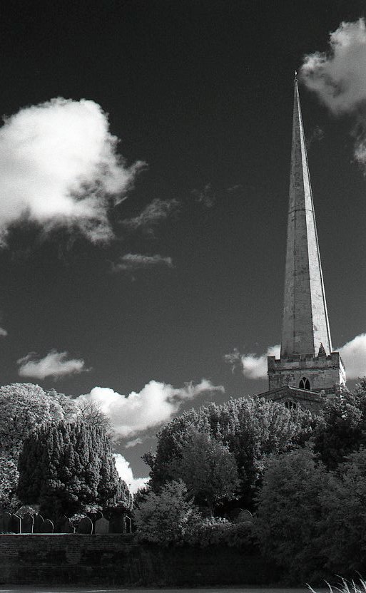

And another set, the sequence and exposures are as the last thread, unfiltered first at ISO 400, then rated at 12.5, 6. 3 and finally 1.5 with an 89b filter. Nikon FM with Tamron 90mm at f16, shutter speed varied.

Looking at them here, if you adjusted the above scans to the same value in the sky I wonder if there would be much difference in the white trees, I am not sure that relative exposure should have much effect on that. Exposure would effect shadow detail and/or highlight blow-out, but I would expect the IR effects to be the same on a relative basis. Of course I suppose IR illuminated foliage is potentially the highest brightness value in some cases.
With the classic IR films of yore, a significant percentage of the exposure was coming from outside the visible spectrum, regardless of subtle differences in filter cutoff, but films like the IR400 miss a great deal of the longer wave spectrum. The EFKE 820IR stuff was potentially better in that regard, but is apparently going away.
The stuff is definitely fun to play with.
Nice images Dave, and you're right about adjusting the sky to the same values. You seem to have gotten a much better white foliage effect than me. I think rating it at 12.5 with a bracket of +1 stop should do most of the time for me which is worth knowing as I'm going to start playign with it in my RB67, and with only ten shots per roll I want to save on the over-bracketing! It's a very different feel to the EFKE 820IR, the rollei seems to be more 'augmented reality' rather than 'dreamlike' but I rather like that. Full blown mad IR shots can be great fun but need to be used sparingly in my opinion. The thin base might make an entertaining time of loading a 120 spiral.
