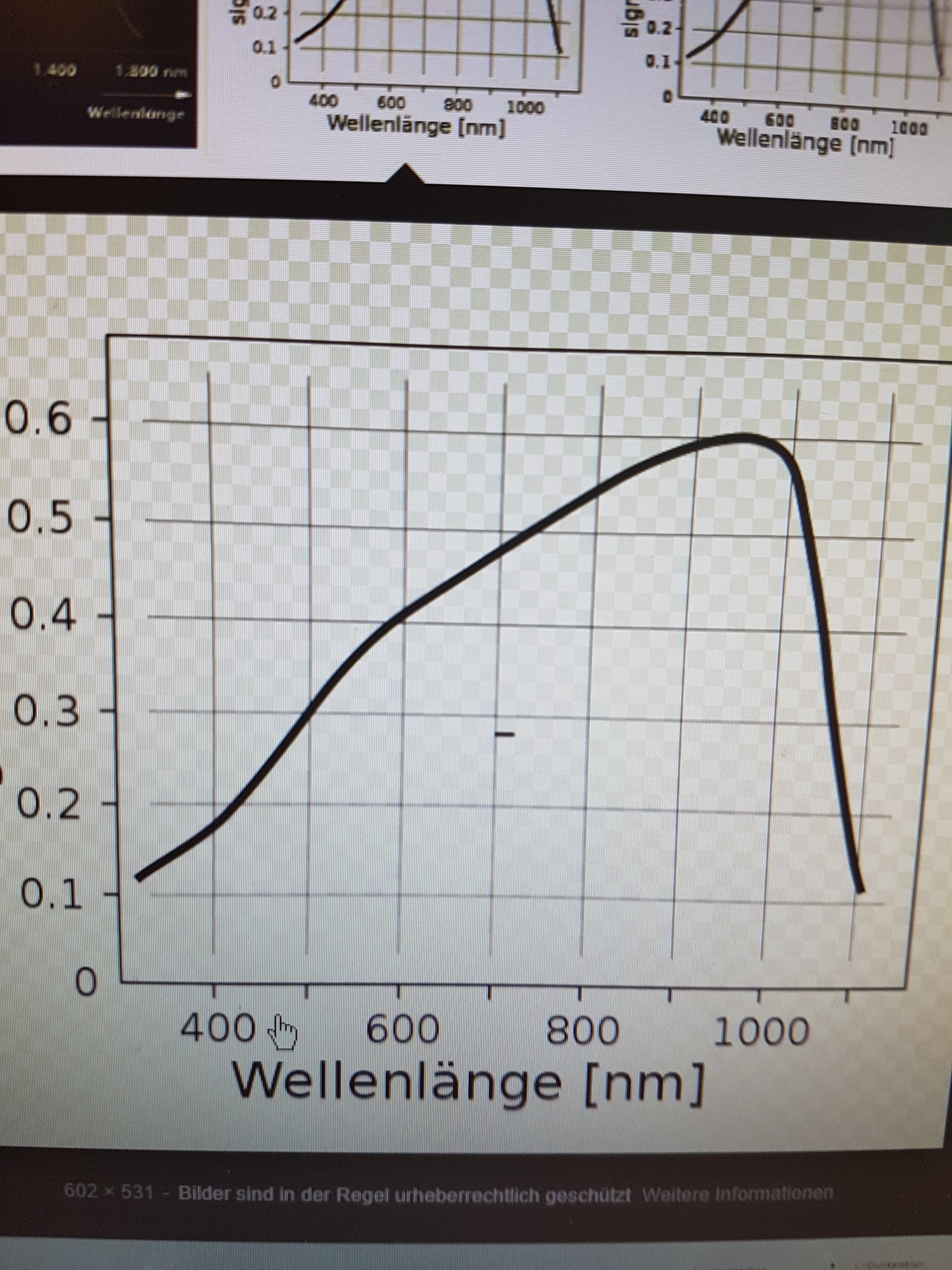

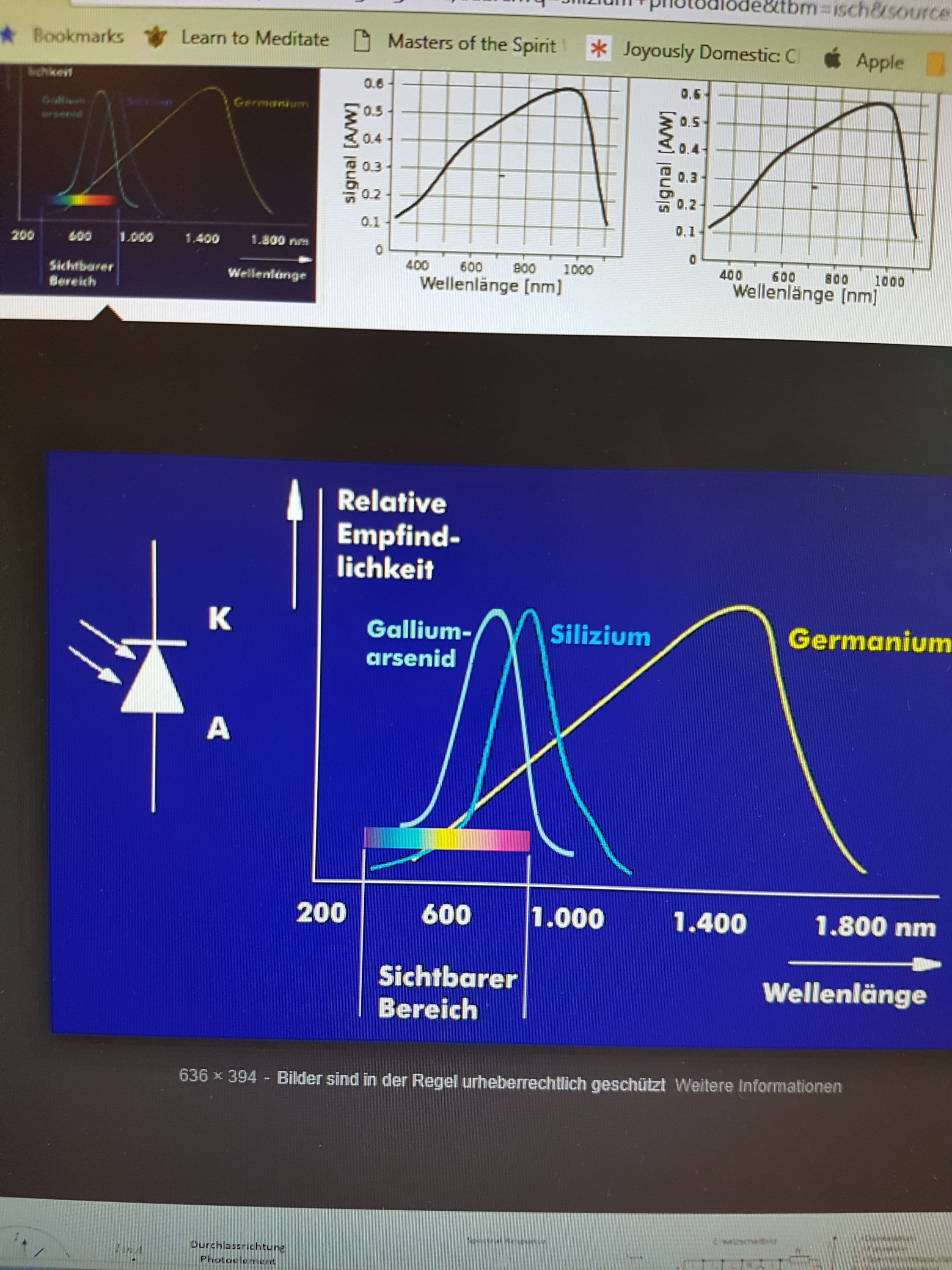

The m7 has a silizium photodiode (I'm guessing that is silicone). The sensitivity seems to be around 60%more sensitive to ingrared than visible. I found this by giggling silizium photodiode. The m7 has a 13% selective metering circle. It could be that the white paint is very ir reflective, so the sensor calculates the amount of light to be too high.
