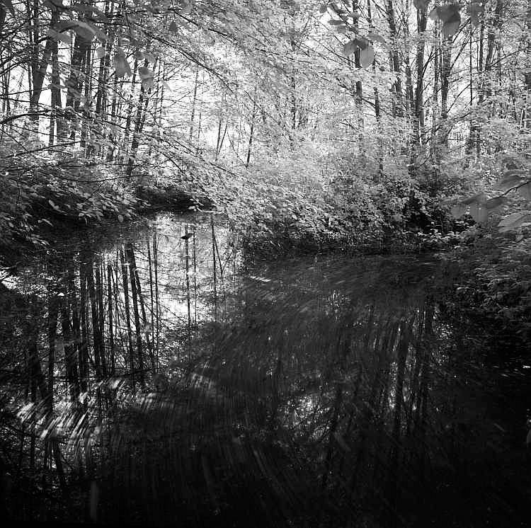

Starting bracketing around iso 12 is a good starting point for this iso 400 Rollei IR film. Indeed the result is depending on the amount IR light in the atmosphere which you can normally not measure with a meter.
But your compensation for this filter should be around 5 f stops.
Here an example made with the Yashica Mat 124-G with bay I Heliopan RG715nm filter. The Hoya 72R is 720nm.
