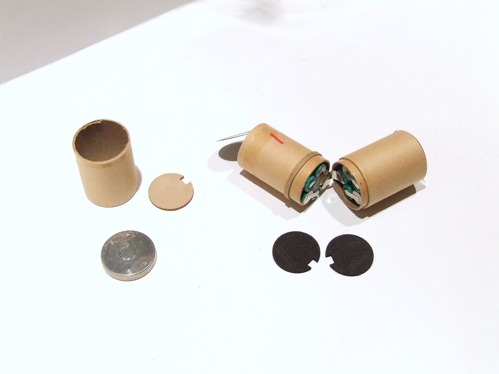

I noticed that two 35mm plastic film canister holders are the exact correct dimensions of the original battery. The two groups of 5 radially oriented batteries fit perfectly in the film canister. I just cut a slit on each end and had the metal strip come out each end and put some insulation between the two 5-battery assemblies and then taped the two canisters together so the closed ends were on the top and bottom. I put red tape on the POSITIVE terminal end. It turns out that after some coaxing with repeated charge-discharge cycles I was able to recover the NiMH cells and get them to hold a full charge again. That is good because they were less than a year old. I'll just have to remember to never leave the flash in the 'on' position to avoid the complete battery drain that inadvertently happened.

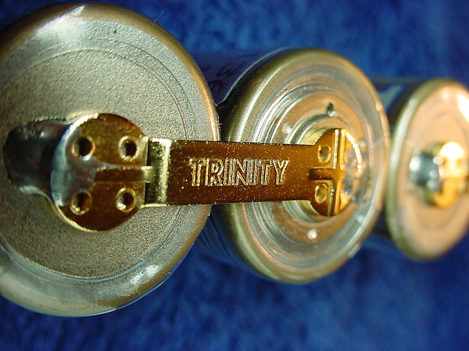

Soldering to the ends of batteries is, in general, a bad idea: the contacts are usually nickle plated which can't be soldered reliably with standard electronic solder; the thermal mass of the battery makes it hard to get the contacts hot enough for a reliable joint; the heat can damage the battery internals. Soldering to a lithium battery is a very bad idea.
Tabbed batteries have thin solderable metal strips spot welded to the battery contacts and are meant for making battery packs. There is usually a small charge for the cost of welding the tabs. Most battery vendors - see above for Digikey - will make up battery assemblies by welding the strips between the battery terminals, often at no charge above the price of tabbed cells. I haven't had Digikey make up a geometrically complex pack - like a pentagon - but emailing them a sketch or photograph might get results.

Tabbed batteries, designed for soldering, are easily available and are easy to use with no special technique needed. There is no reason for not doing a battery replacement in a reliable and safe manner.
In this case of a pentagonal orientation. The solder tabs don't line up from one battery to the next. In fact the Sanyo AAA batteries I used for the second pack DID have solder tabs but I took them all off. They were not in the correct orientation and they were pretty flimsy. I made new connectors out of thicker brass, since this is a high output battery pack.

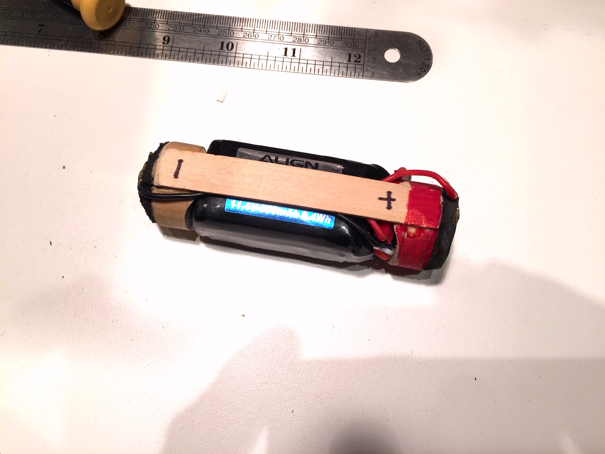

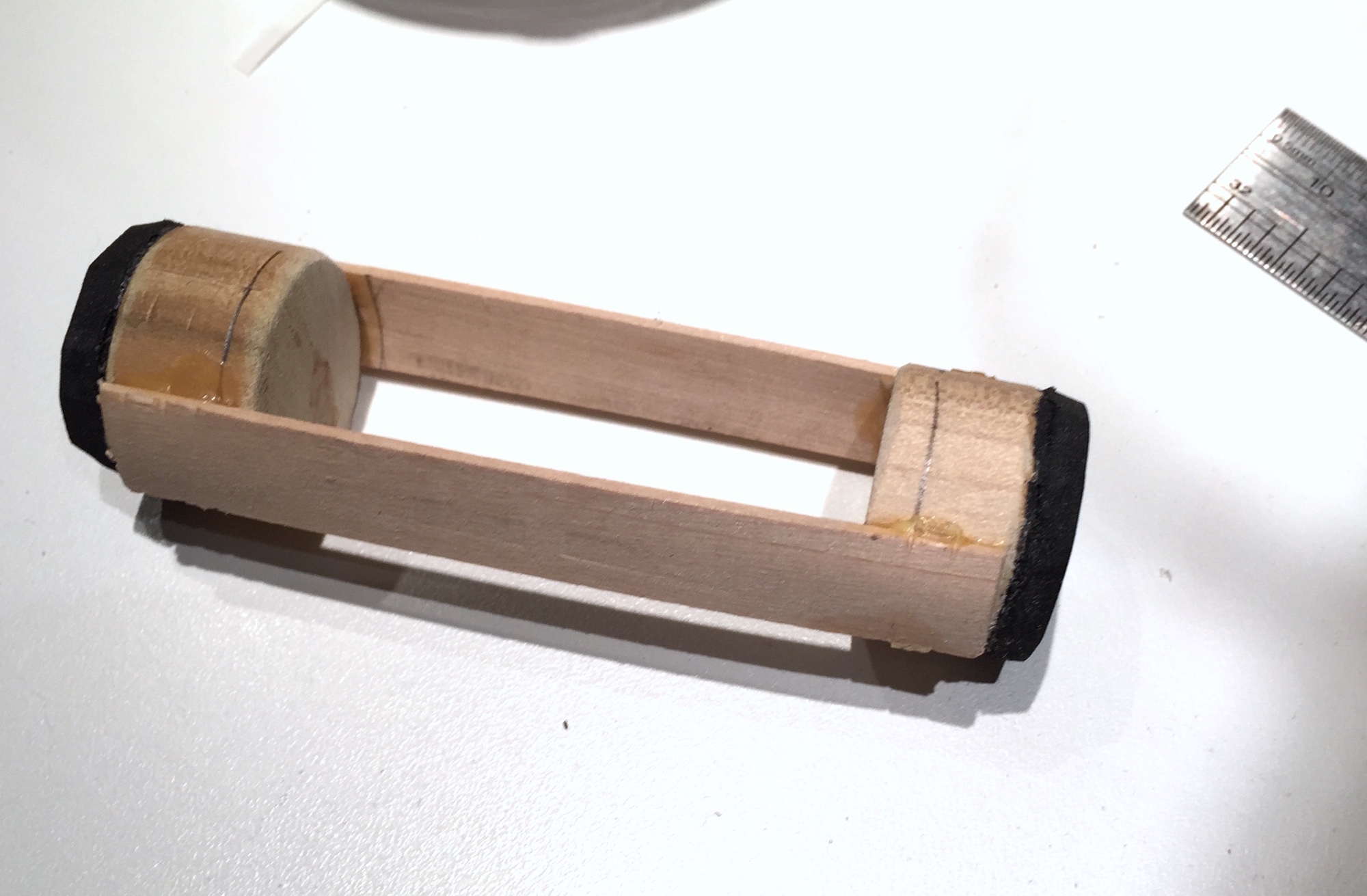

Pictures to follow. I made a spacer with an electrode to contact the existing spring in the unit. There is a wire from the electrode contact that goes to one terminal of a JST connector. The positive side of the JST connector is soldered to the area where the end cap makes contact.
The LiPo battery is plugged into the JST connector and placed in the handle. The end cap keeps the battery in place but has no electrical connection (unlike the original battery).
The balance jack of the battery is not connected to anything. It is used only for charging out side of the flash.

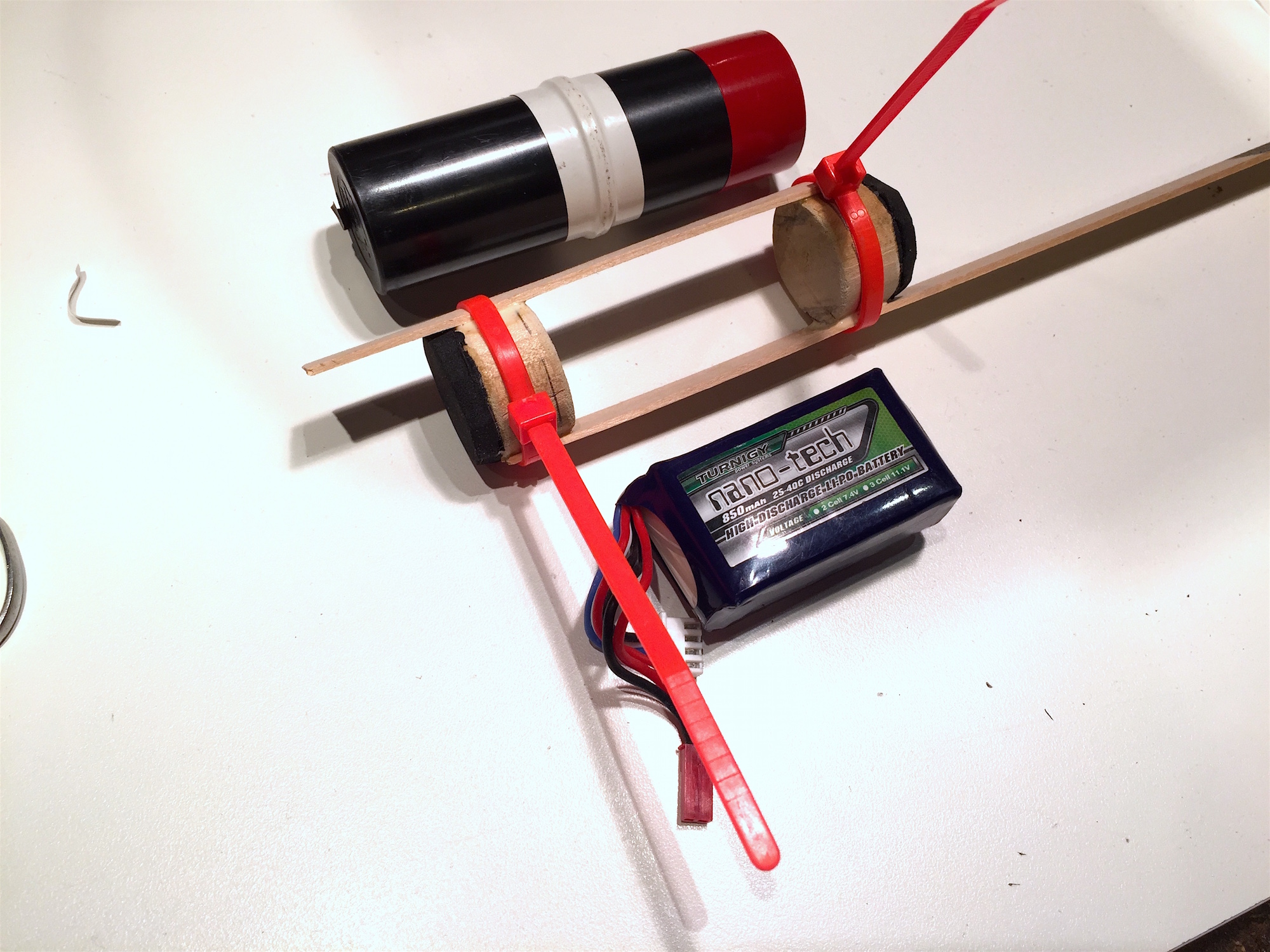

Components for the project. Top is the old battery to gauge the size. Middle is the adapter under construciton. Wood is good because it is non-conductive. Below is a 850mAh 3cell (12.6v) LiPo.
The battery plugs into the adapter with the red connector. The battery is un-plugged from the adapter for charging. No over-discharge protection here, so be careful. However, if the battery gets trashed from over-discharge, a new one is only $8 USD
The battery plugs into the adapter with the red connector. The battery is un-plugged from the adapter for charging. No over-discharge protection here, so be careful. However, if the battery gets trashed from over-discharge, a new one is only $8 USDView attachment 191457
